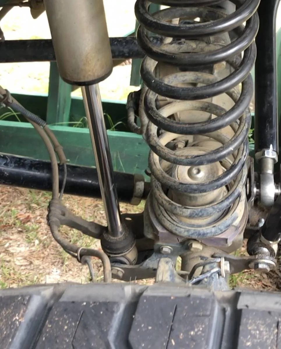

I have MC GameChanger and just lengthened the lowers. I zip tied wires to spring perch, IIRC.

I recently installed a MC GC3.5 on my wife's JLUR with 37's. While I had it apart I added the Synergy sector shaft brace (her's has already had the steering box swapped). It certainly firms up the feel from behind the wheel.
As for the lower links, I think you'll be fine but like someone else noted, check your pinion angle along with the caster. After the install I had it aligned, my caster is 5.8 degrees on one side and 5.6 degrees on the other. No twitchy steering or tank slappers with it setup that way. It's a two finger on the wheel kind of ride when it comes to hitting bumps on the pavement. I think you'll be very pleased with the outcome once you get it all installed. I think I zip tied the brake lines to the lower shock mount like someone else said (I have a set of the teraflex brackets to put on once I get some time to tinker).
