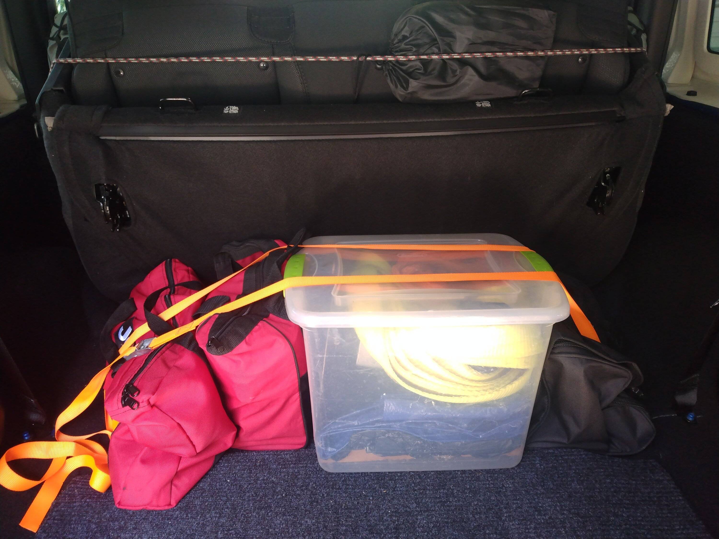

I'm gonna fix you right up buddy!
I carry a 3-ton, 21" tall, wide base jack in the small plastic tote. The small Walmart bottle jack fits in the JL storage compartment along with my factory scissor jack. Plus, I carry an air compressor, tire plug kit, 4-way multi lug wrench, breaker bar, deep well socket, a can of hair spray and a cigarette lighter. This way you'll have every tire covered.
Amazon.com: Powerbuilt 3 Ton, Bottle Jack and Jack Stands in One, 6000 Pound All-in-One Car Lift, Heavy Duty Vehicle Unijack, 640912 : Automotive
Hyper Tough 2 Ton Bottle Jack Welded Type - T90203W. - Walmart.com
You're welcome ?
