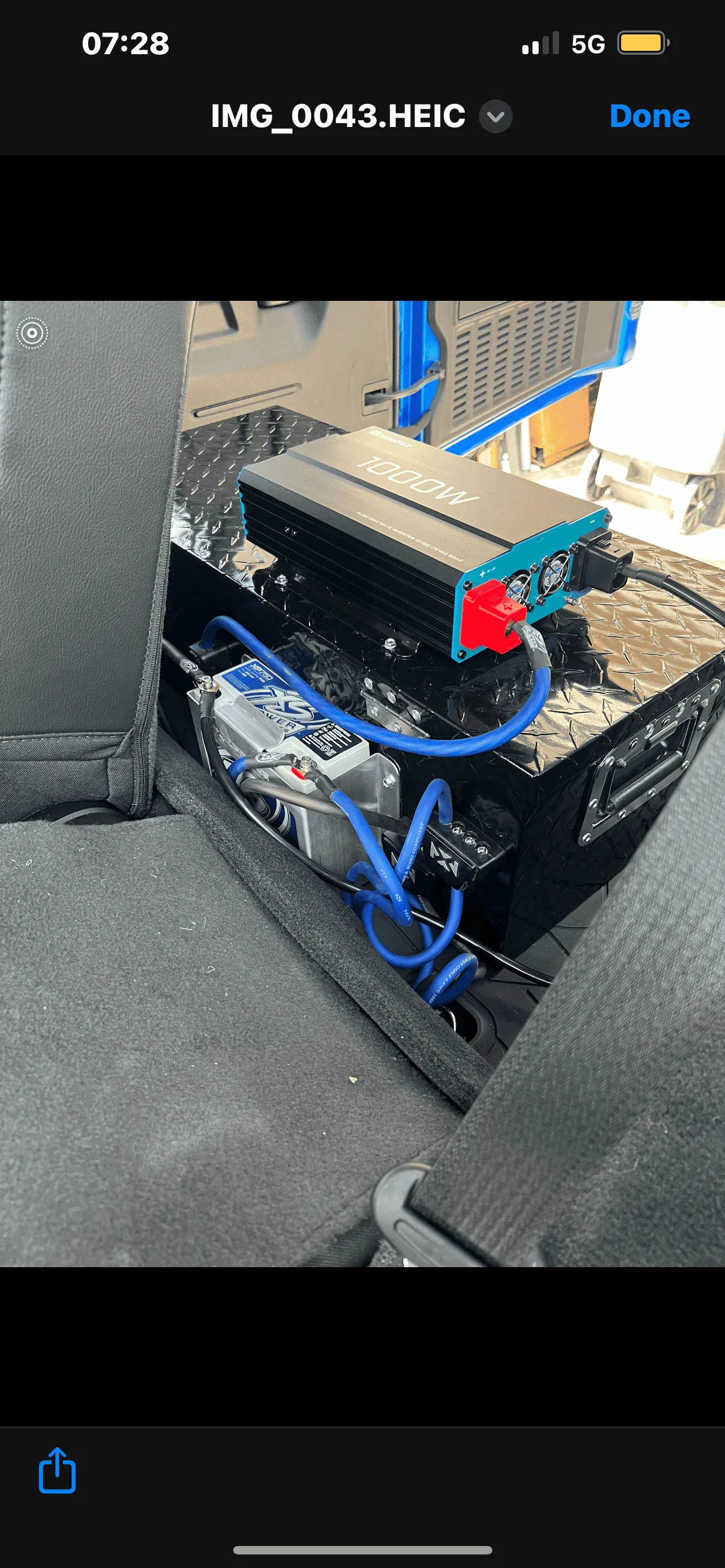

Yes, Brandon Haneline showed this in one of his videos. I installed a 1000 watt inverter and a extra battery in my 4xe. I’ve had the setup installed for a year now with no issues. Here are links to everything I used and a pic before I cleaned up the wiring. This was just a test to make sure everything worked.
Renogy 1000W Pure Sine Wave Inverter 12V DC to 120V AC Converter for Home, RV, Truck, Off-Grid Solar Power 110V with Built-in 5V/2.1A USB Port, Hardwire Remote Controller https://a.co/d/deIEBwV
XS Power XP750-CK XP FLEX 4 AWG 1000W - 1500W Install Kit and XP750 Battery Combo (with 511 Mount) https://a.co/d/8lUK38n

Thanks! Looking at your links, you're up to $353 in material. I assume you spent another couple hundred or more on a battery? So $550+ total, plus time to install? If I knew what I was doing, I could do the same. But I don't know what I'm doing, so I'd have to dive into learning it. The Jackery 1000 Plus LiFePo is on sale for $899, and it is portable, "plug and play", and multipurpose. And I could add packs down the road to double capacity.
I'm just trying to justify to myself to buy it. But I'm not sure if the charge time from the 12v is practical.
