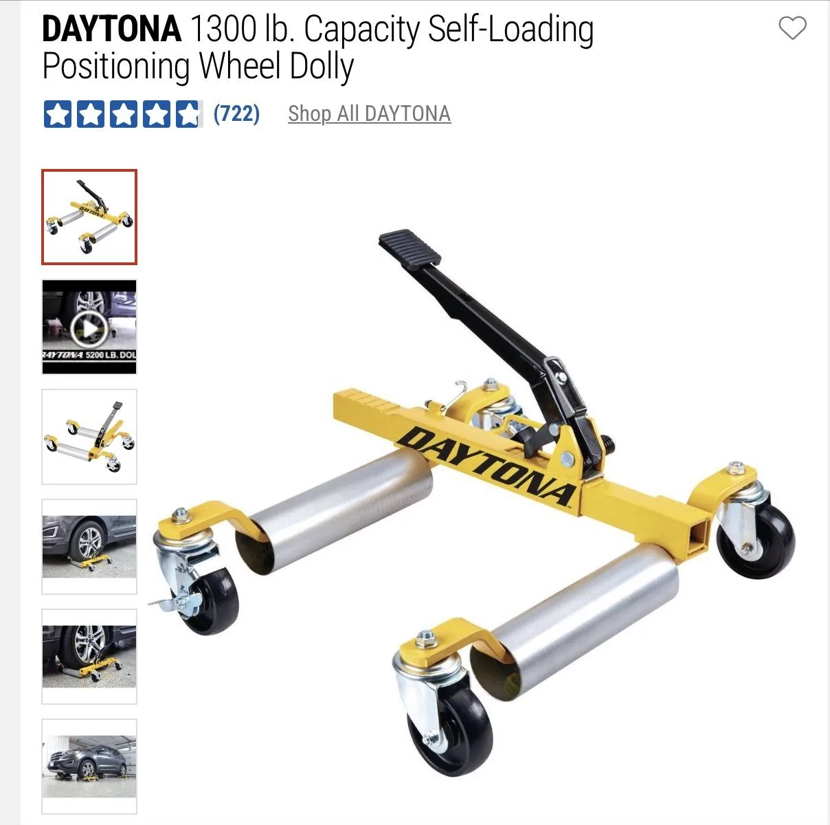

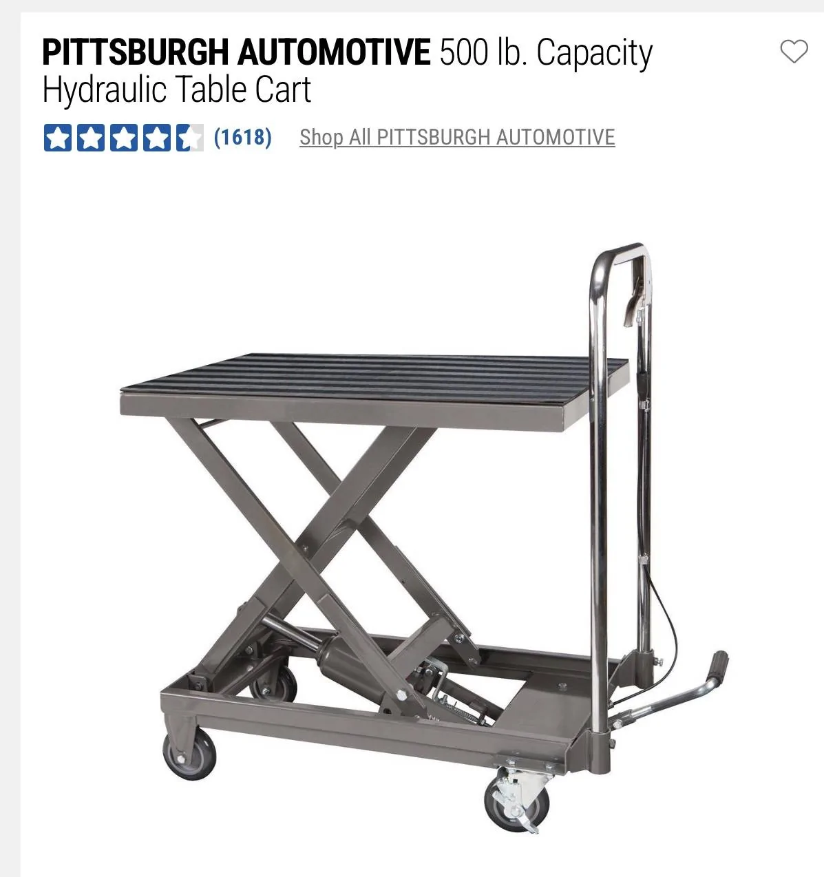

In the garage I use a hydraulic table to raise and lower the spare and a wheel dolly to move the wheels. The wheel dolly lets you align the wheel with the studs easily. On the trail well…I’ll just suffer the following day.
Jeep Wrangler JL Jack Stands being safe IMG_1015
Jeep Wrangler JL Jack Stands being safe IMG_1014
