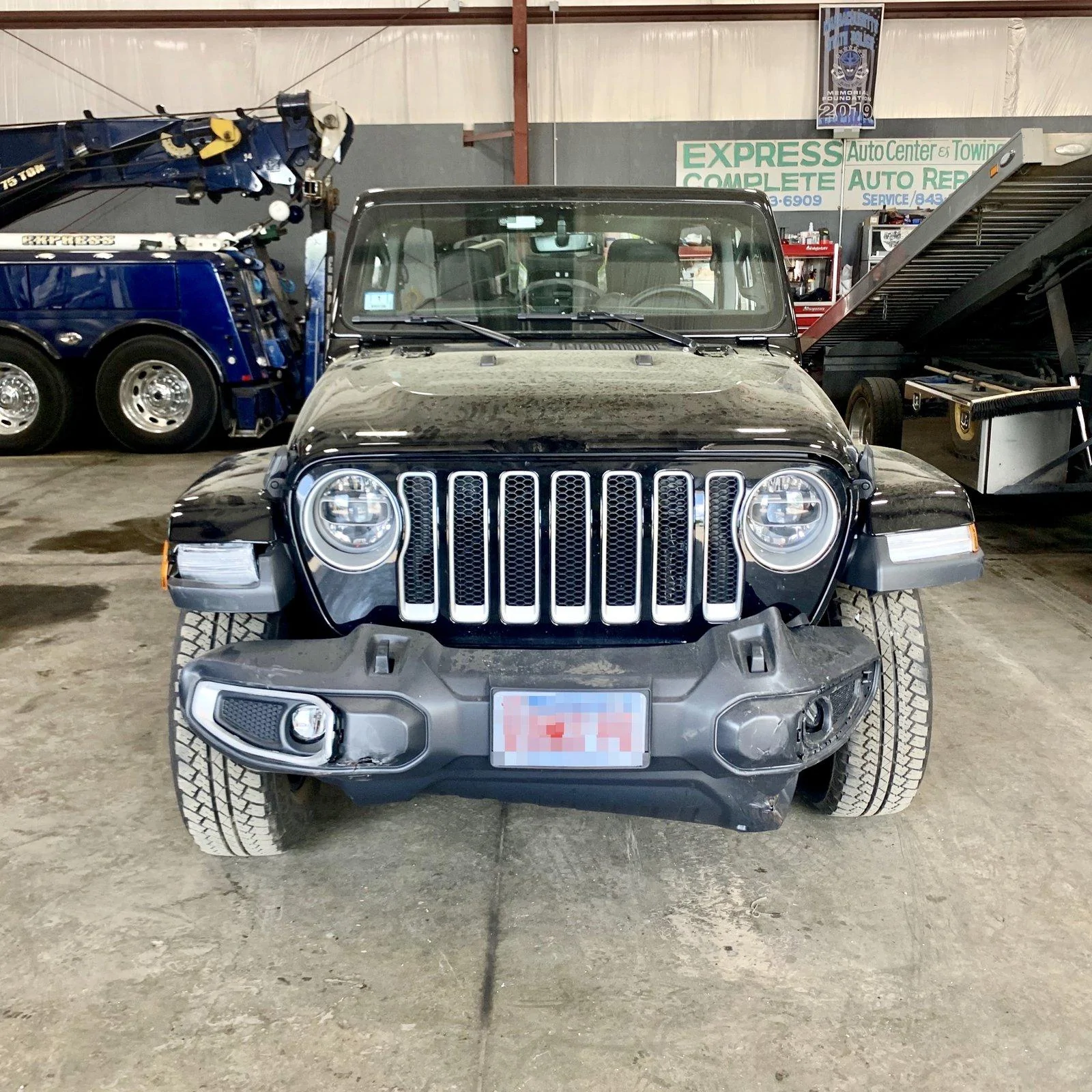

There is a chance that it will be a write off with air bag deployment and I guess a somewhat of a chance of a bent frame. My jeep had a similar accident but was hit harder with more apparent damage. On mine It was obvious to see the frame ends bent that hold up the bumper, what was not obvious was the front third of the frame was slightly tweaked sideways and we could not see it until we pulled the body off. That's all easily measured by a collision shop without pulling anything apart so you'll know pretty quickly I suspect. I repaired my own jeep but looking at yours it looks like:
  • Front bumper
  • Front skid plate
  • Fog lights
  • Front fenders may have broken away from from bolt (not the clips) and they don't sell any replacement parts for them at least from what I have seen. They seem to look ok in the pictures, maybe just displaced.
  • Bent frame ends (likely)
  • Bent frame (maybe)
  • Drivers side air bag (Repair calls for seatbelt and buckle (both have electronic communication with restraint system) , front impact sensors and b pillar acceleration sensors, Steering column (Built in clock spring these days so comes as one unit only...thanks FCA $$) replacement of airbag control module and reprogramming.
  • If the frame moved it will also likely move your fender support pillars above the frame which is also a structural repair
  • All of your fluid lines including the sway bar disconnect are adjacent to the impact so they are at risk
  • Front Control arms and the rest of bars underneath up front are at risk as well from a decent side on impact.
  • All the plastics inside the engine bay (battery box, air cleaners base etc are very brittle but I suspect you might be ok.
I guess have a look at the gaps around the doors and that will give at least some indication of how bad the body/frame is (probably won't see much I suspect). From what I have experienced, it's not so much the cost of the parts that determines the future of your jeep, it's labor and liability.
Either way, good to see you are ok and didn't get branded (hopefully) by the jeep logo on the airbag when it deployed. Yes, it happens.

Thanks for all of this information, it will be helpful.
My accident reminds me of this one by @Kahdir with possibly less damage, but I'm hoping for a total loss at this point. It's been one hell of a week and a half since the accident happened. Ready to be done!

Glad your doing well, but I agree with previous guys here, that driver's side wheel is seriously setback indicating axle is now "oblique" and not perpendicular to vehicule. That being said, it depends whats broken. It would actually be easy to see if we had underside or complete sideshot pictures of both sides because in these types of hit, if the axle doesn't rotate, usualy, the control arms will push back during the hit and they either break/bend the mount at the axle, or do they do it at the frame (bad...) in a sense I hope you can keep your jeep, but in the other sense I'd rather you get it totalled so you don't end up with a butchered up truck which starts to show alignement problems down the road etc, I'v been there and its a mess. Repair shops are good at changing parts that the evaluator looks at, but sometimes a tiny little part may be bent slightly and they don't notice it, but then when you drive it, it drive a bit strange and its hard to remember from before an accident because you'll spend probably a few months without your jeep at the very least. Hopefully the inssurance pays the loaner and if they do, grab the same vehicule so that you can feel the difference if they ever repair it.
Good luck! Keep us posted, and once again, Very glad your ok, in the end, thats all that matters.

Insurance / Appraiser has deemed it repairable. Initial appraisal is just over $6k. It's been a long 2 weeks, tow yard was playing games with insurance and appraiser saying that they didn't have the Jeep on 2 different occasions when they attempted to complete the appraisal. It took threatening to call the local police department and report a stolen car to have them 'find' it.
Responsible party's insurance has/had an issue an they haven't gotten me into a rental yet. With the appraisal issues on top of the injury stuff this hasn't been my priority but I hope to square it away this week.

Well, a month later and after a supplemental inspection my brand new 2020 Jeep is TOTALED. Frame was beyond repair and driveshaft was pushed into the engine, among a list of other issues. So now we play the waiting game for the insurance to write this off and begin my search for a new Jeep.
Starting Physical Therapy tonight.
