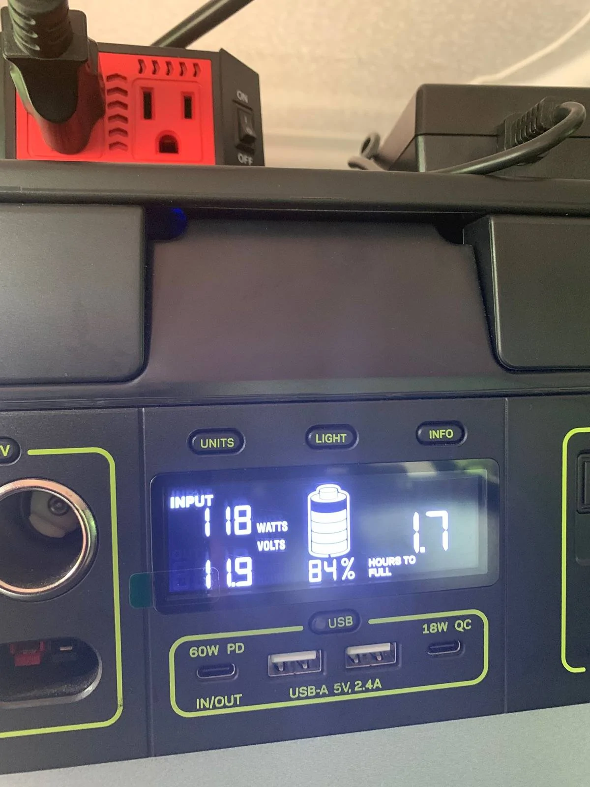

Well it worked….
Jeep Wrangler JL Inverters and Power Stations D1A074B8-7909-43B8-88BC-04A37DDBB874
It pulled 9.9 Amps through the rear 12v socket, well within spec.
However, the 12v plug and socket got pretty hot; well beyond “warm” territory. I wanted to assume that the setup was safe because the math worked out. I was trying to avoid running a new wire to the cargo area, out of laziness, and this pure sine wave inverter seemed like the perfect solution. Oh well. Back to the shitty 5 amp car charger that Goal Zero makes. Maybe if I drive cross country I can reach 50% of my capacity 🤬. Always wanted to Jeep out west.
