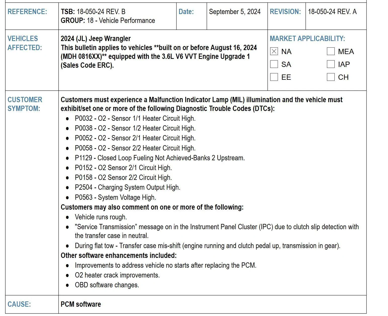

Small update after talking to the service guy. He said it did throw some codes and that the tech found a software update that he said matched the description of issues I was seeing. He couldn't tell me any more detail over the phone, so I'm hoping I can get a lot more on what the codes were and what this software update addresses specifically later today.
Pretty suspect answer in my opinion since it's so intermittent and it appears to be a rare problem.
Will update later as I get more info.

I'm not aware of any such TSB with the 3.6L. The last JL 3.6L PCM update we got was for the rampant o2 sensor failures we saw last summer. He's probably confusing the o2 run rough concern for this one.
Another update talking to them again. He didn't give me a TSB number but 99% sure the tech was referencing this TSB you posted as the fix. Mentioned the "vehicle runs rough" as the condition that led them to it.
He said there actually was not many codes, he mentioned one about a out of range battery voltage (maybe that's P0563 or P2504?).
Asked if they could hold onto it another day and check it out again tomorrow. I'm sure it will run fine when they test regardless of if its truly fixed. Not much else I think I can get them to do at this point.
Hoping that this software is somehow a fix but will probably try to do some of the trouble shooting steps listed in the previous posts on my own such as checking fuel pressure. Maybe throw a can of Sea Foam into the tank.
