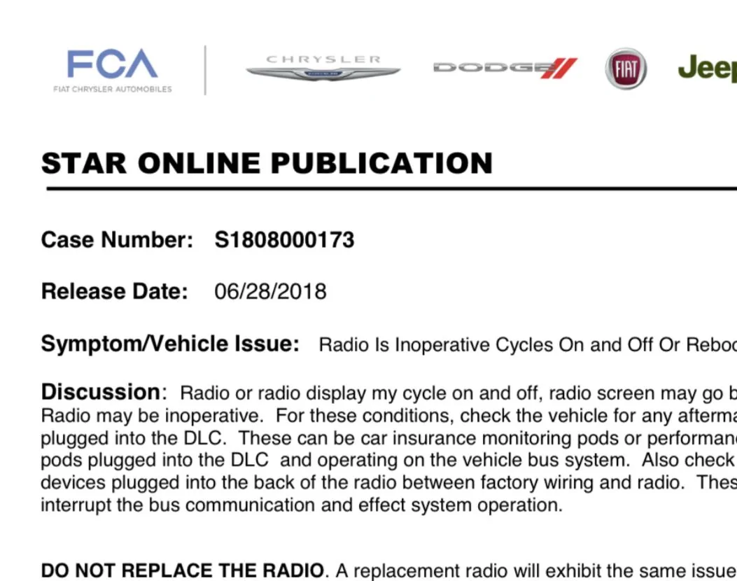

Dealership says "we aren't replacing the radio, we've got a TSB saying don't replace a fix is coming". I'm going to talk to support and see what they say @JeepCares can you comment/confirm?
It’s actually very hard to get a radio just slapped in there without a semi PITA process on everyone’s end... and YES 9 out of 10 star cases or bulletins are bold at bottom and state do NOT replace radio as it will not fix condition.
For example....
Jeep Wrangler JL Intermittent issues with Uconnect 8.4 4D26E793-D35F-43A8-950B-12041D7F7D30
For example....
Thanks, all well and good, except I've got nothing installed on the thing yet. I know you're just using this as an example, but JFC, the thing's got cellular data capabilities for OTA updates. Release patches for things. Code the device so when it crashes it dumps the system logs back up to FCA's engineers. Can't to increment patches? Time to re-write the OS os you can. Monolithic firmware updates aren't helping anyone.
