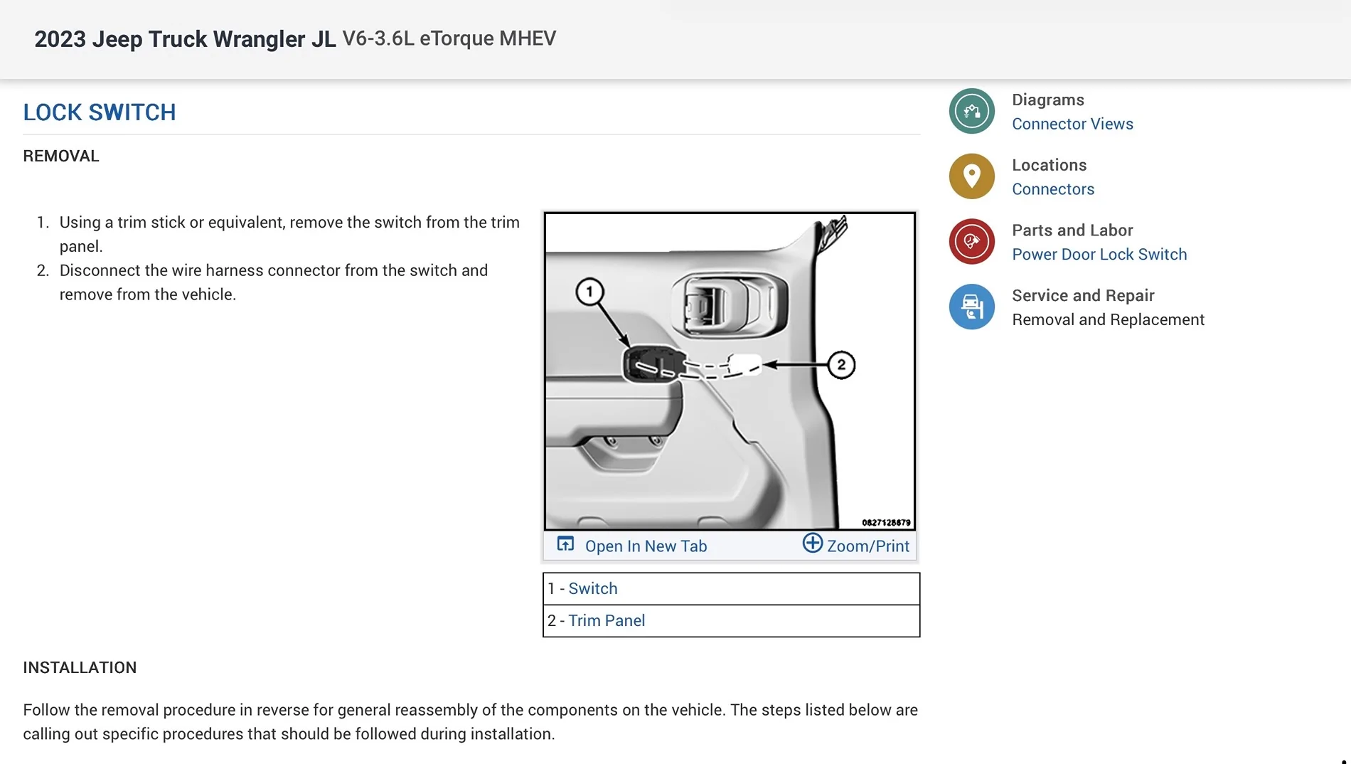

The passenger side electric door lock switch stopped working, 2020 JLURD. Looking for removal tip. Is it removed from the outside or must you remove the interior door panel...

AWSOME!!! Thanks for the help!! Removal from the outside make this a bit easier...
