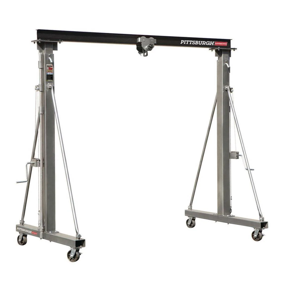

Harbor freight has these gantry cranes, I have mine setup in my backyard because neither it or my Jeep fit in the garage. I'm going to add a HF winch to it. Pull Jeep in, connect winch to battery, hoist RTT (and rack, for me) drive away until next time. Warning, this thing is a bitch to pick up from HF and set up, have a friend or two.

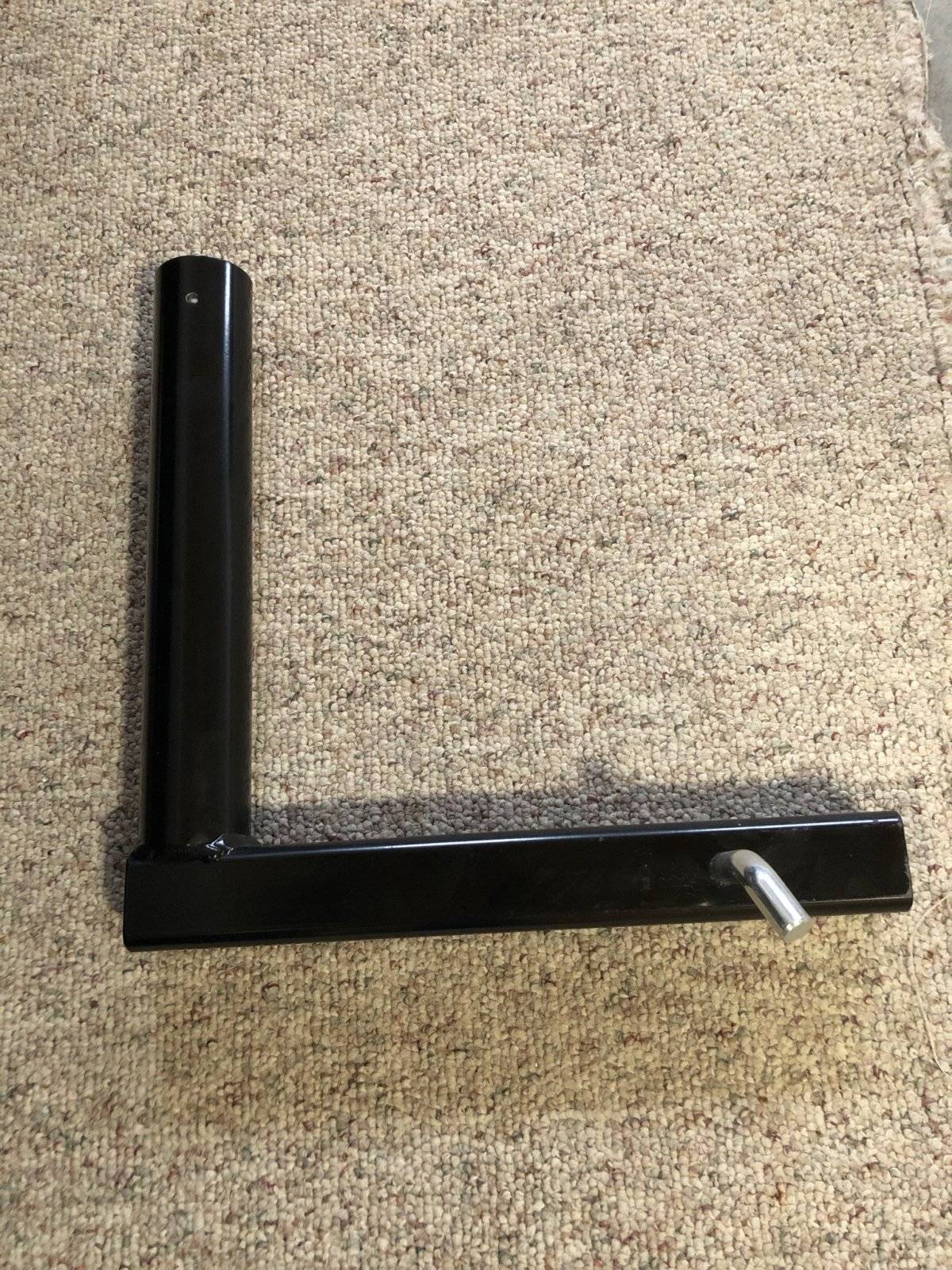

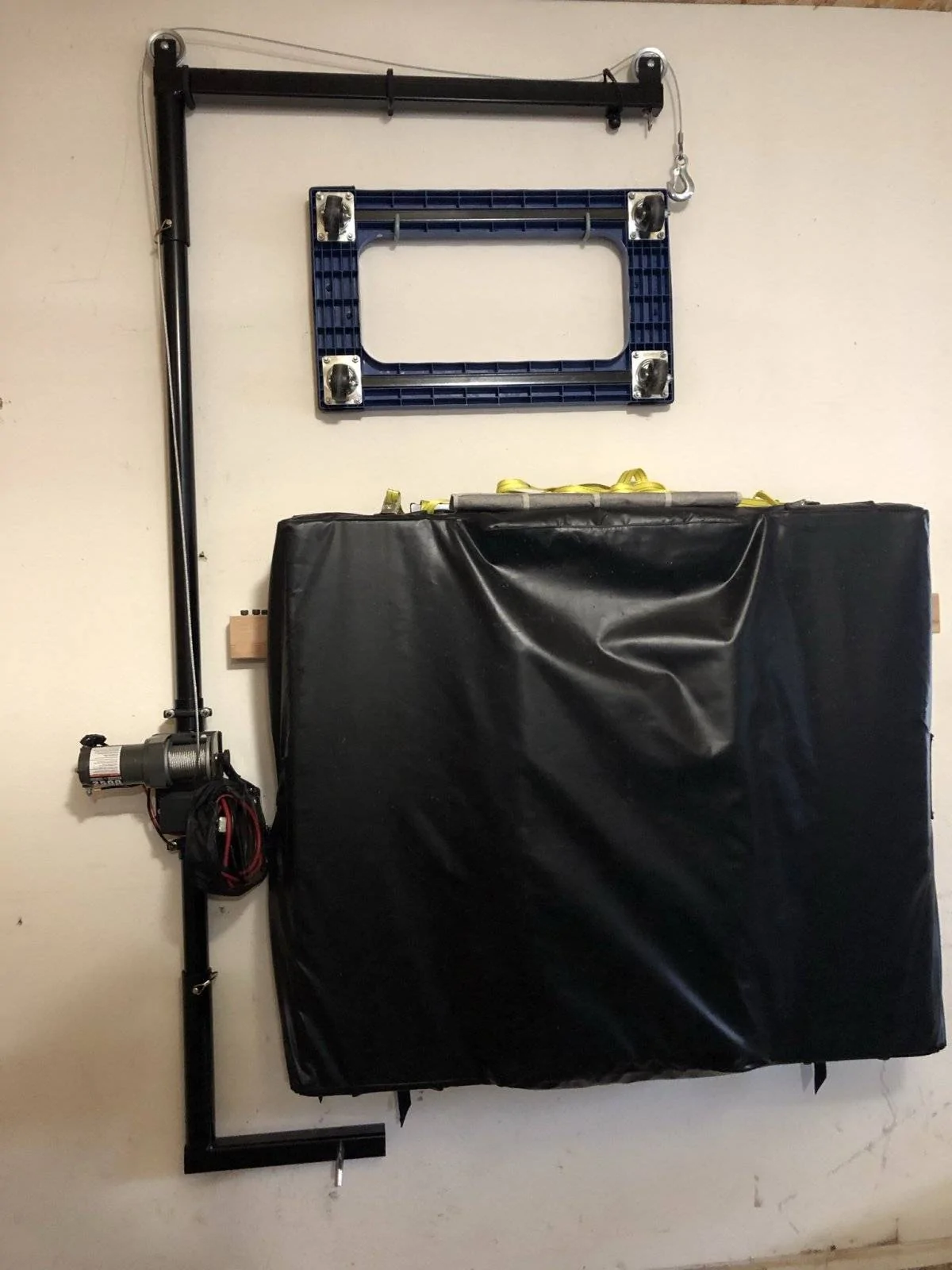

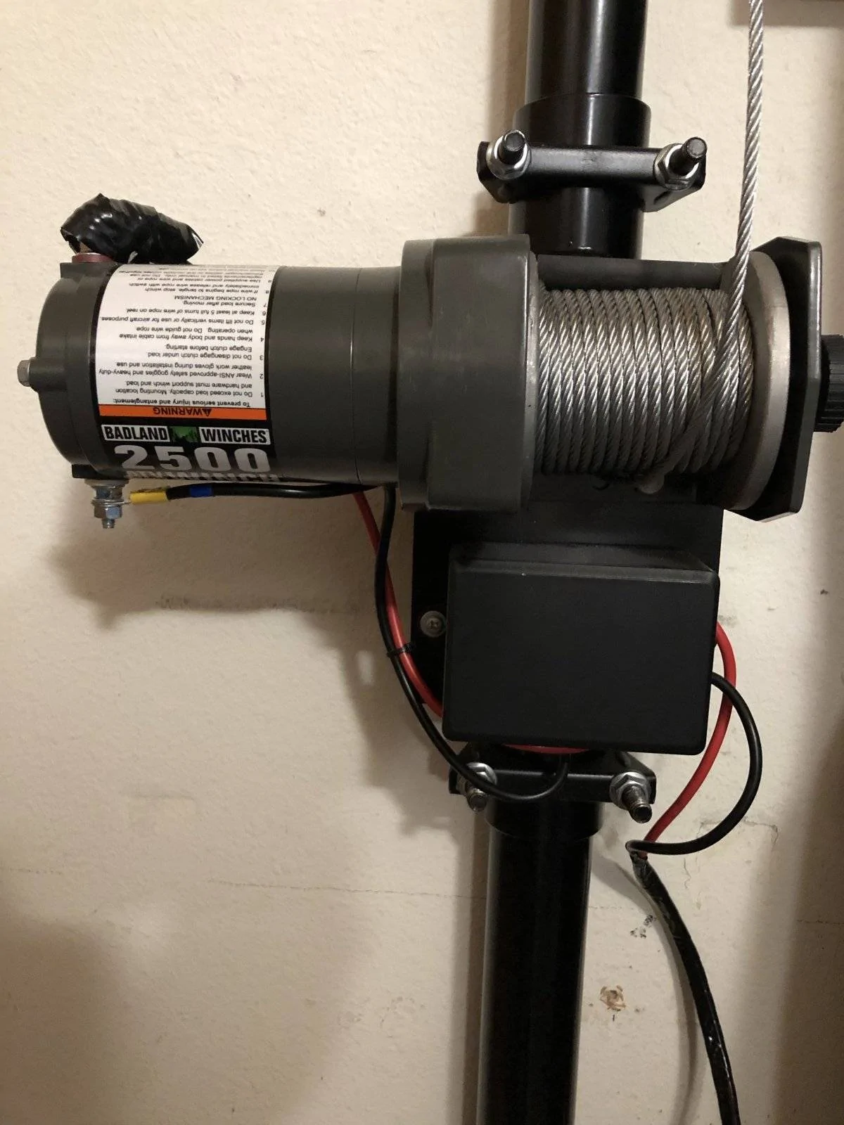

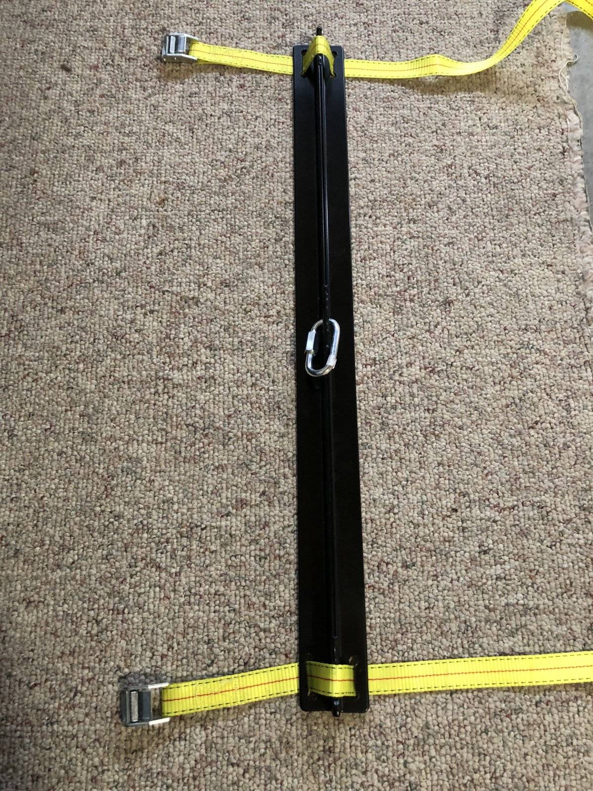

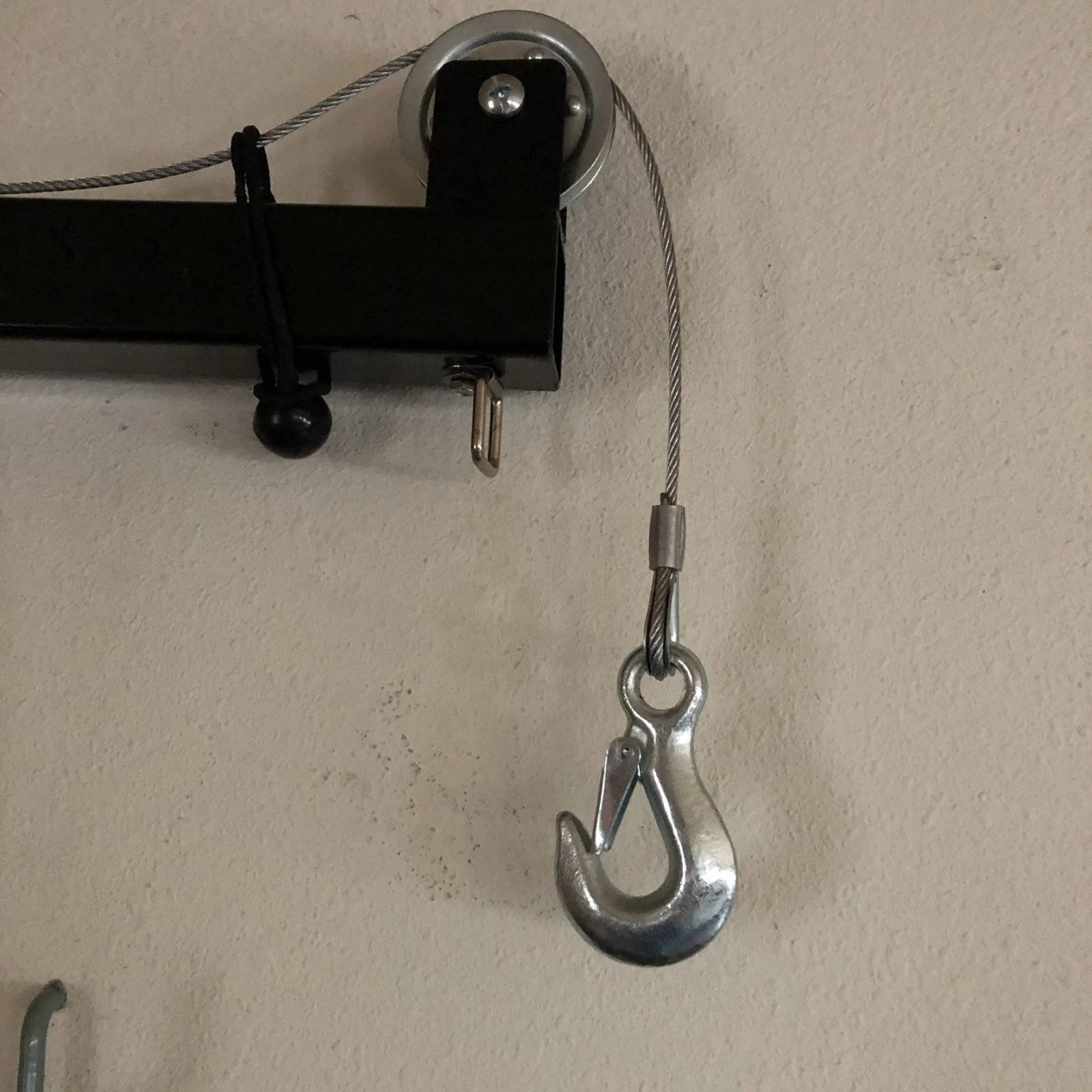

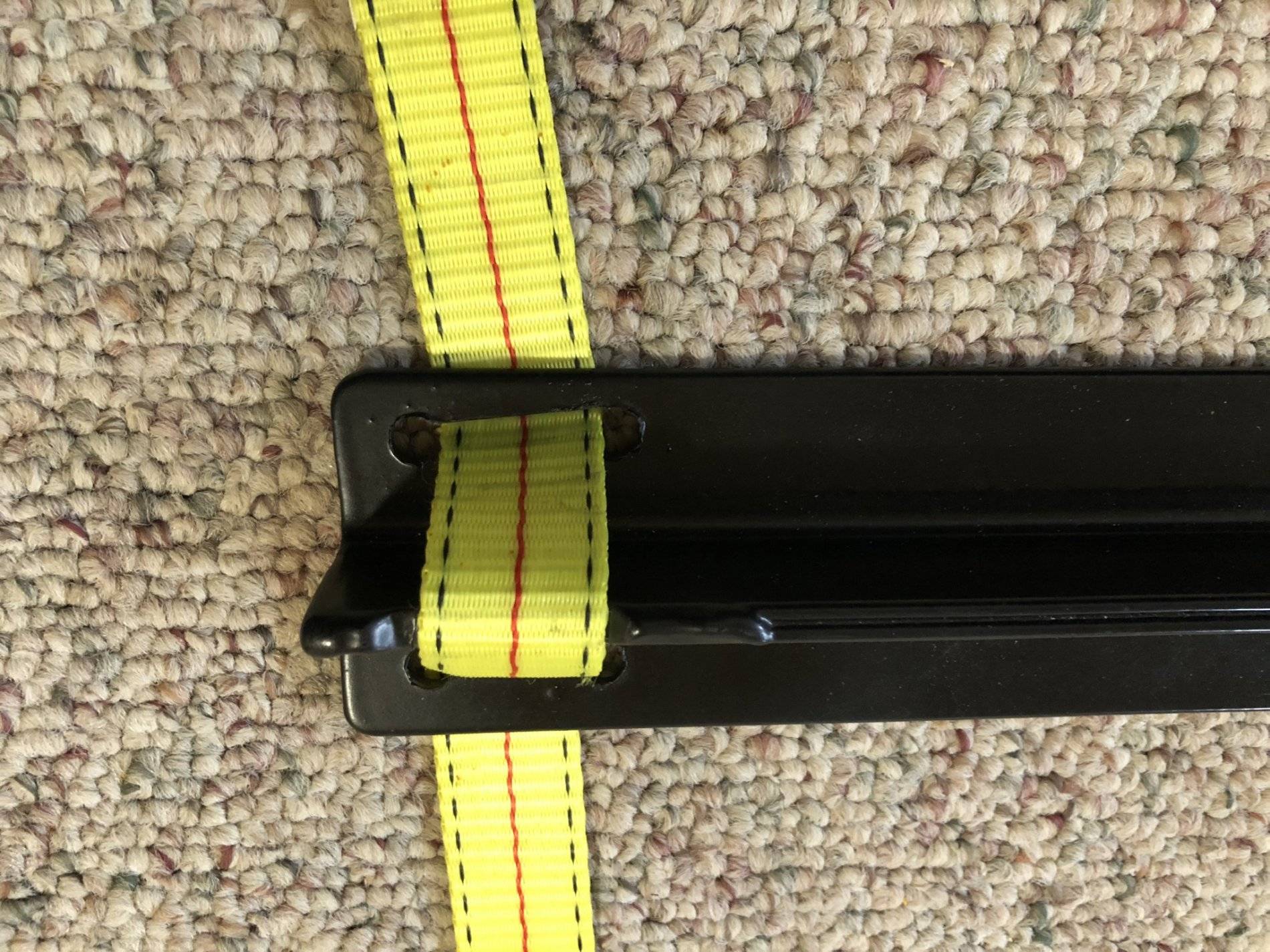

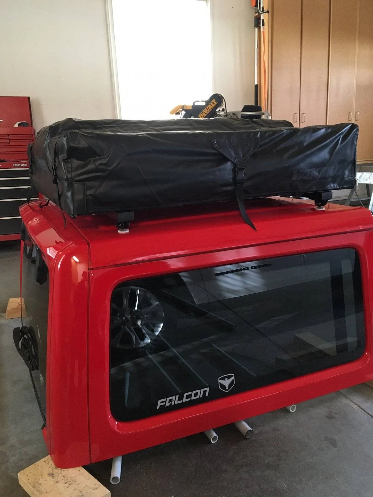

Since I didn’t document this as I made it I’ll just try to explain. First I started with the receiver (pic 1)...it is 2” square tubing with a short piece of 2 1/2” od pipe welded to it. This serves as the swivel. Inserted into this is the “heights” section which is 2” od pipe. This could be all one piece or sectioned sectioned (as I did) to be able to break it down more. On the very top is another 2” square tubing that extends far enough to reach the center of your tent. My overall height is 88” and the square tubing extends 42”. On top of that is mounted two pulleys to guide the cable from my winch. I bought a Harbor Freight winch that is remote controlled for around $49 on sale and hook it up to my battery when I use it. For the lift bar I welded two pieces of angle iron together (for strength) and then cut slots in the ends (pic 3 & 4) to run straps through for lifting...this keeps things from slipping. The 5th pic is of the whole setup along with the tent stored on the garage wall.

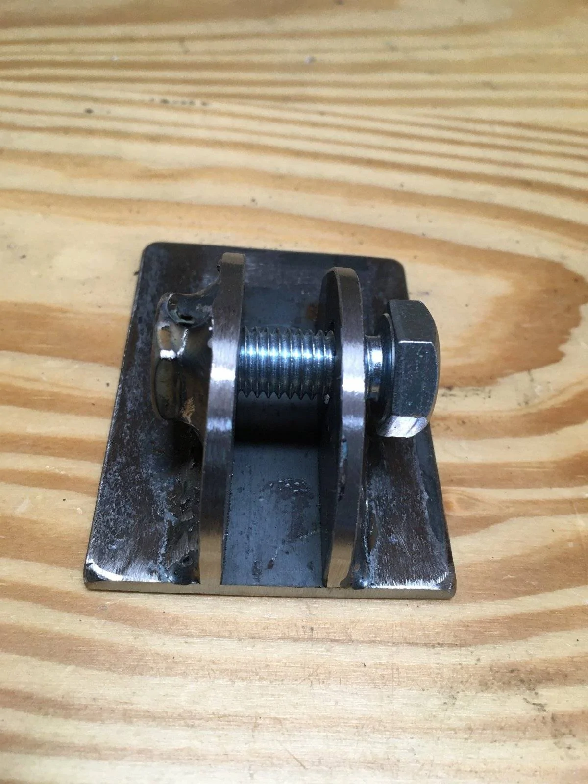

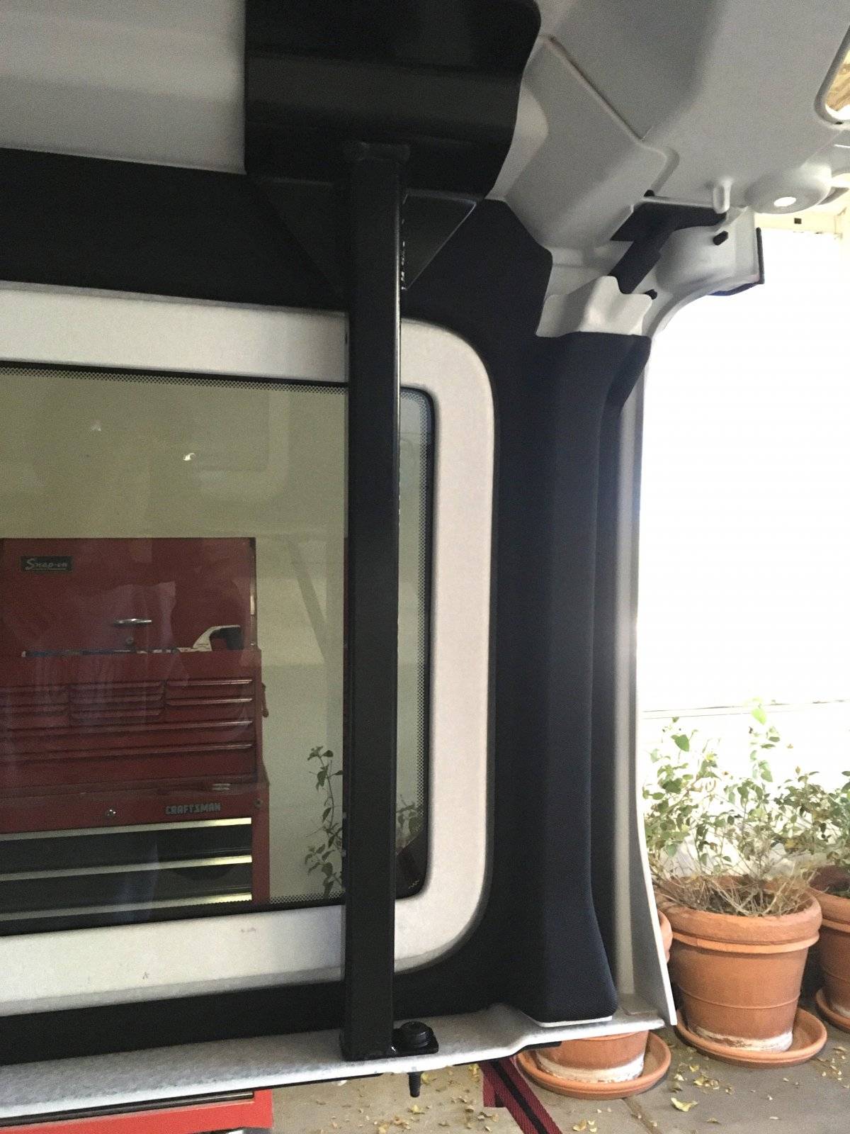

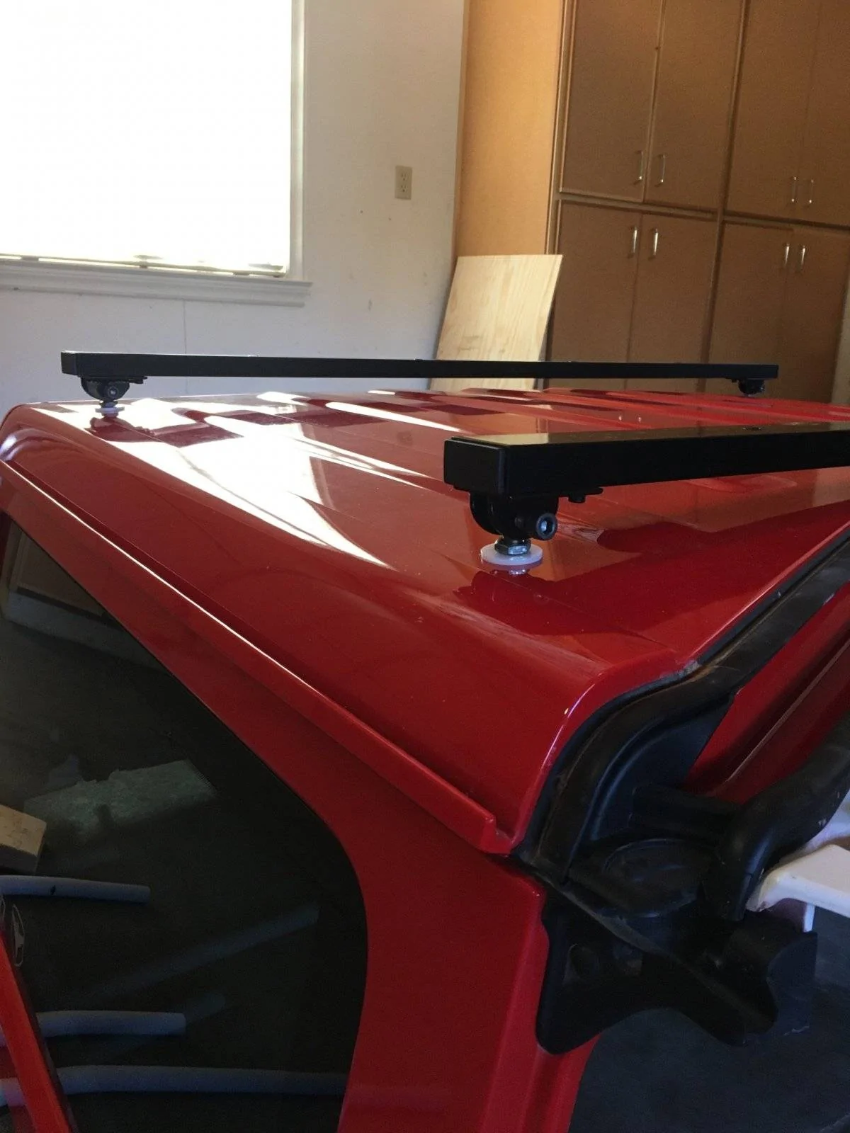

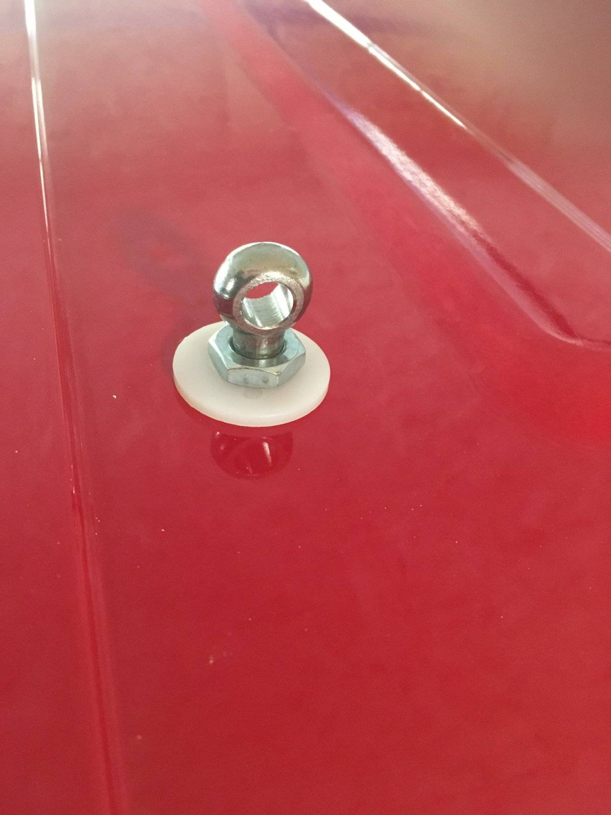

I made my own system...which transfers the weight from the top to the body of the Jeep by adding inside supports. The only thing that ”shows” is the eyelet on the top when the RTT is removed. This system allows the top to be removed by only removing the factory hold downs. The tent supports are permanently mounted to the tent and I can attach the tent by just using the four bolts that pass through the eyelets.

I'm assuming you made that bracket/support piece that sits against your hardtop yourself(in pic #1)?
