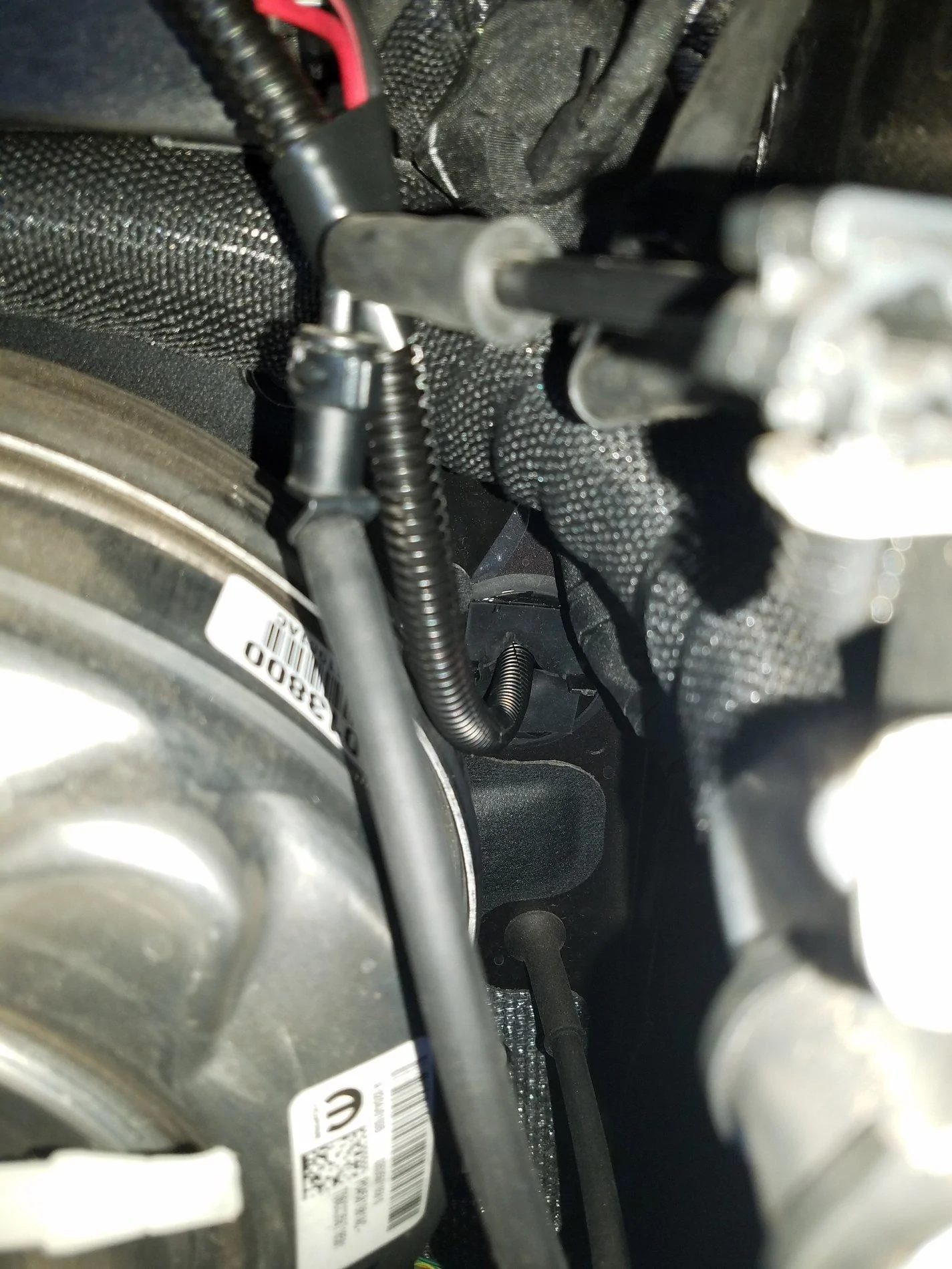

Still waiting to receive my light mount. Got everything wired up in the mean time though. I have some rigid dually floods I plan on facing at outwards angles for driving on forest trails.
I don't have the aux switch kit so I had to do all the wiring myself.

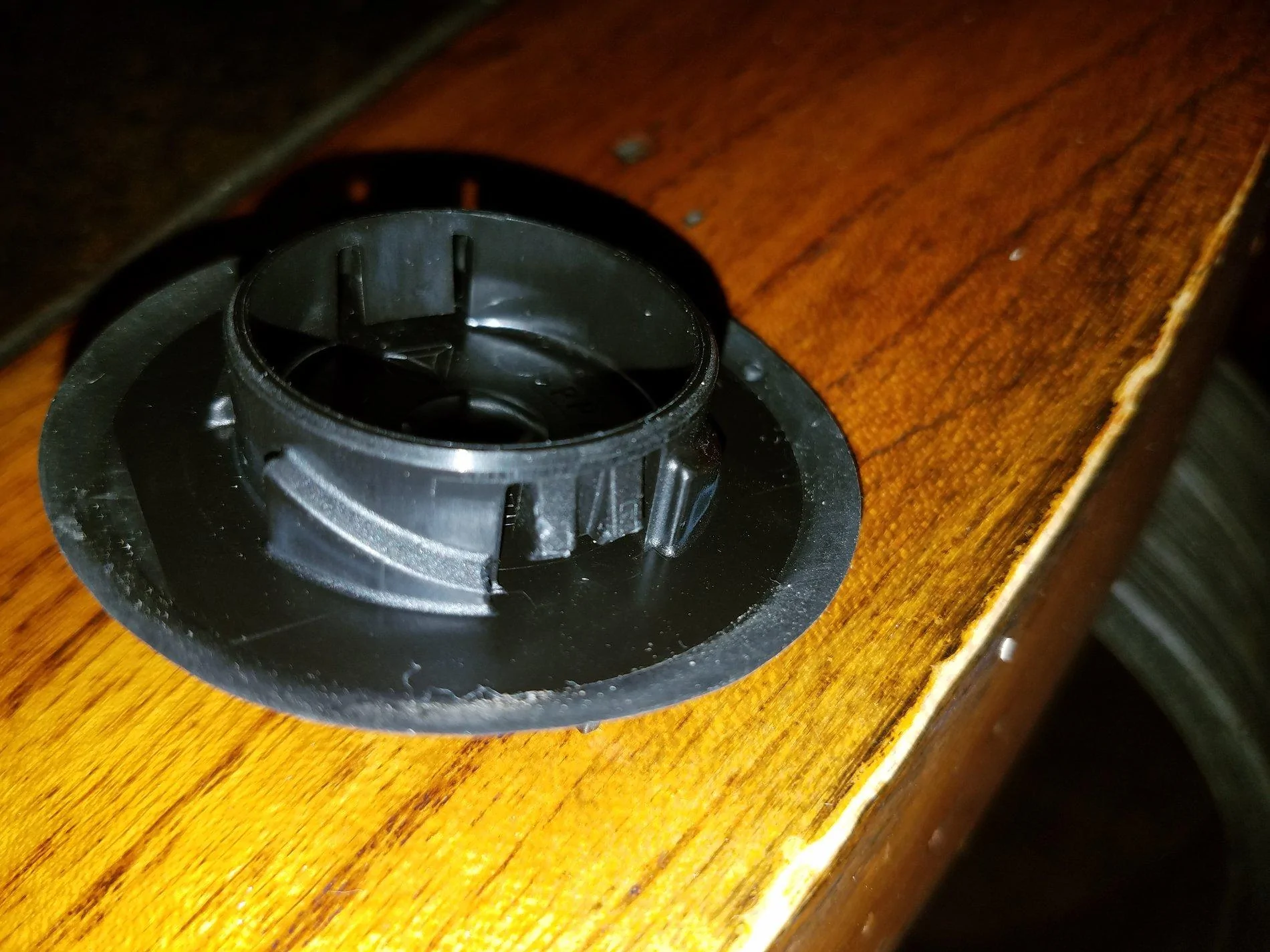

There was a plastic cap on the firewall I took off for wiring but found it was noticeably louder upon removing it. I dremelled out the middle of the cap and then used rubber sheeting with an X cut through before reinstalling. Sounds just as quiet as before now:)

Then routed it to the dashboard with a standard flip switch.
I'm happy with this setup but the wiring was very tedius. I think I'm gonna spring for the aux switches for my future lights and accessories. I did however free up an extra switch though :like:.
Seal that hole up with some silicone. Otherwise water will get in through there. It doesn’t seem like it would under the hood, but trust me it will find a way.
