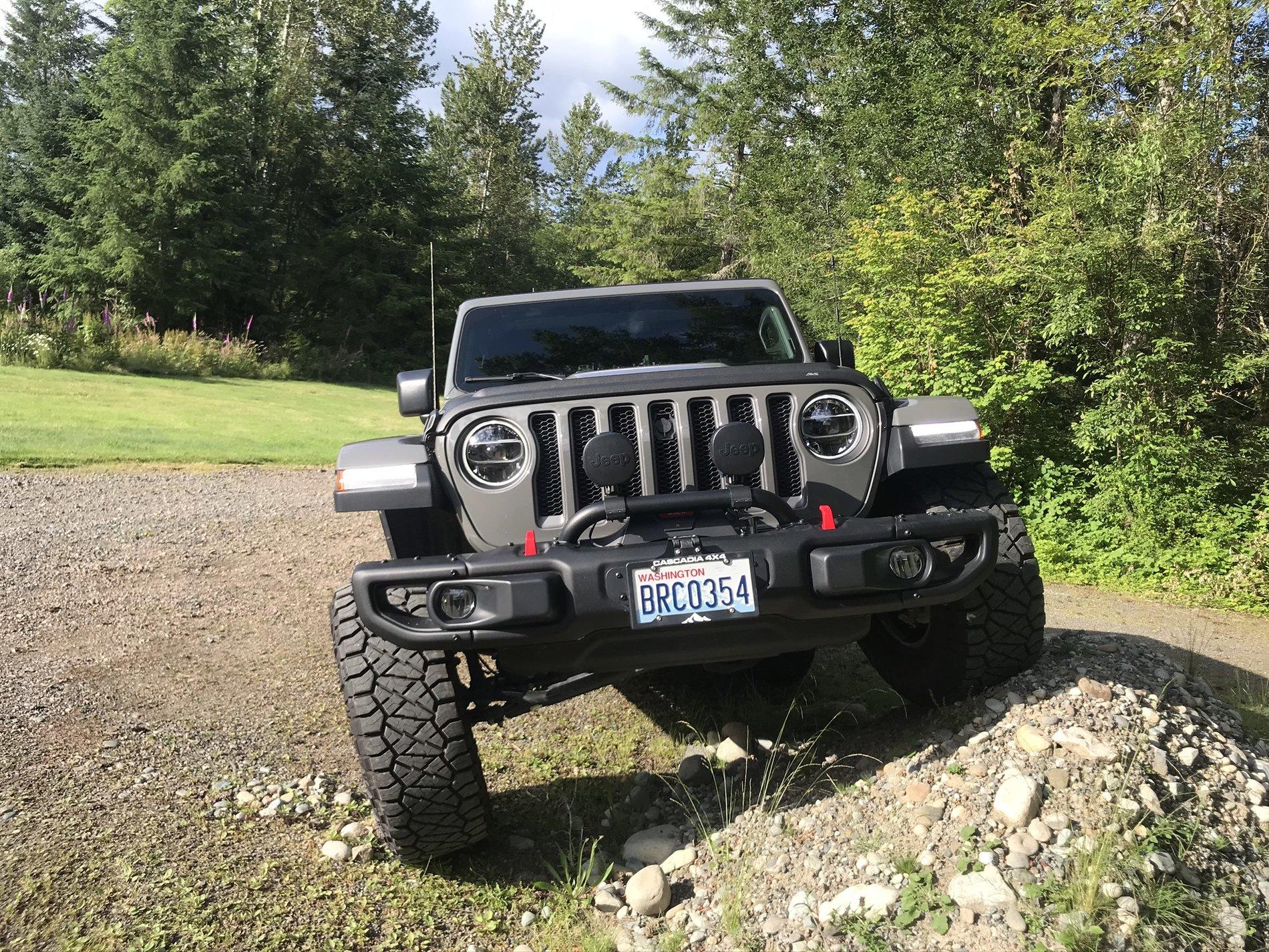

We aren't quite at 36 jeeps yet, about half that in the last 20 years or so. Have you run 37's on a factory JL rubicon? Since you threw out unrelated numbers and observations as experience in the matter, what is your basis for "don't believe the ones who tell you otherwise"? 2" budget boost and longer shocks were all we needed to run 37's and it's still quick compared to a stock jk on the street and a beast off road. With the 4.7:1 1st gear in the 8 speed, the effective 1st gear ratio is 19.27:1. A late model jk would need a 5.13 axle gear to match that. An early jk with the anemic 2.86:1 first gear would need a 6.72 axle gear, which doesn't even exist. Not everyone wants or needs 37's, but they are very much an option on a JL even on a budget. Before you say "but it won't hold 8th gear anymore", set your cruise control at 75mph+ like everyone else on the freeway around here and it holds just fine. No it won't hold 8th at 60mph. But what do I know, just have both actual 1st hand experience and math on my side...
Jeep Wrangler JL Insight needed from Rubicon owners IMG_20200829_170914_112
