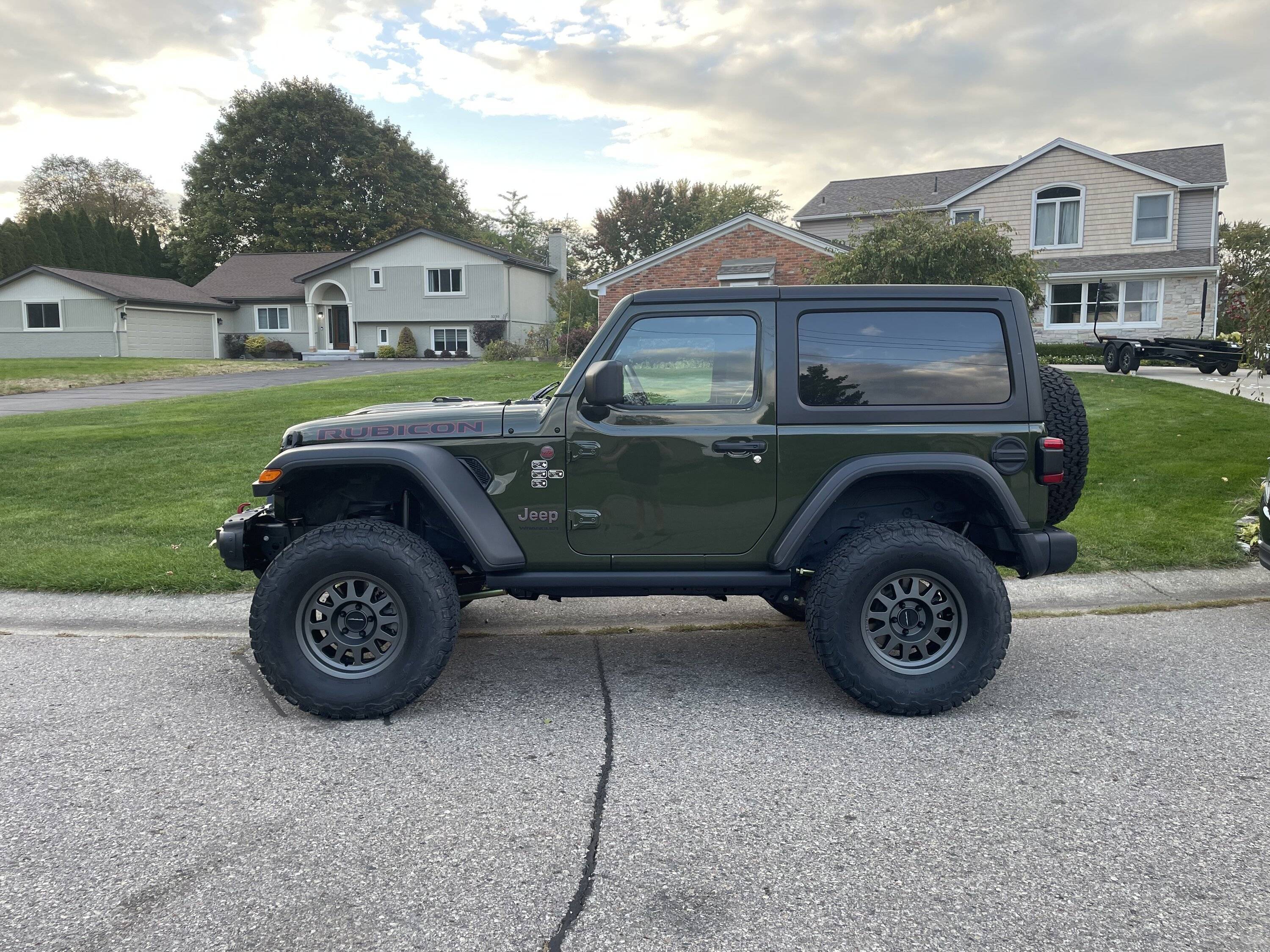

Well, here’s a pic of my Metalcloak 2.5” Gamechanger and 35’s if it helps your decision any.
I got exactly 2.5” of lift in the rear and 3” up front, but the extra up front is likely compensating for the 3/4” of sag my winch added to my stock springs.
The MC 2.5 is definitely a good look with 35s. There is also a white one on here with silver wheels and that one also looks great.
