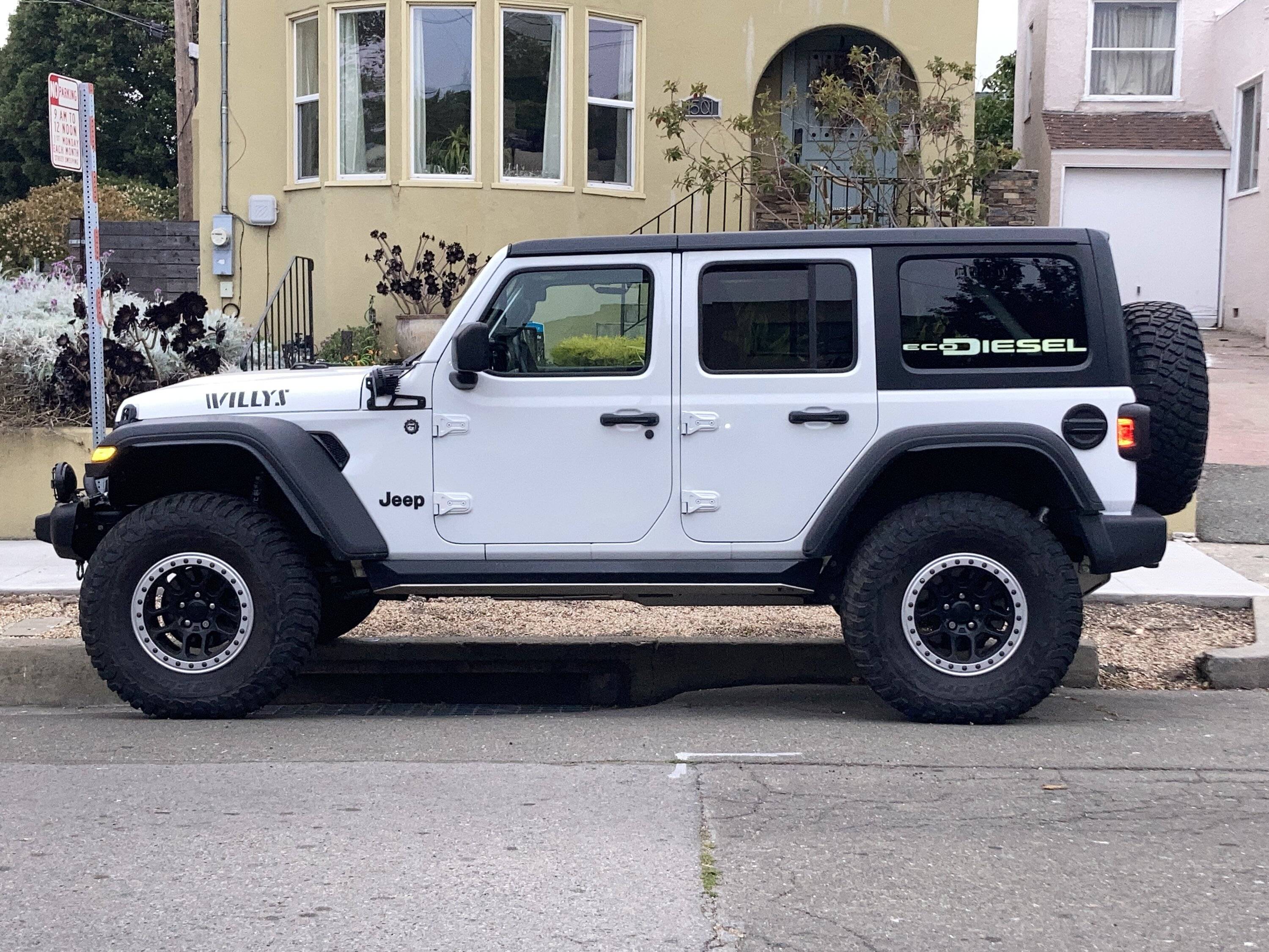

@Chrisbayridge1
wait.
there are many variations of "Mopar 2-inch lifts" and vehicles for which they are intended, and there's no telling for certain what rake angle you'll wind up with. i'd support the 'wait and see' approach.
FWIW, the "2-inch" lift on my Willys Diesel took the front up over 4" and the rear almost 3"; with the winch and bumper it sits just about like where i want it.
this is what it looked like on 35s.

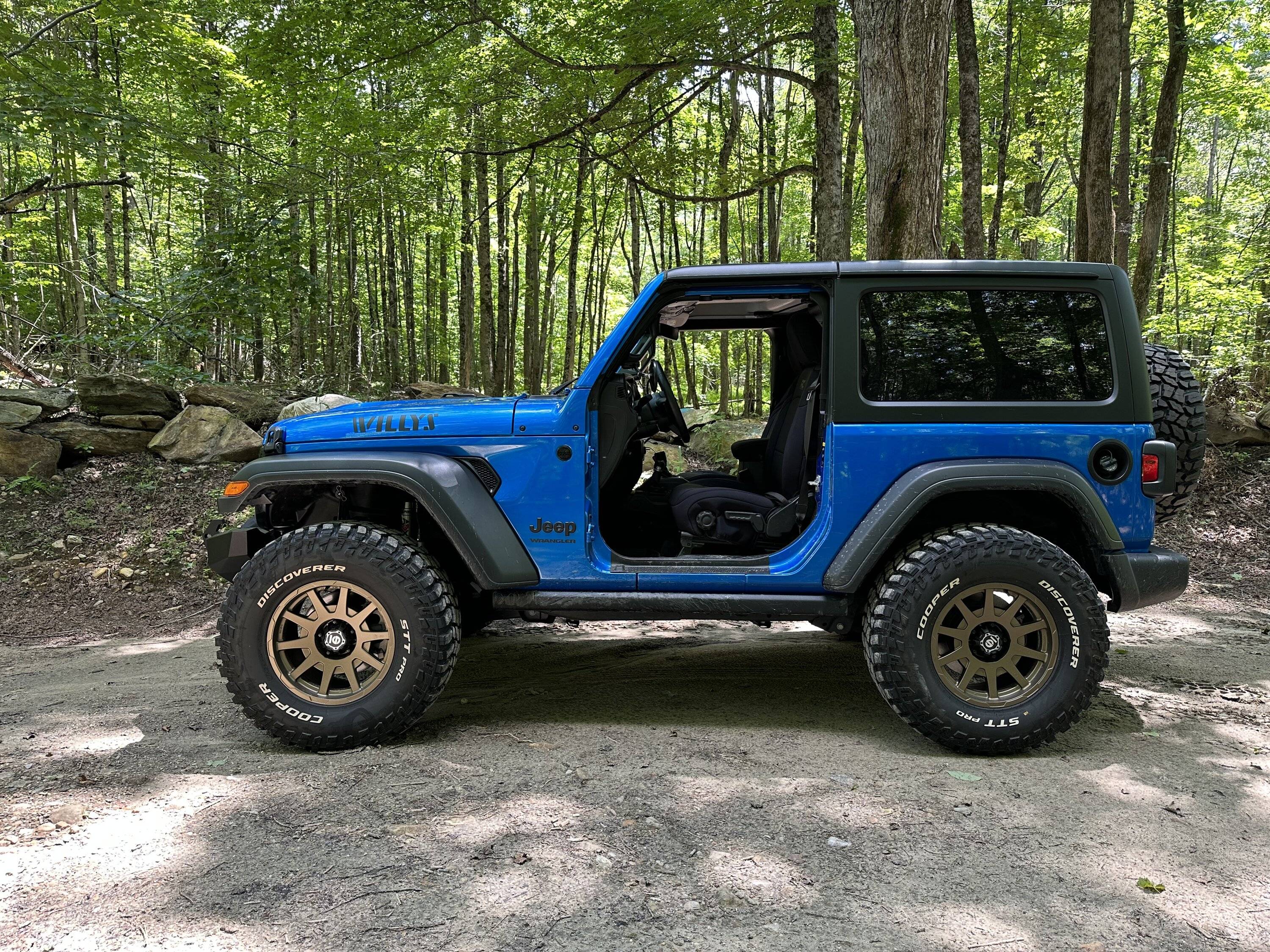

here’s a better shot from the side; same suspension, though it’s now wearing 37s and Hi-line fenders w/ XR Spats.
Looks even better on 37s! Did you re-gear?

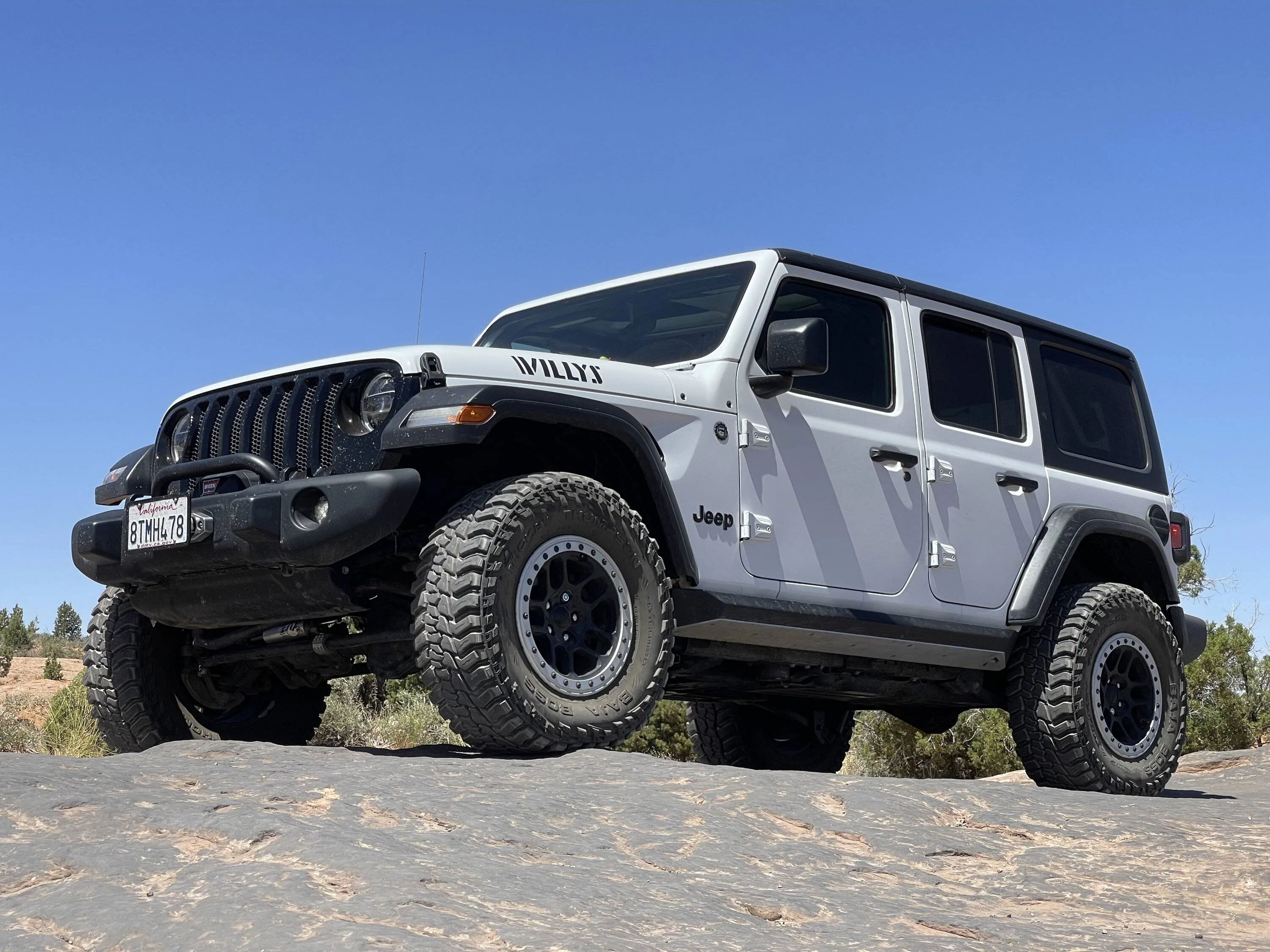

Throw the lift in and then see. Most lifts compensate for the extra weight up front and the height loss is minimal. You may not even need it.
On my Rubicon with 150lbs out front I ended up adding a 1/2” spacer to level it back out.
On my Willys I have 105lbs out front and is perfect and rides better with the extra weight.

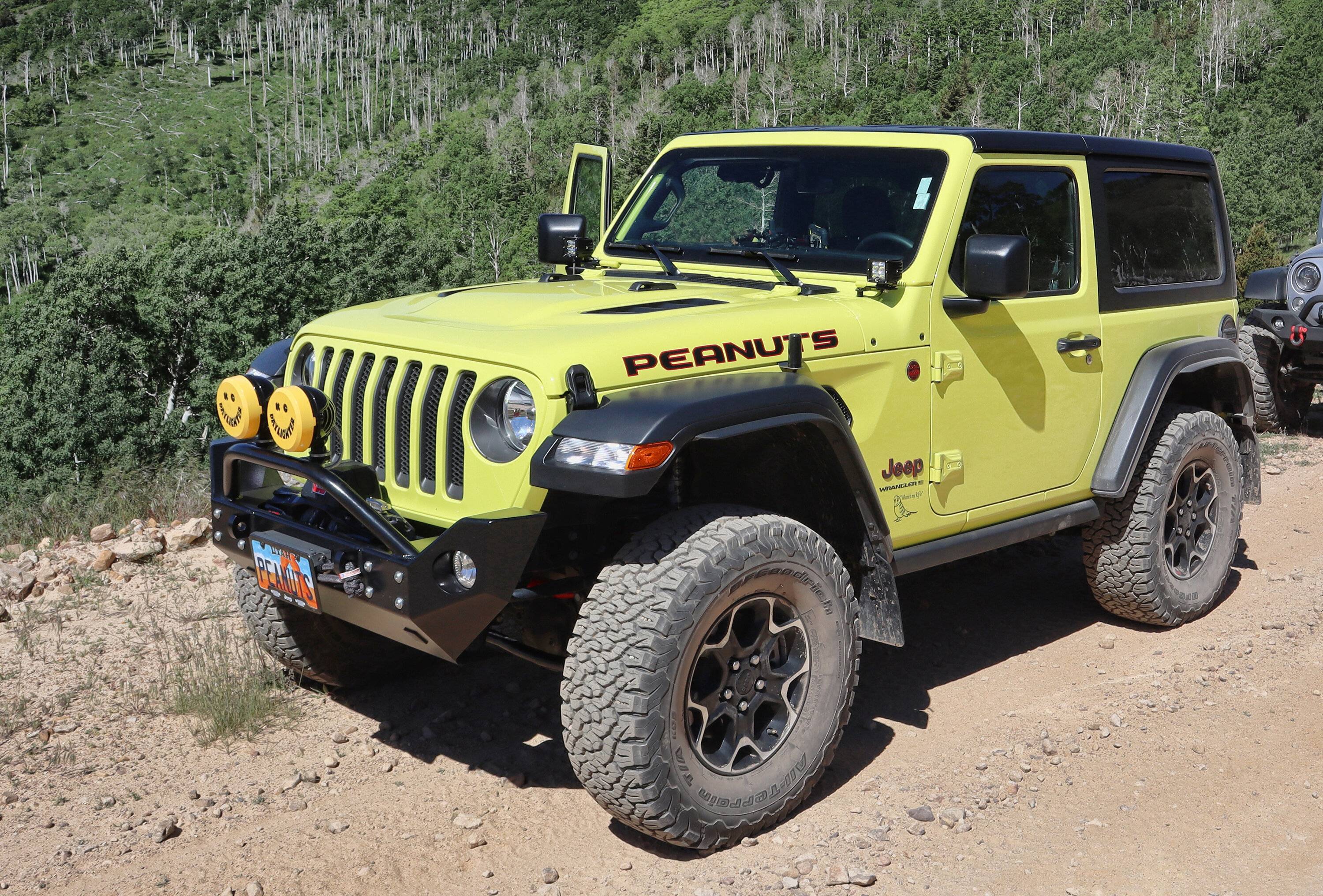

Mine sits great, Mopar Lift which actually measured out at 3.4" average measurement, drives great especially on KO2 35" tires, I have aluminum bumpers and winch and rear seat removed.
