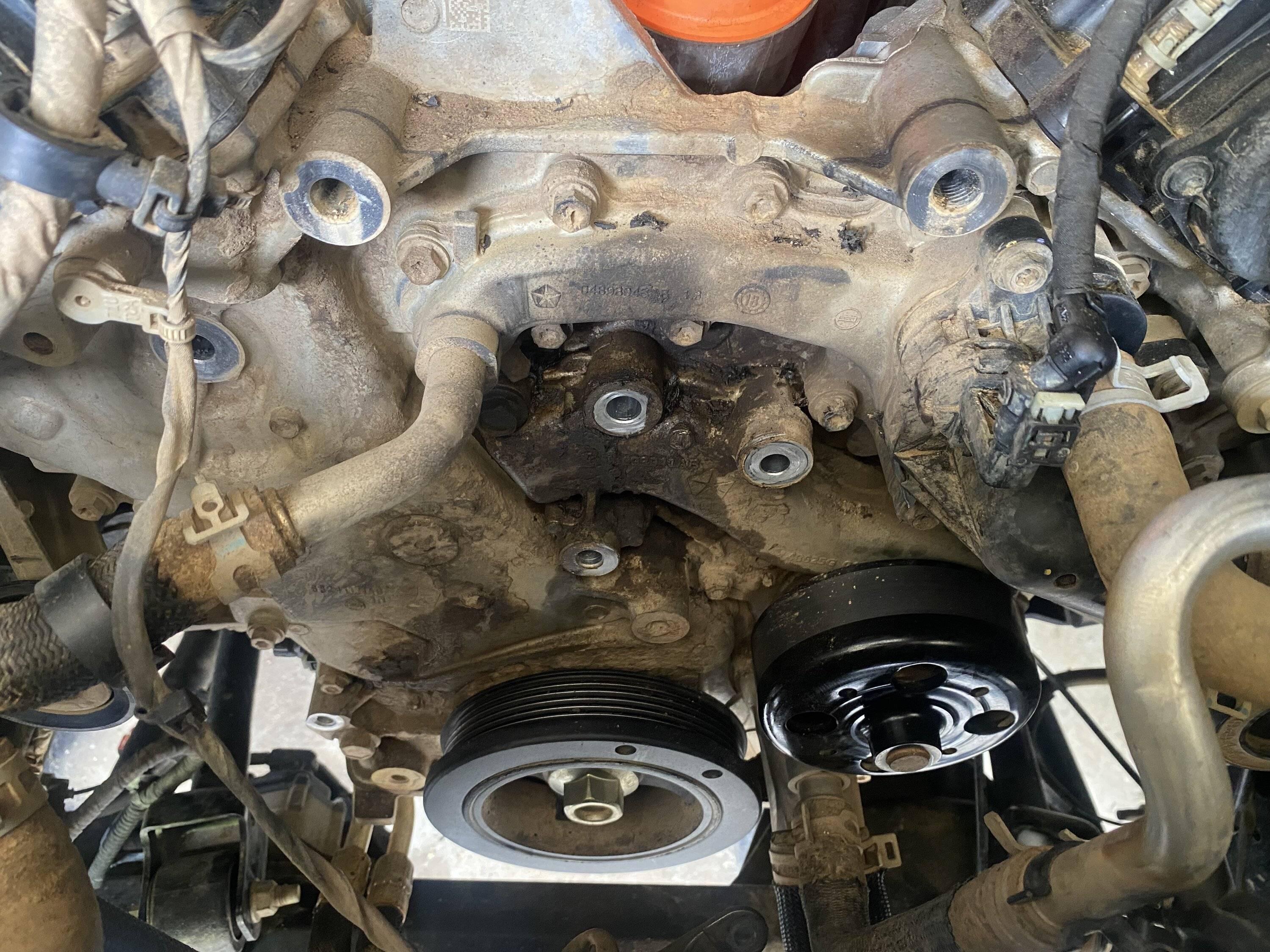

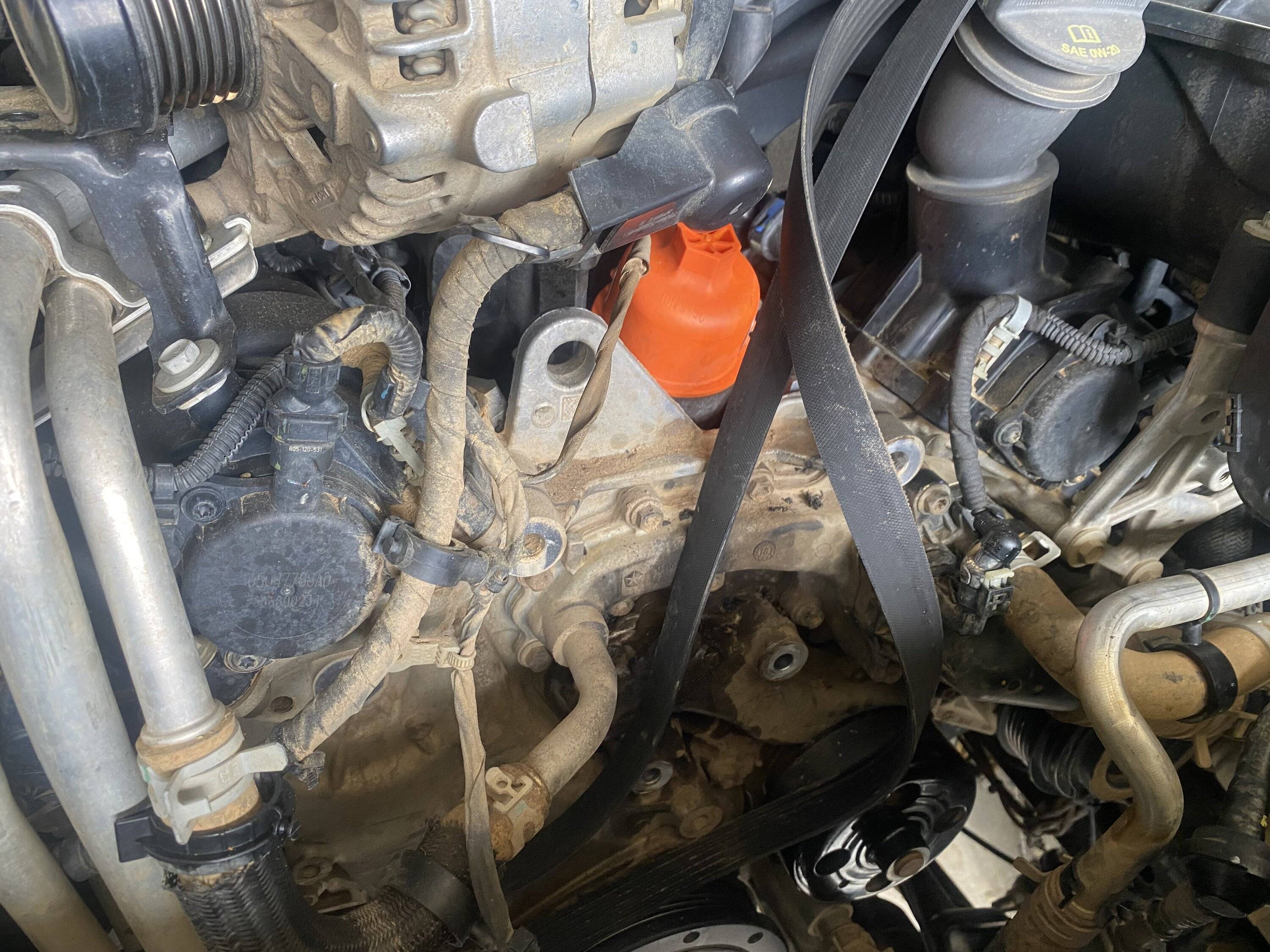

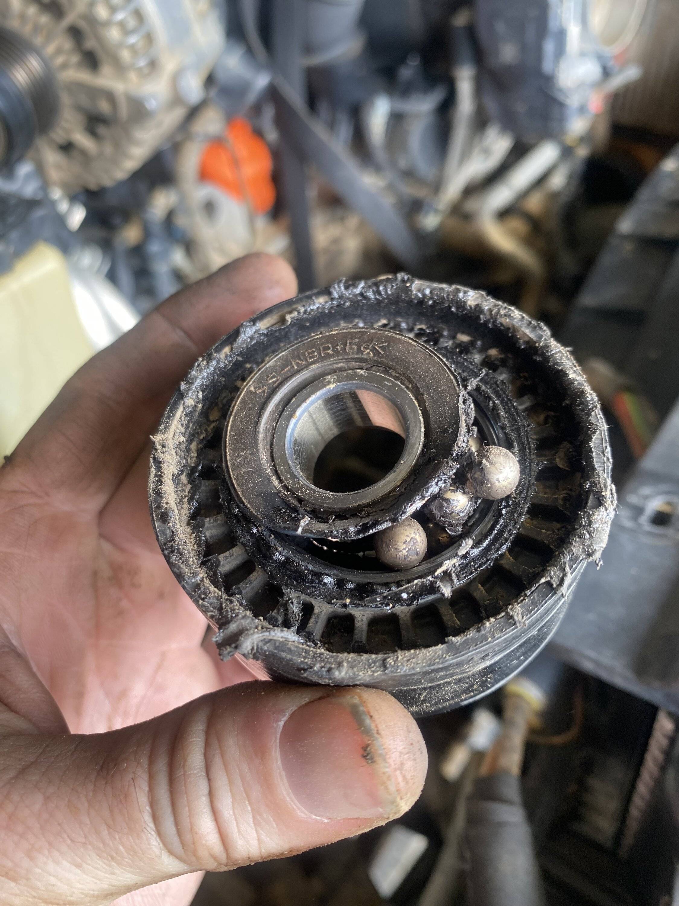

Idler pulley failed and left me stranded on the side of the road. So today after 4 parts stores I was able to get all four and replaced them all while I was in there. Also a new belt. Pulling the alternator off makes it easier to get to the other pulleys, the tensioner is far easier to loosen if pulled downward from under the Jeep and I cleaned up the front of the timing cover while i was in there. So much dirt.

Shoot, you are almost to the "while I'm here" phase and replace the timing chain, guides and water pump!

Well not that far down the rabbit hole. I did contemplate the alternator ?

Yeah it wasn’t all that bad to replace just had to go to multiple parts stores to get all the pulleys. I could have just replaced the one that failed. I’m on my 3 radiator now and have changed the oil cooler. so I’m definitely getting experience on this engine bay.

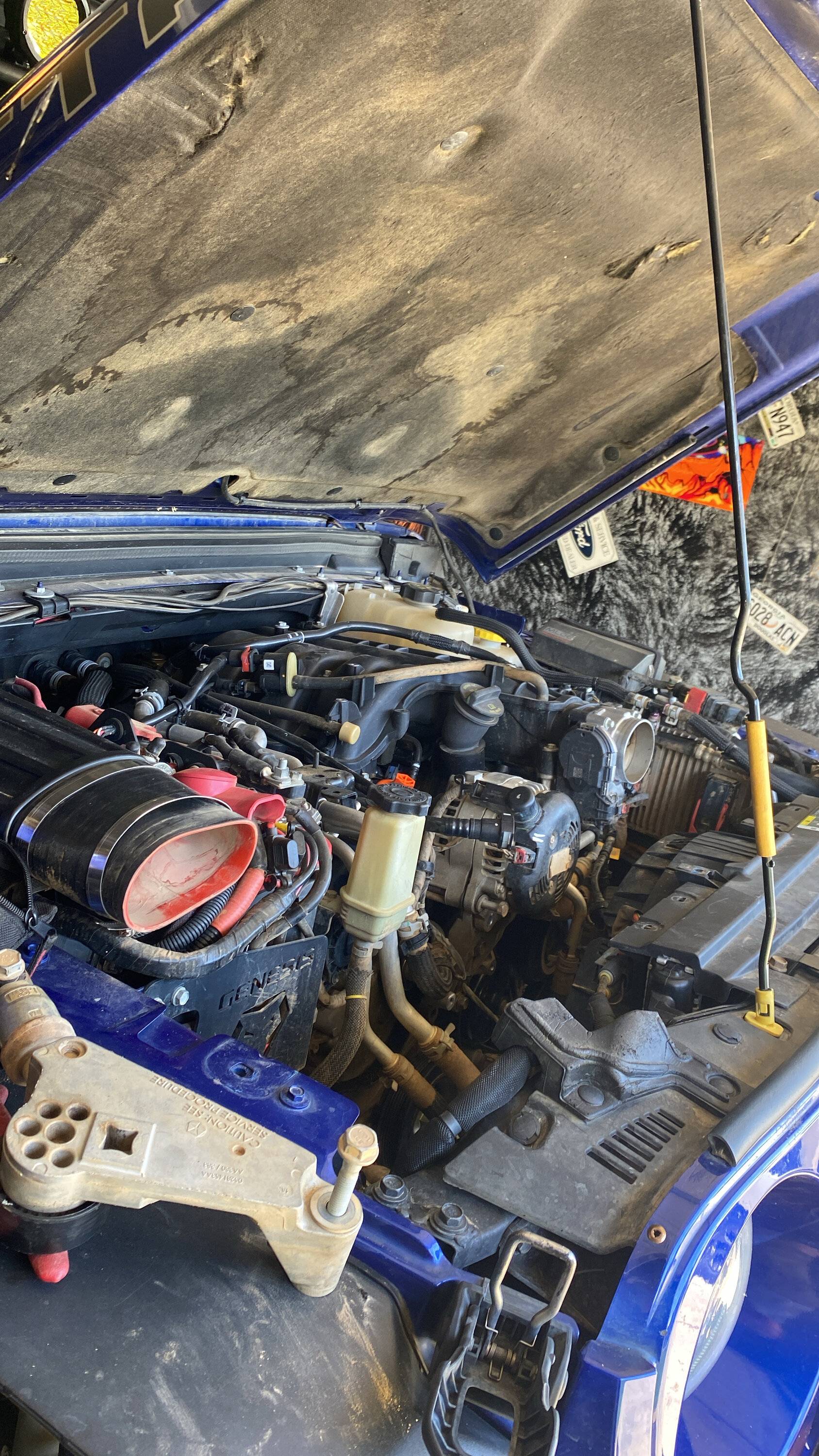

Ironically just had a similiar failure come into the shop with a similiar idler pulley failure two weeks ago. Engine bay was also covered in mud like yours.
I suspect running through mud puddles causes ingress into the ball bearings resulting in failure. Strongly suggest people power wash down their pulleys after going through mud puddles!

When I first started off roading I enjoyed splashing through a good mud puddle, now I avoid them like the plague. But that Wyoming mud is on a whole other level.

Not only that, but replace the failing parts when the start making noise, not when they break and put you on the side of the highway.
