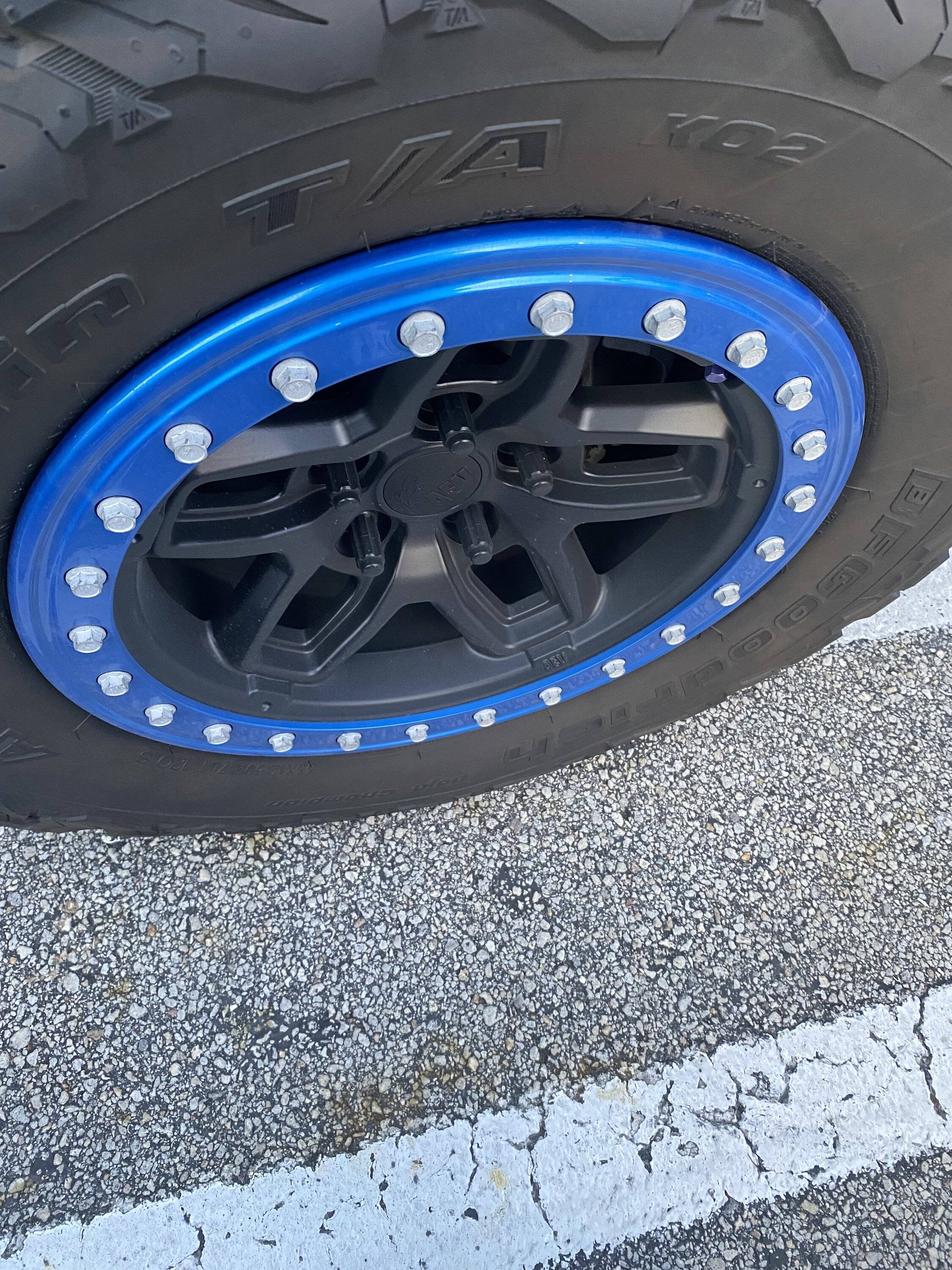

I got new rims and the bolts they came with are silver. I want them to be black, but there are no replacement bolts like it from anyone other than the manufacturer, who only makes it in silver. What would be the best way to make these black? Would powder coating work, or would that just come off when tightening? Plasti dip seems like a big job. Maybe nail polish?? Would love help from you guys

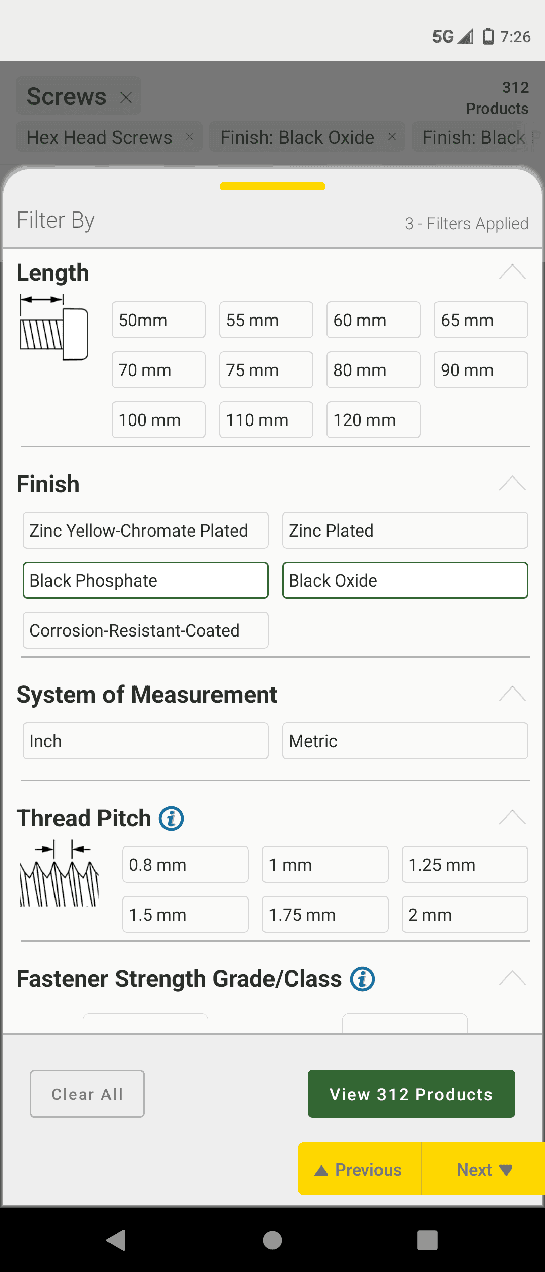

Jeep Wrangler JL How to make these bolts black? Screenshot_20230714-192603
312 Black phosphate / Black oxide hex head bolts...

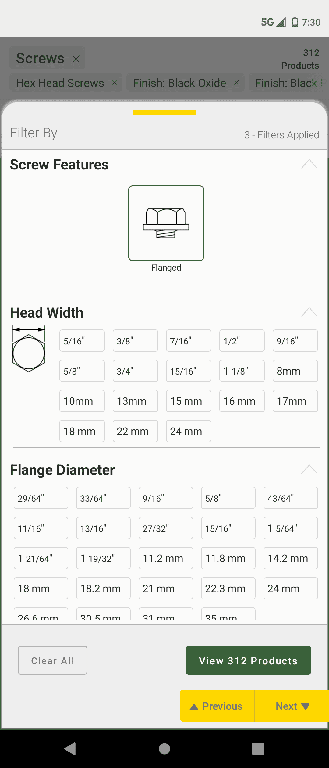

Jeep Wrangler JL How to make these bolts black? Screenshot_20230714-193050
...which are flanged!!! Can't beat that!!!

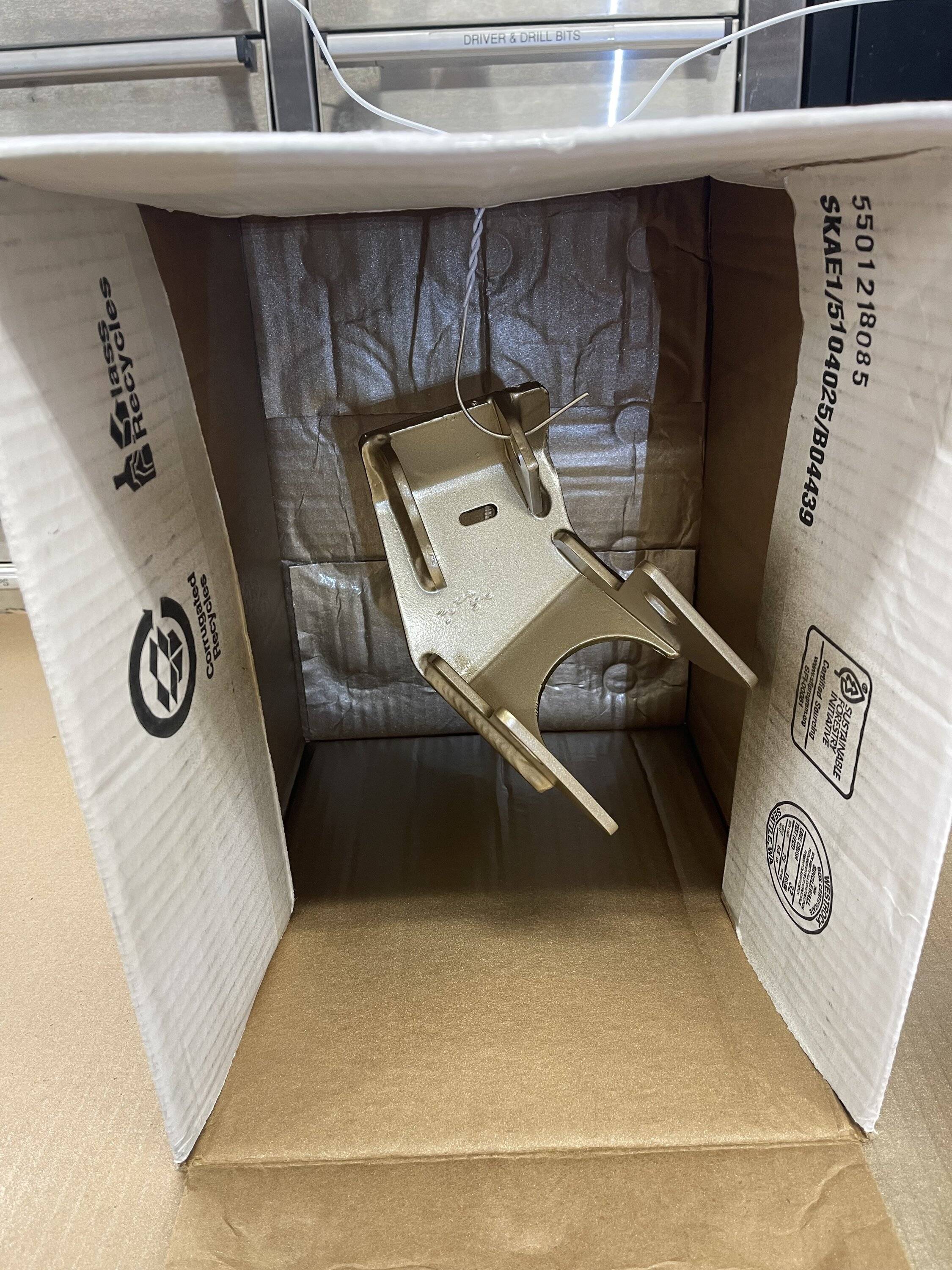

Semi-Pro tip... for painting small parts I use wine boxes for a mini paint booth. Pick them up free at a local Total Wine store. I poke a hole through the top with the top of a metal hanger to hang stuff. You can easily rotate it from above. For bolts and stuff, yeah drill holes in it so the threads poke outside. Lets you spray paint in the garage.

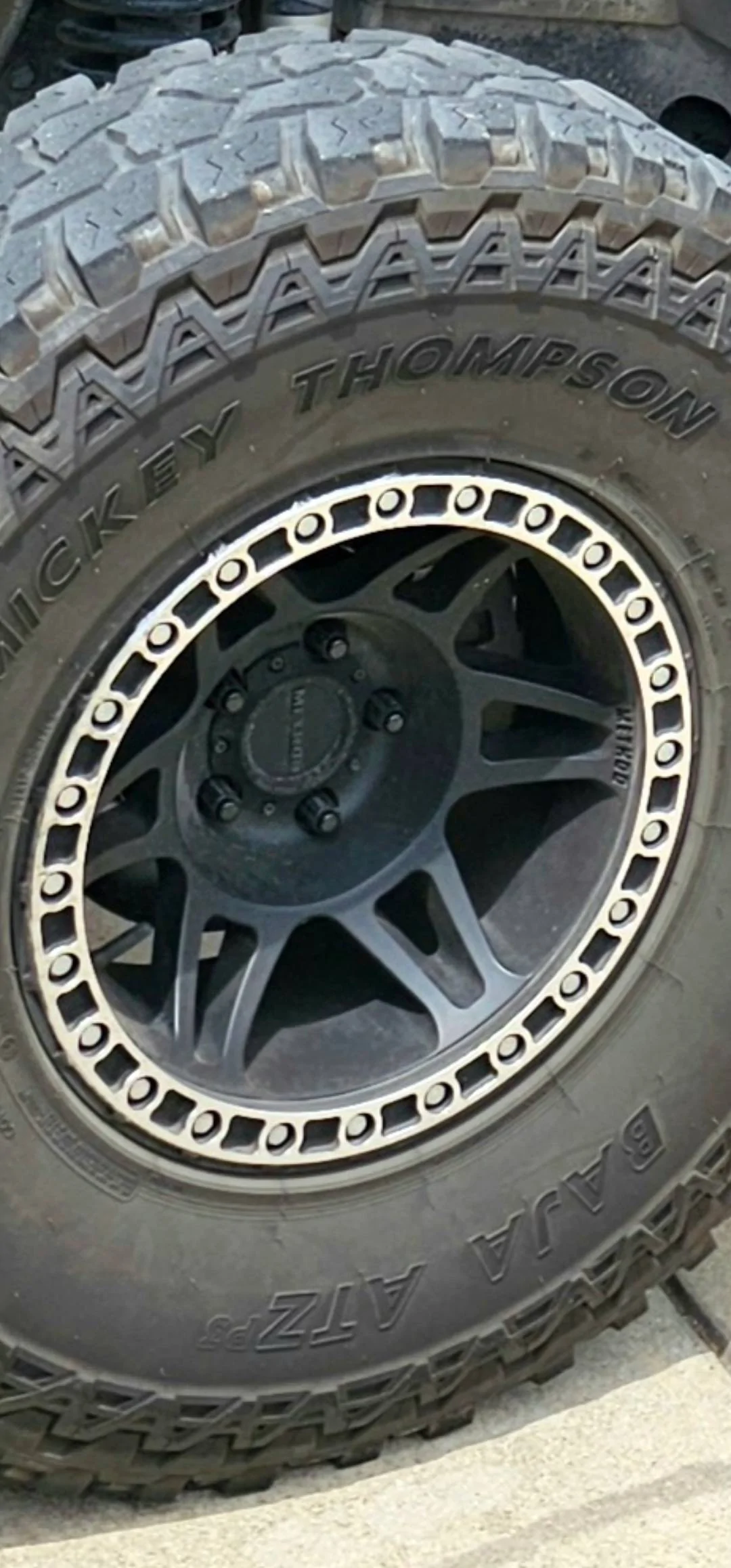

@Gorilla57 7 Yep, countersunk like so...
Jeep Wrangler JL How to make these bolts black? Screenshot_20230714_211954_Gallery
Also, the rings came factory black...finish didn't last forever.
