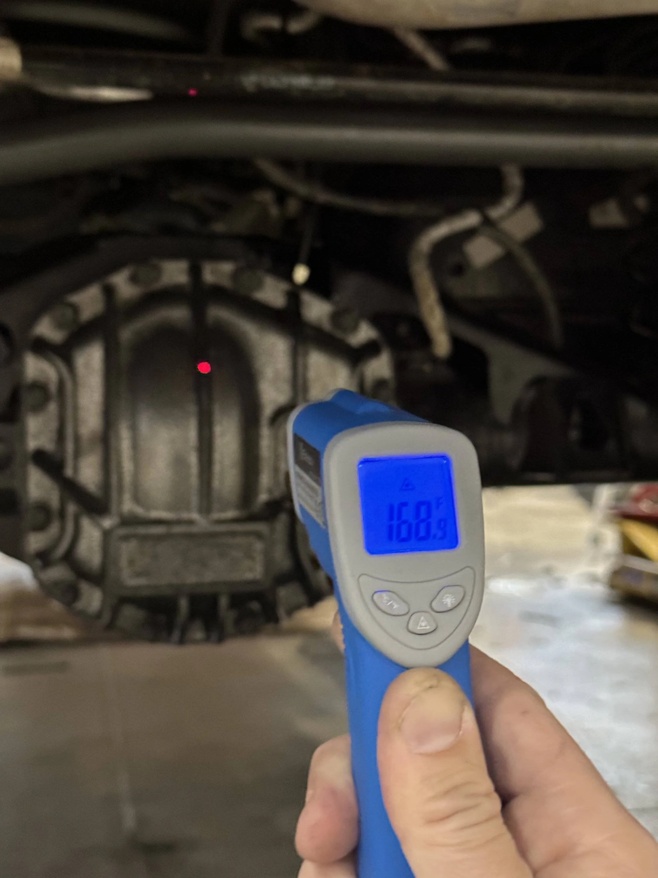

Hottest I captured during my latest gear break-in. I think I may have seen 180ish. I wouldn’t worry unless you see 250…
Jeep Wrangler JL How hot should a diff cover get? 10011E9E-136A-4991-8BF6-6CBFE3916EF9

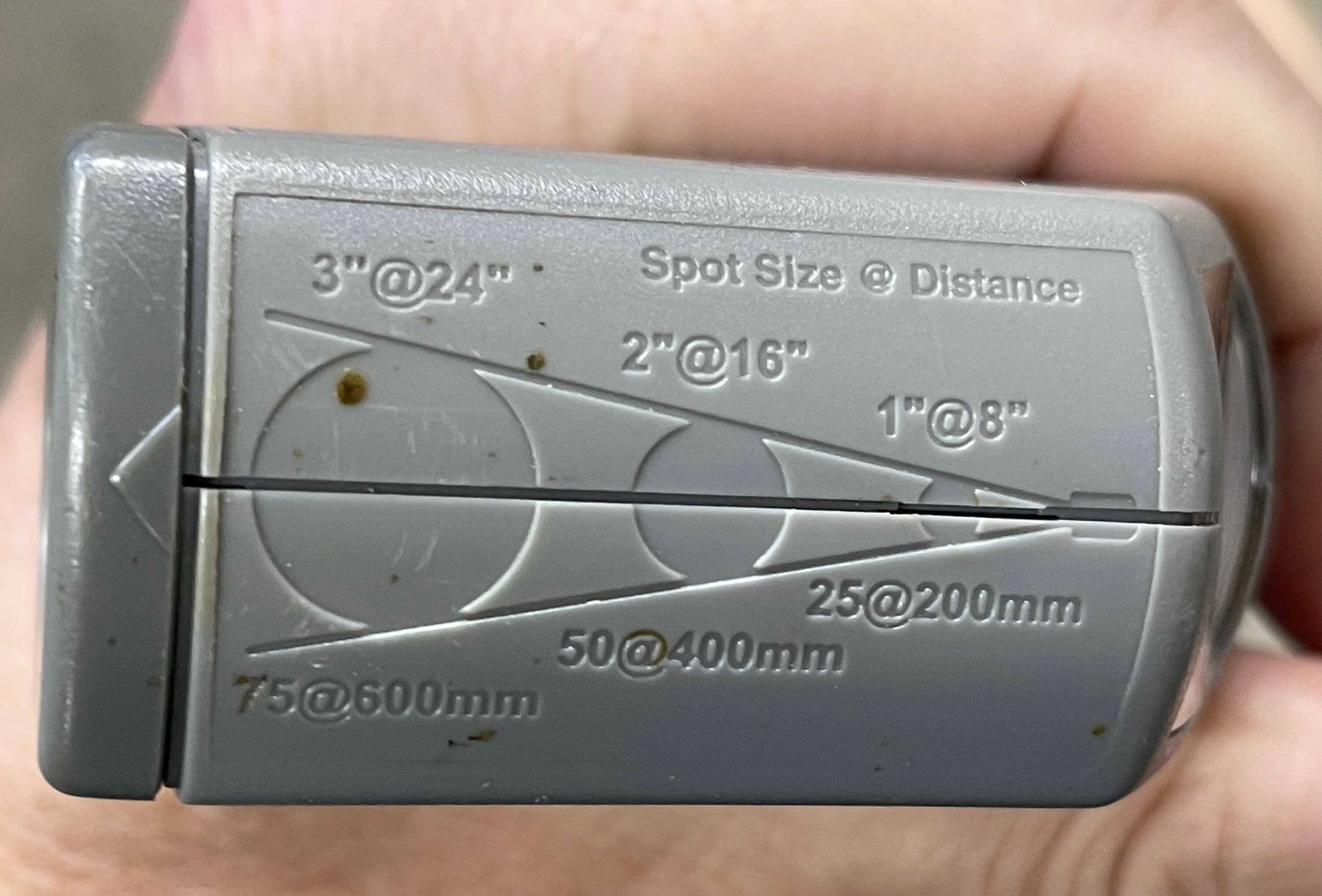

Good luck with that! Most infrared thermometers have a range up to about 1000degF, maybe a little higher in your case. Your propane torch flame is well over 2000degF.
I think this is the one you have…
https://www.amazon.com/Etekcity-Las...76743983&sprefix=Infrared,aps,242&sr=8-3&th=1
Then the other issue is the distance to spot measurement. Typically 10:1 or 12:1 (your case?). The optimum distance is usually around a 12in or so. Meaning you will be measuring a spot about 1in in diameter and getting an average not a peak temp. In my case the beam is a little wider…
Jeep Wrangler JL How hot should a diff cover get? B5D1D5A5-C4DA-4D09-ABC6-4543173FA724
Knowing the capability and how to use them is important. I can’t vouch for the accuracy of yours but my Raytek MT6 that I use for work is quite accurate when used within it’s published parameters.
