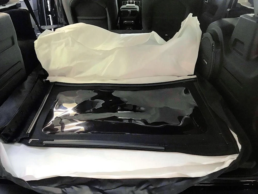

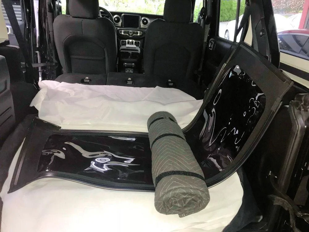

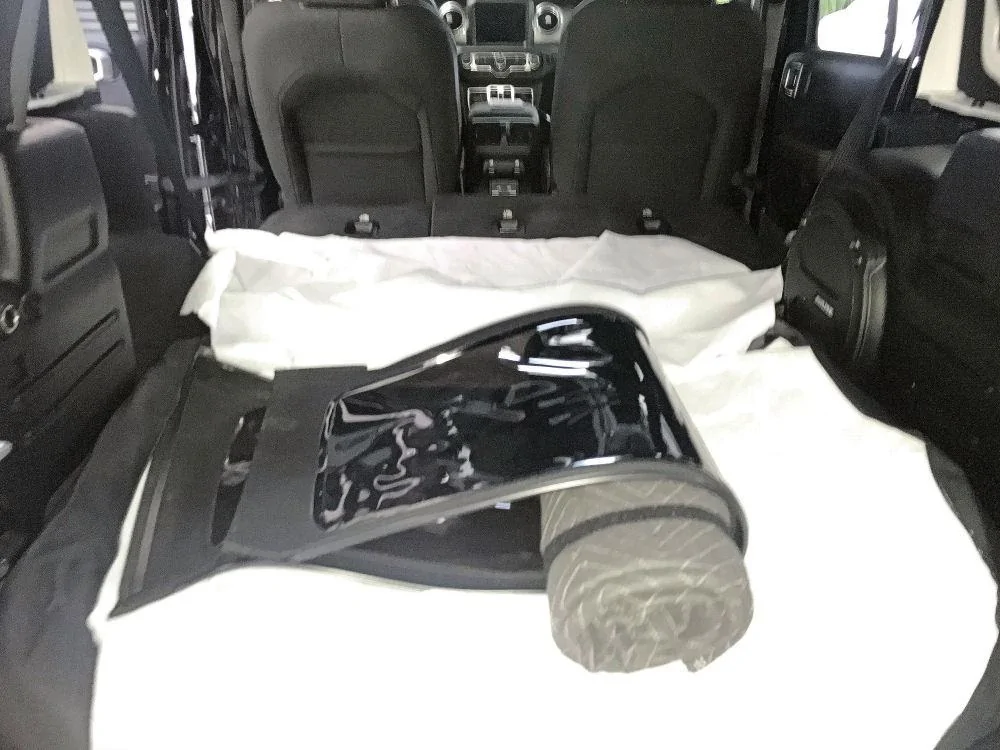

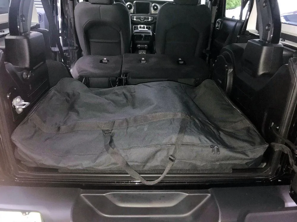

I bought 4 large microfiber towels from Amazon, along with a roll of paracord and a grommet kit. Ringed 3 sides of the towels with aligning grommets, then weaved the paracord through the grommets. Each window ends up with it's own microfiber-lined pocket (highly recommend cleaning with Bestop window cleaner before putting them in the pocket). I slide the whole thing into an oversized leaf bag and tie the top in a loose knot. I think I have $30 or so in it, change the leaf bag out every so often. Pull out the paracord and throw the towels in the washer when needed.

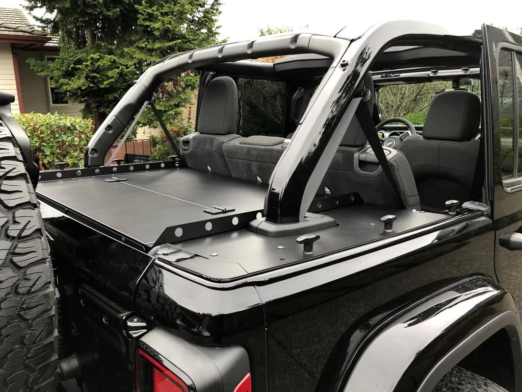

The whole thing can lay flat in the cargo area under my enclosure, but usually stays at the house, along with the soft top, in the summer/summer/fall. I just run with a trail cover, a change of clothes and a towel. I won't melt
