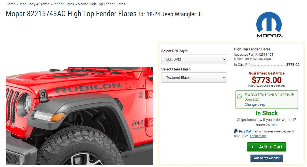

â–˛ Fender flares : Mopar 82215743AC High Top Fender Flares for 18-24 Jeep Wrangler JL

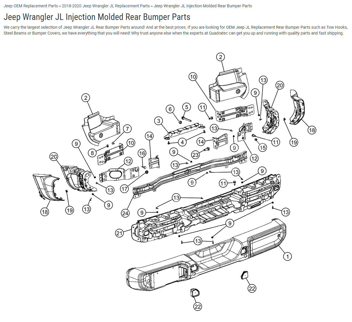

â–˛ Rear bumper : Jeep Wrangler JL Injection Molded Rear Bumper Parts
I bought All parts for plastic rear bumper from Quadratec(sorry).
This site: Plastic bumper parts

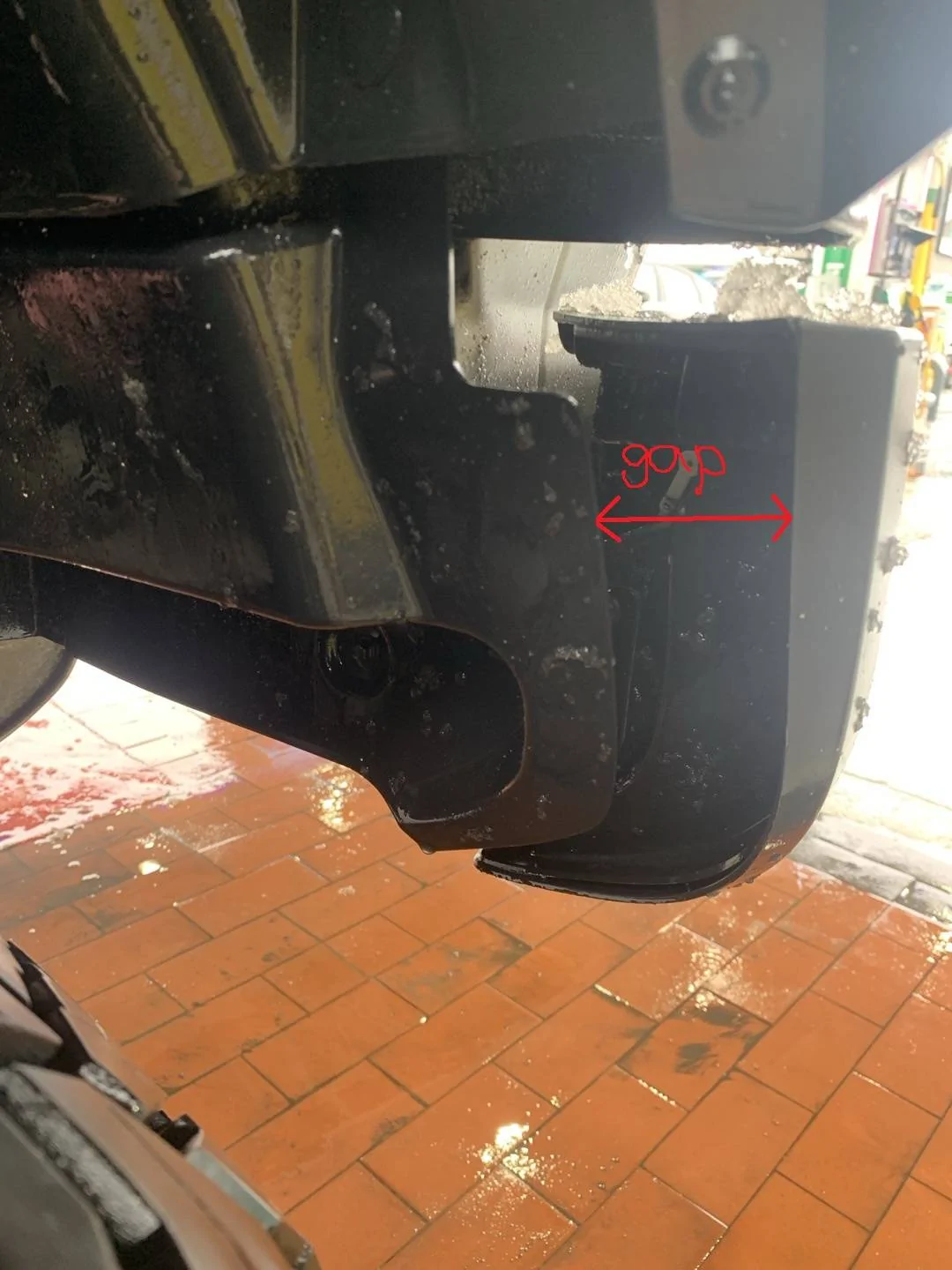

After I installed all of it, I found something wrong.
â–˛ Problem!!!
Jeep Wrangler JL How Can We Help? KakaoTalk_20240401_105339639
I don't know what parts are wrong! Closeout panel? bumper bracket?
I bought all part from the list of Quadratec.
The lines of the rear fender flare and rear bumper end cap match well.
  • Bumper bracket # : 68295345AA, 68295344AA
  • Closeout panel # : 68349683AE, 68349682AE
  • End cap # : 68298823AC, 68298822AC
Could you provide any assistance with this issue ?
â–˛ Problem!!!
Thank you in advance for your kind support.

Hi,
You would need
brackets
68335625AB
68335626AB
end cap
68319213AB
68319212AB
closeout panel
68369969AC
68369968AC
And maybe these extension brackets as well
68295345AA
68295344AA
68349549AC
68349548AB
These are the parts used on Rubicon's with high fenders and a plastic bumper like this
Jeep Wrangler JL How Can We Help? 1712008389553-dy
Please let me know if you have any other questions.

Hi,
You would need
brackets
68335625AB
68335626AB
end cap
68319213AB
68319212AB
closeout panel
68369969AC
68369968AC
68295345AA
68295344AA
68349549AC
68349548AB
