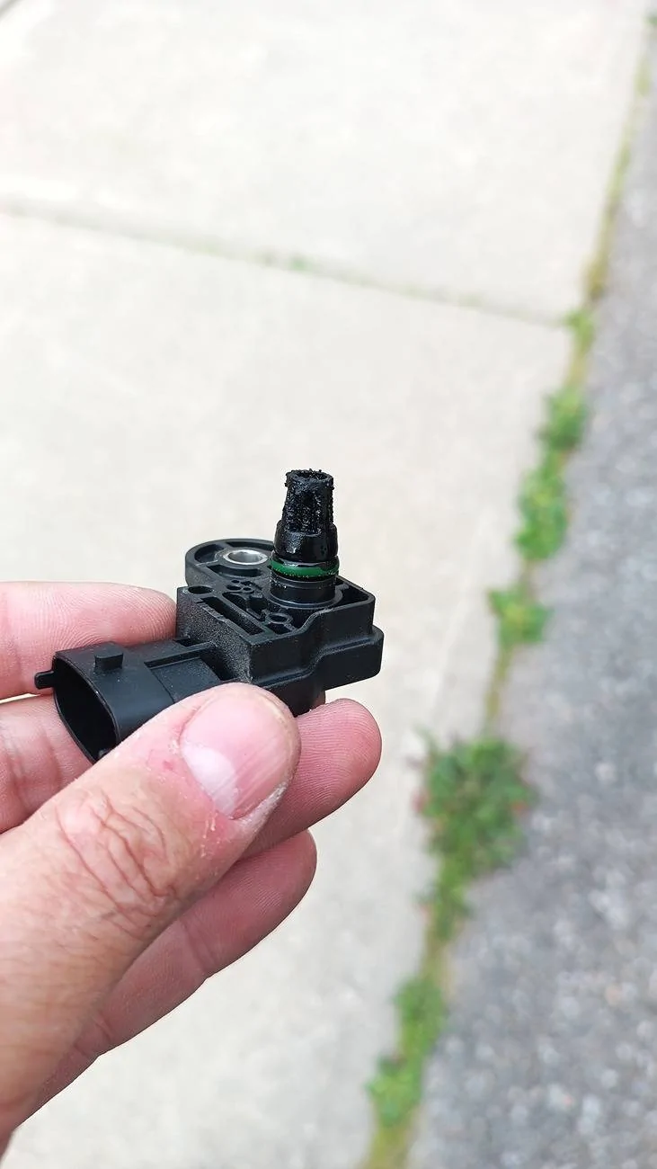

Since everything was apart I did take out the map sensor and give it a clean. Here's what it looked like after 51k.
Jeep Wrangler JL How about Deez Nuts! IMG_20240630_172751_761
