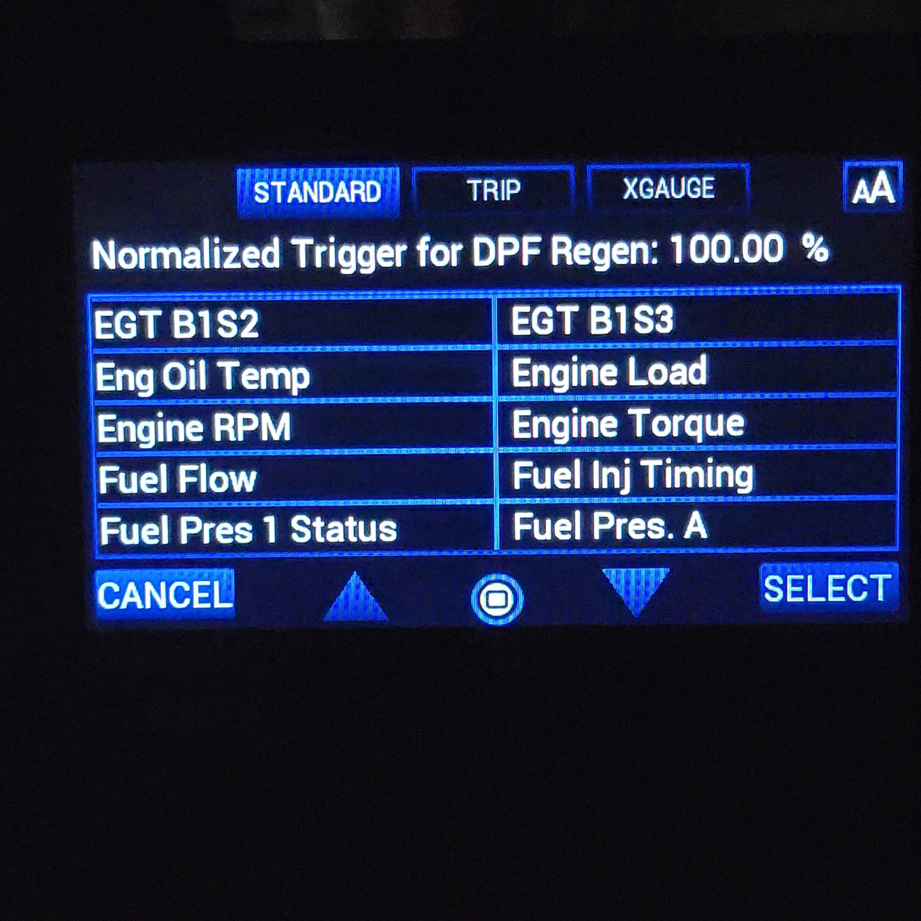

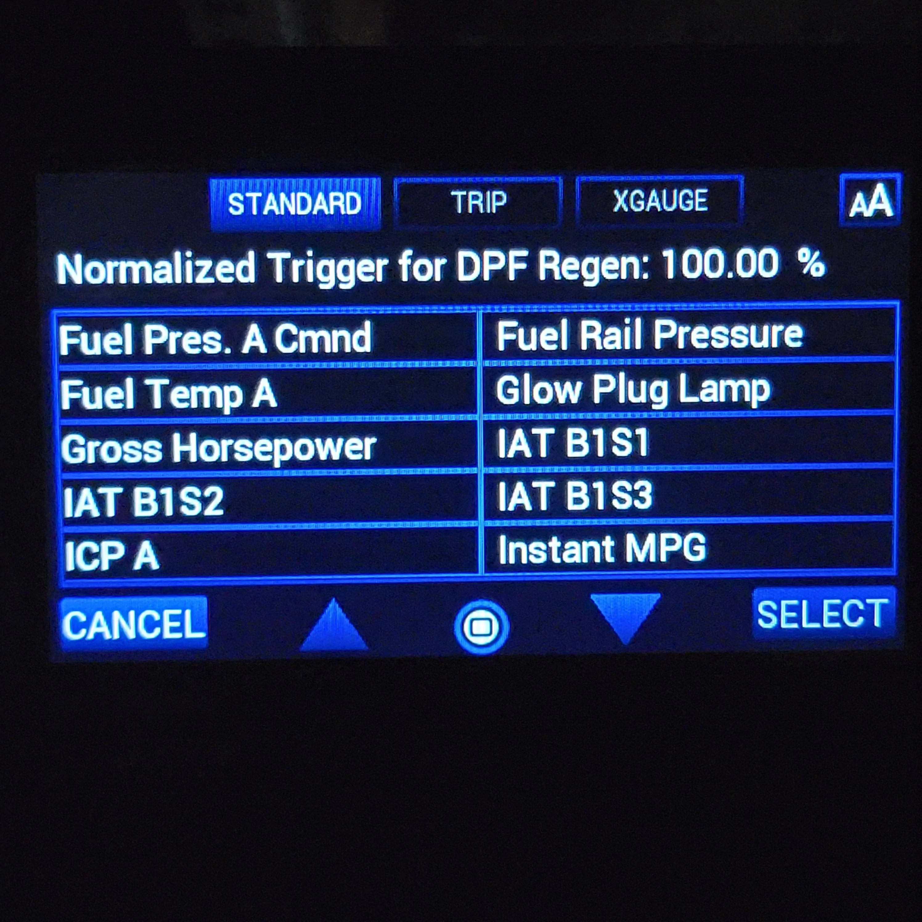

OR
You can go buy a SCANGAUGE and simply plug it in.... on demand HP info whenever you want it... plus tons more info for a self recognized nerd to ponder over.
Attached is a couple examples of what's available...
Jeep Wrangler JL Horsepower Rolling Down the Highway 20231108_203022
Jeep Wrangler JL Horsepower Rolling Down the Highway 20231108_203010
