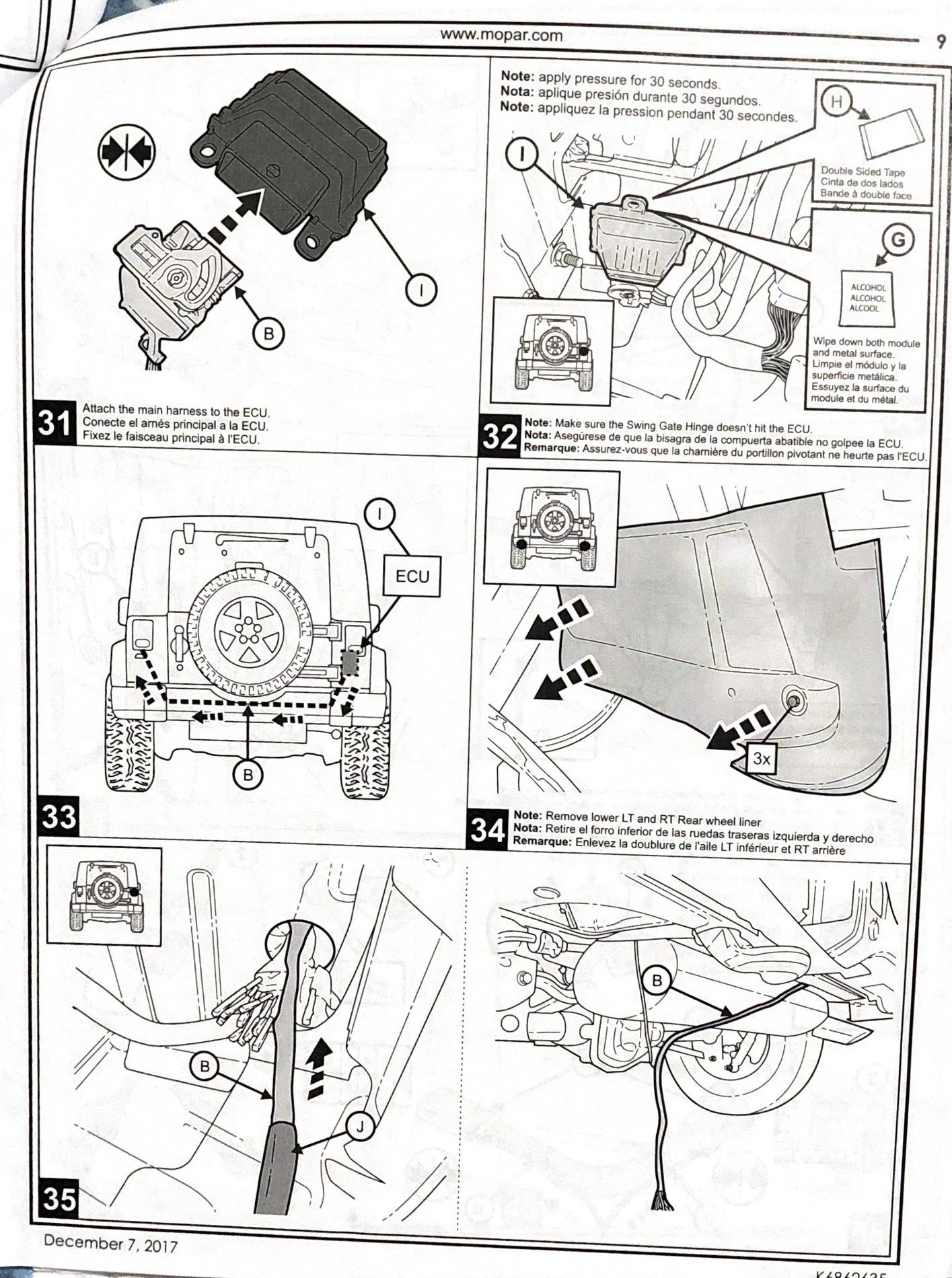

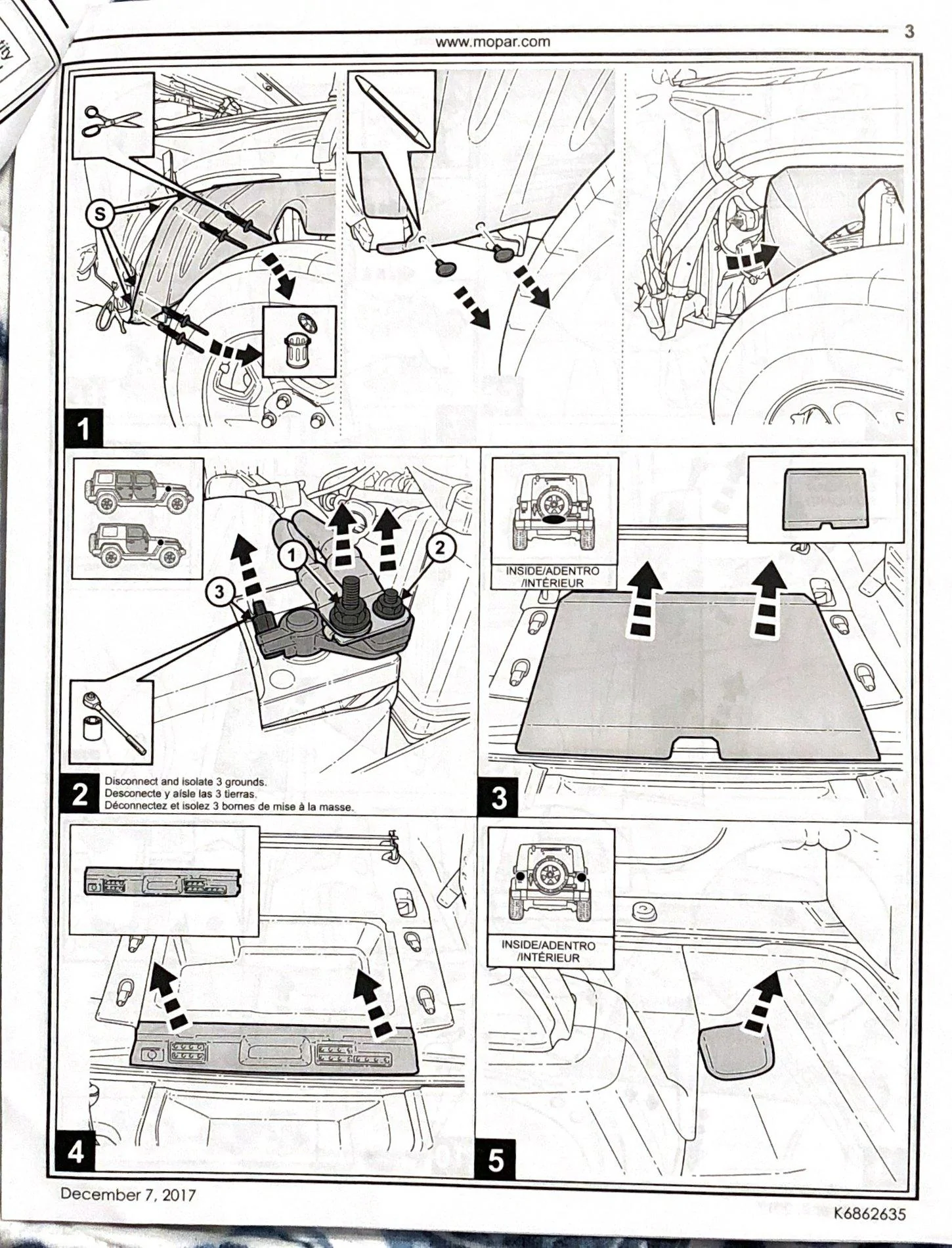

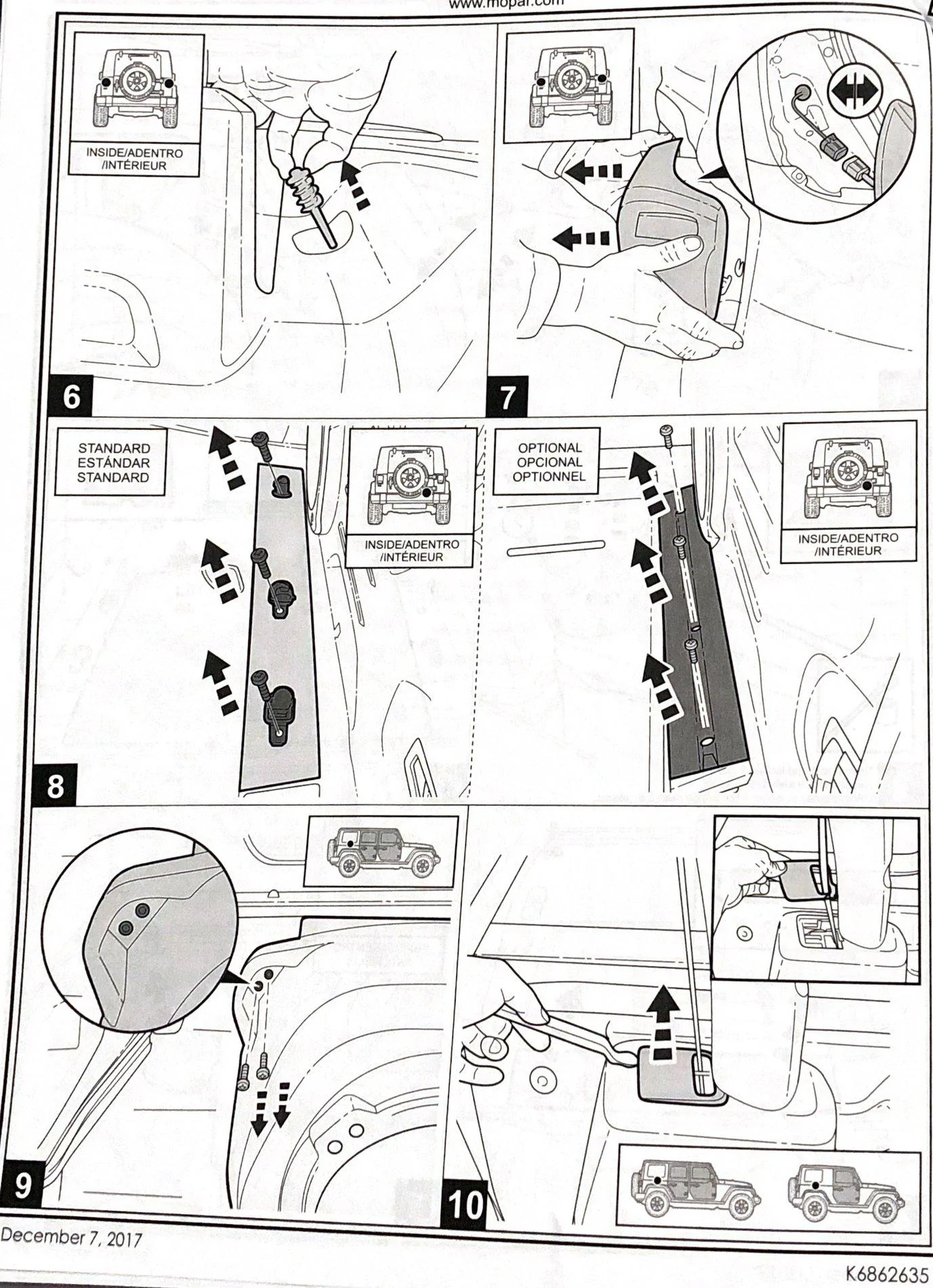

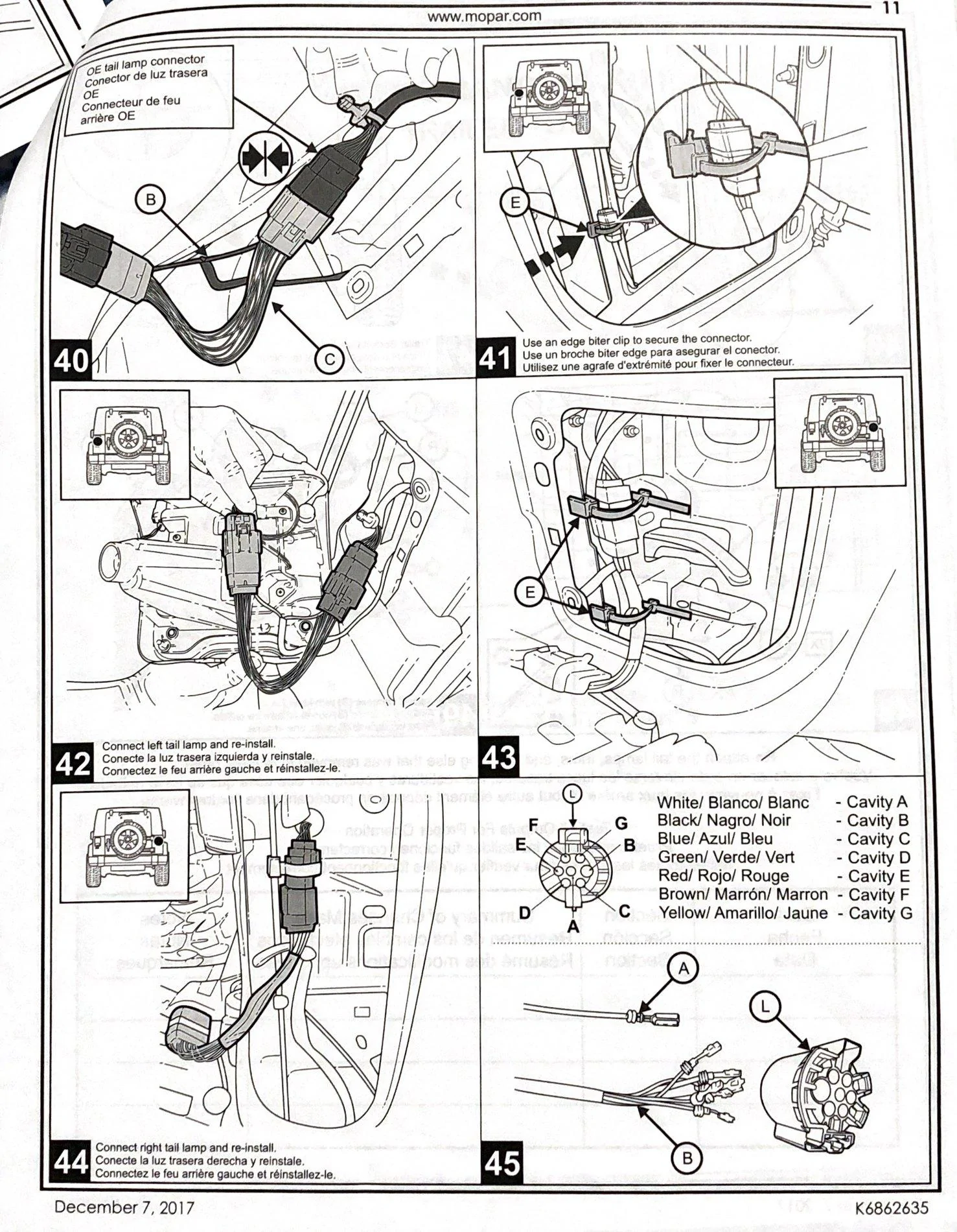

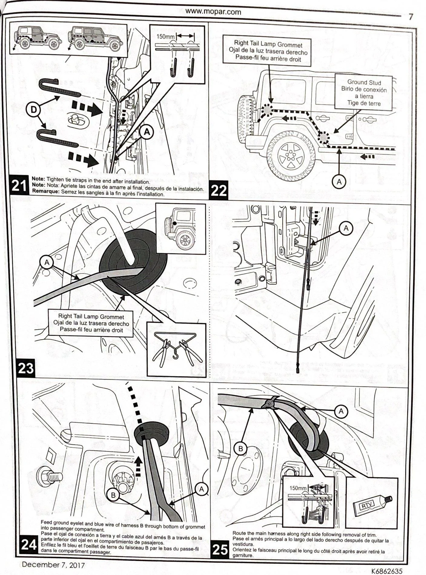

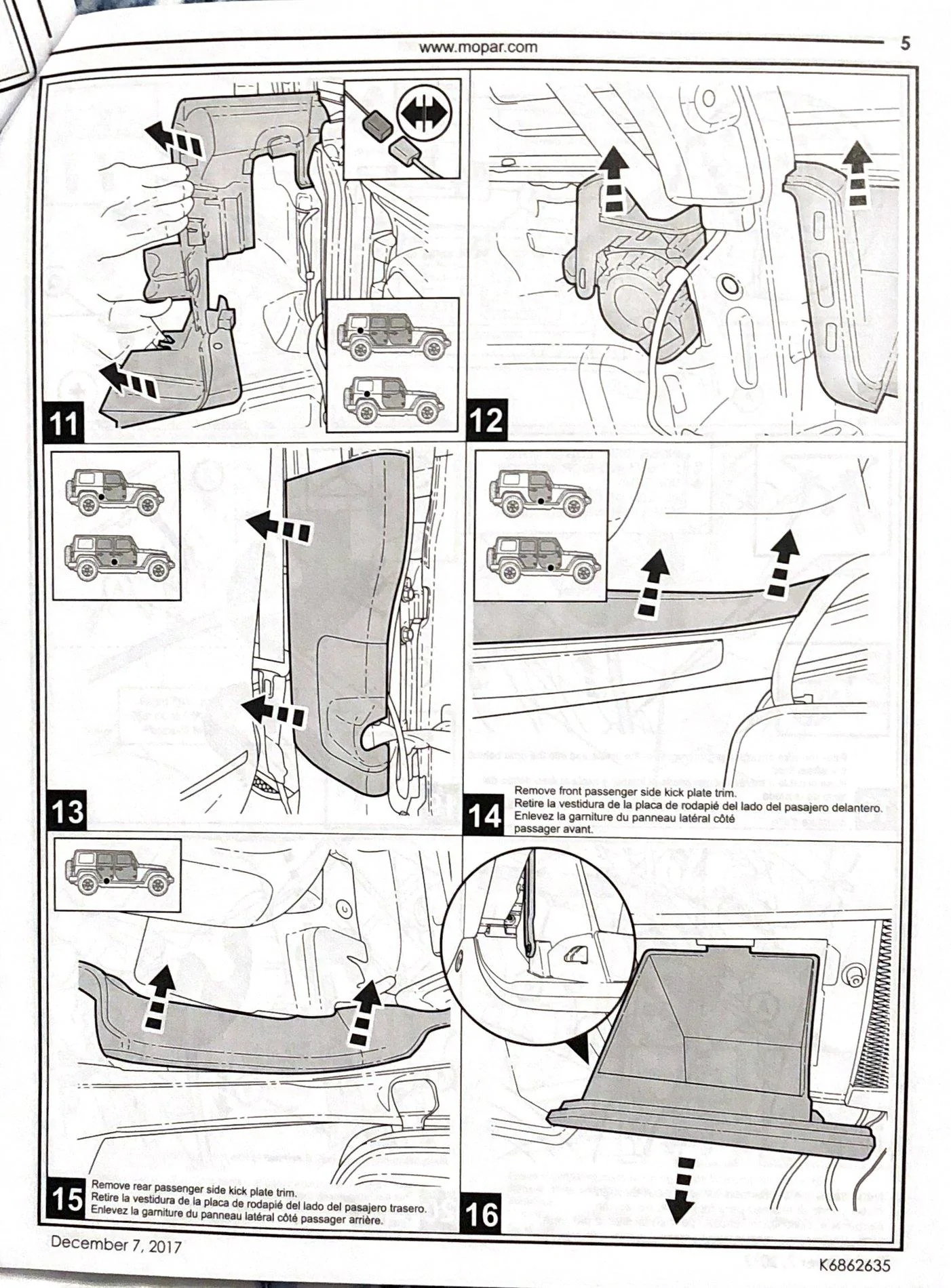

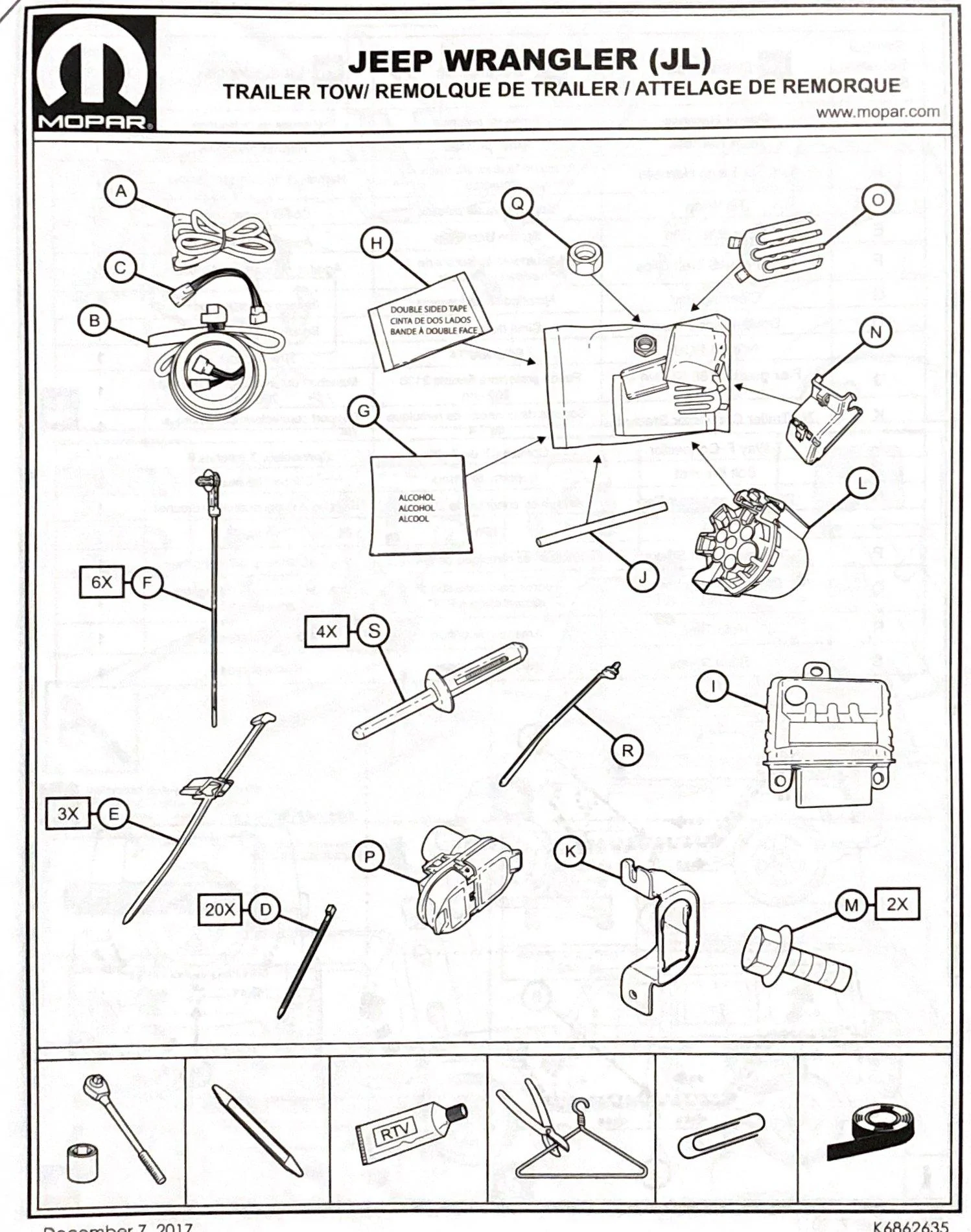

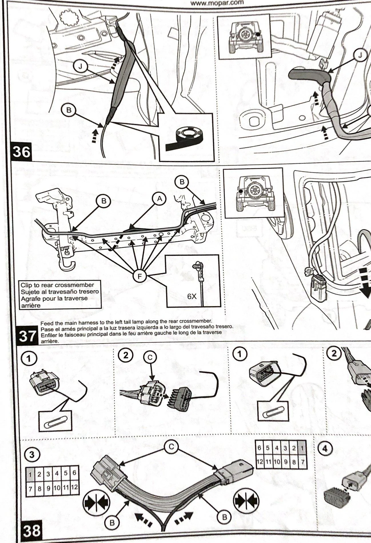

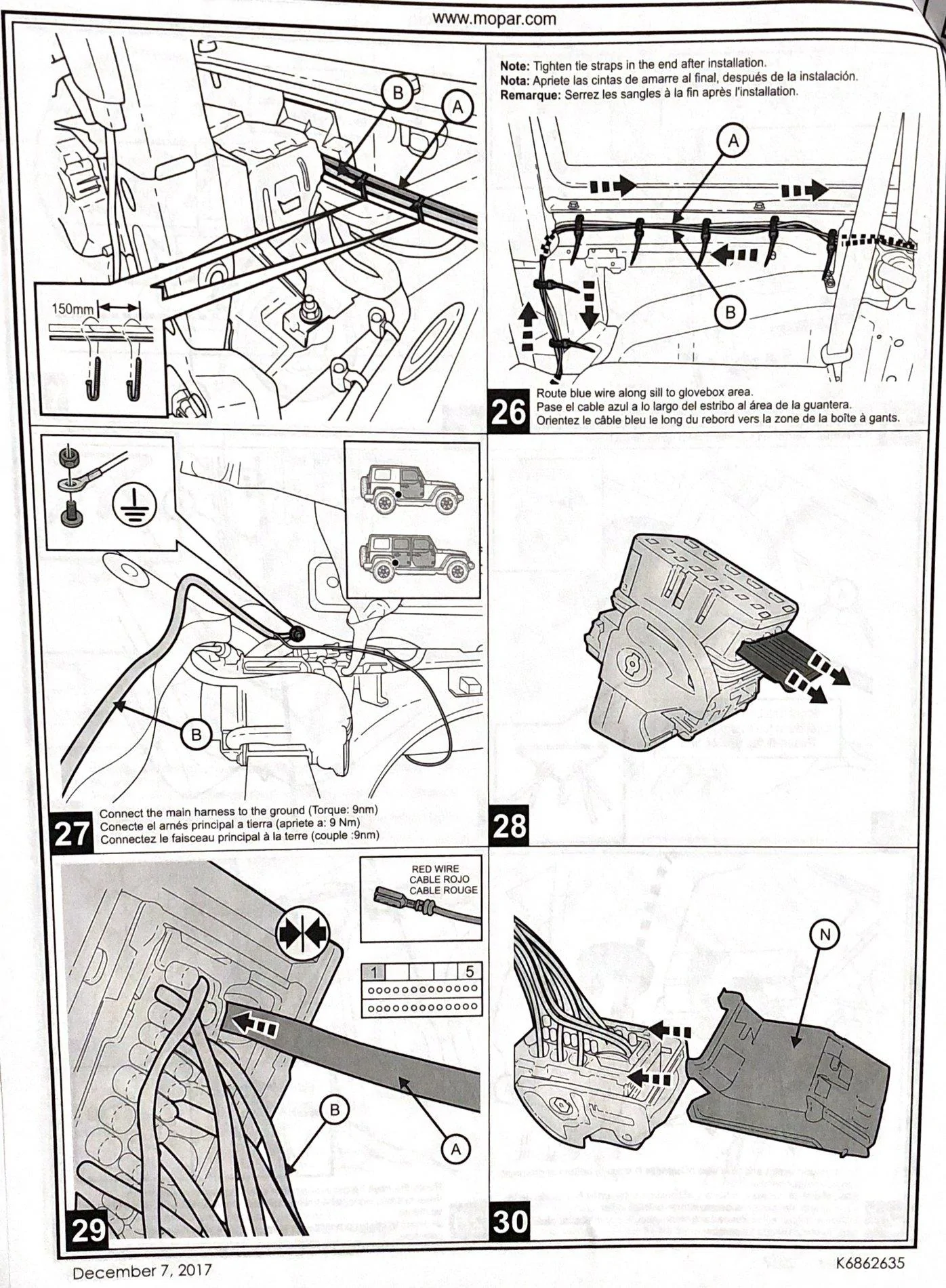

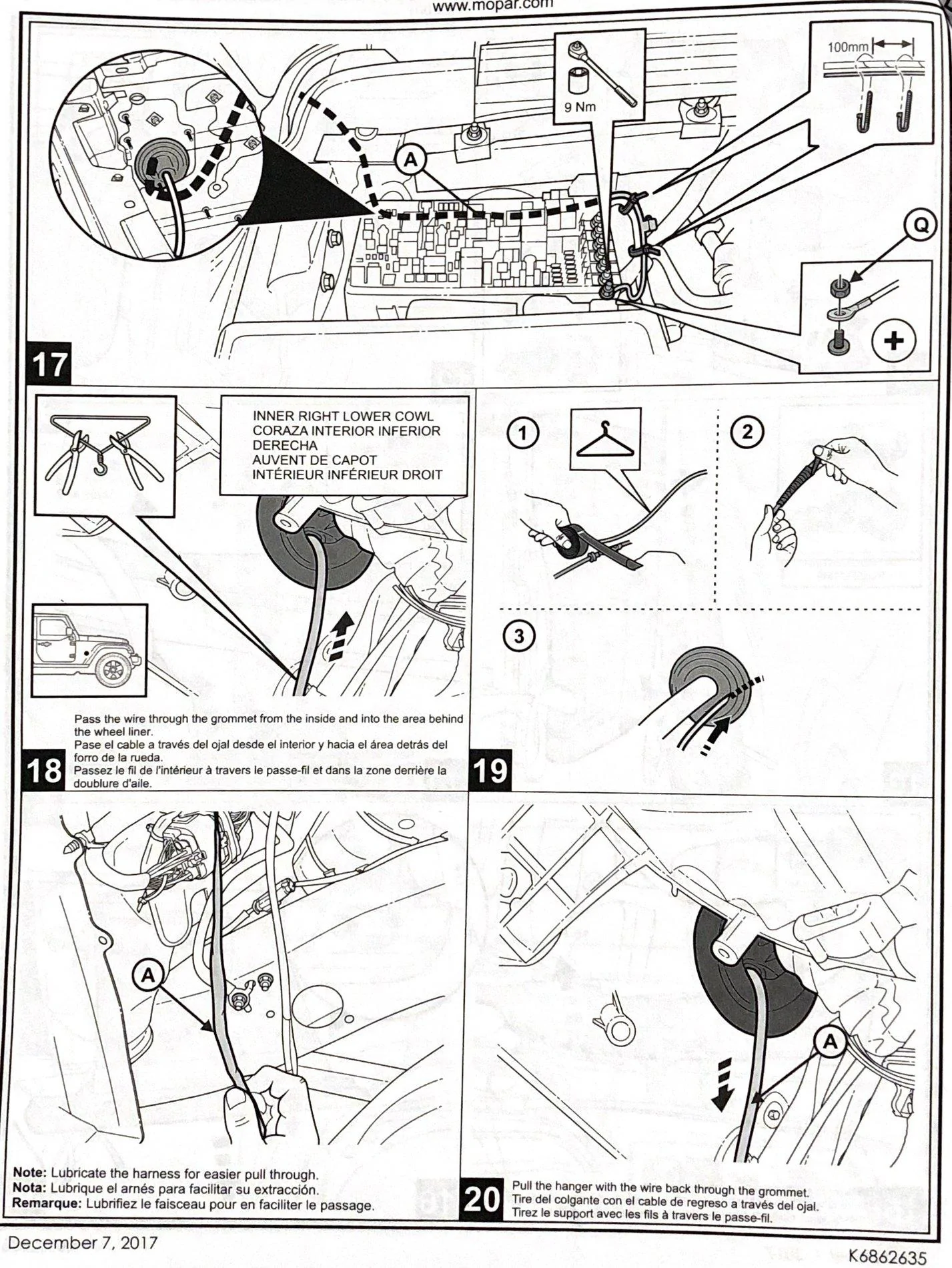

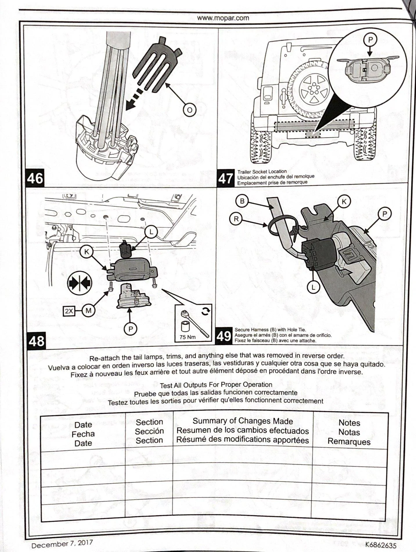

Hi there, I am in the process of putting thogether the same parts as you have to do the hitch and harness install. When I was going to put remote start in my jk it said in the install instructions to flash the as built file to update the computer to allow the remote start. Does the install manual indicate the need for the as built file to be updated to allow the hitch wiring kit to “activate”. Could you perhaps upload the pages of the install manual so I could see the process start to finish?
Thanks in advance
I will try and post it. It doesn’t say anything about having a Ecu flashed or doing anything like that.

Man, that seems like an in depth installation procedure. I wish mine came with it, too!!
