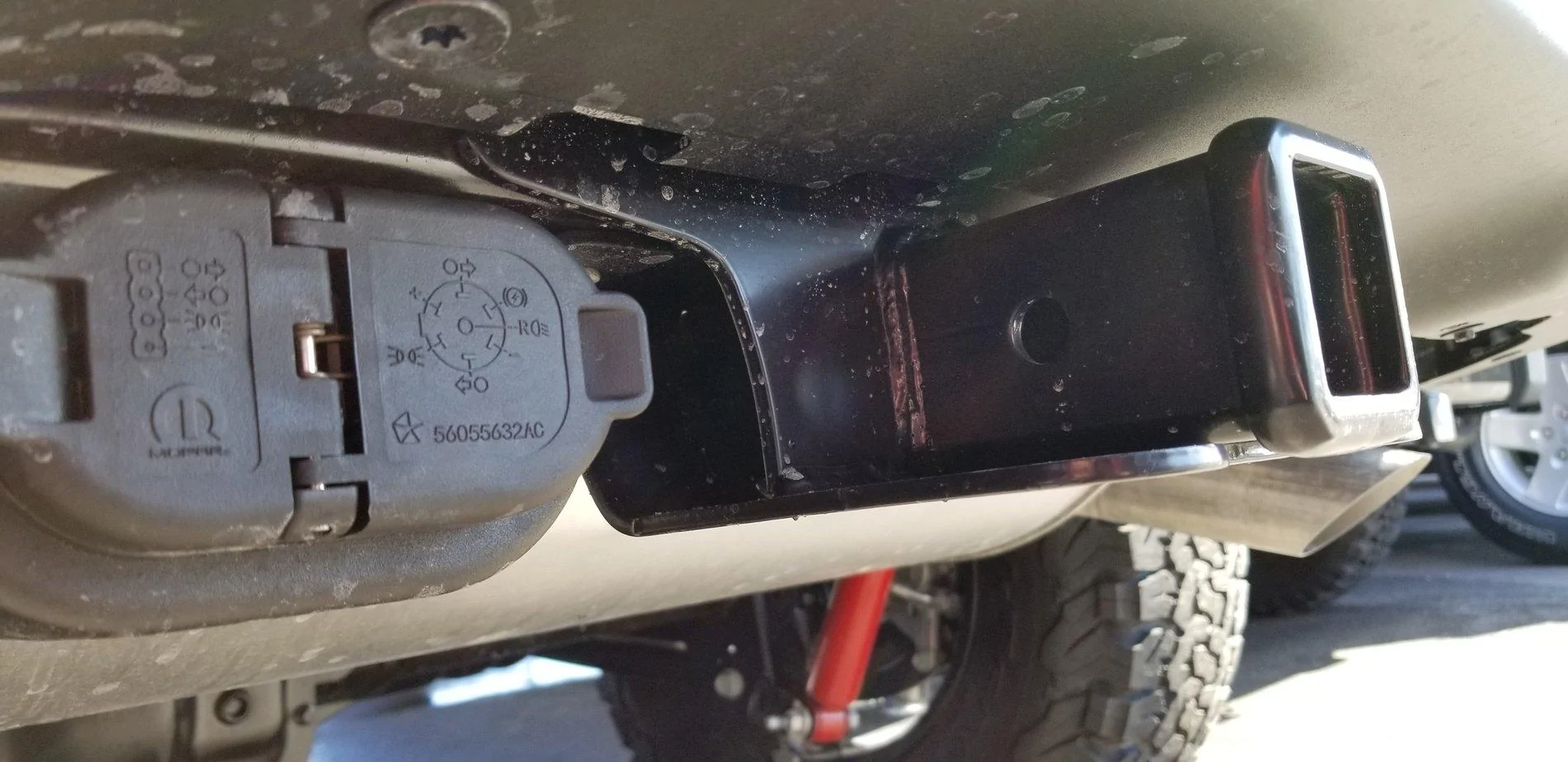

I ordered the JL Sahara with the factory tow package...anyone have pictures of the factory receiver and where the 4/7 pin plug is located. Online photos only show reciever. I’ll need to add a electronic brake (after market) to tow a dual axle utility trailer.

It's on the left side, hitch level.
Perfect thanks...anyone know if they have a class III receiver available yet? Either OEM or aftermarket.
