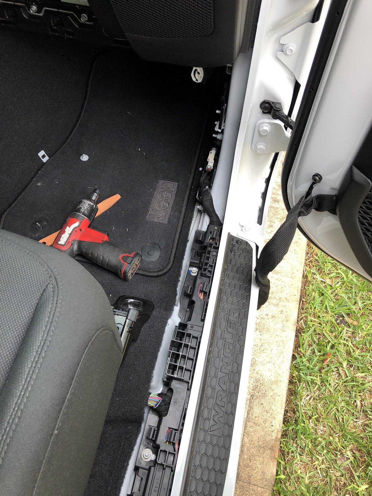

I got a chance to install my Curt hitch. The hitch fits no problem, but a second person is nice to push on the muffler forward a bit so that you can get the bolts started.

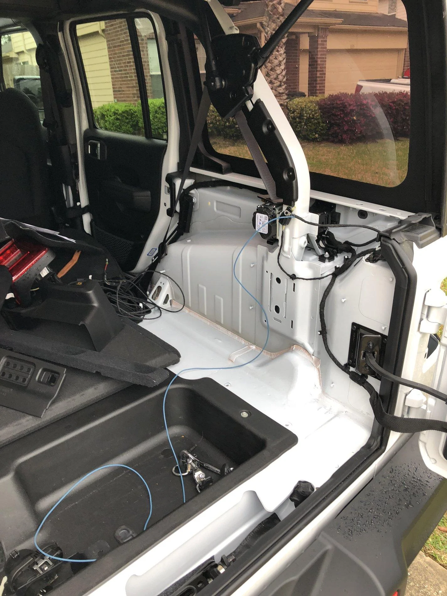

Now the 7 pin wiring on the other hand is a different story. I have been working on the 7 pin wiring project for 5 hours and still am not done, had to call it quits, too dark underneath the jeep at night in the shop.
The seven pin wiring is way more involved then I thought it would be. Basically, you have to disassemble all of the trim pieces from from front to back on the passenger side, take the glovebox out, and both taillights out. You are also supposed to run a wire through a very hard to access rubber grommet in the firewall from the fusebox all the way back to the passenger taillight. I tried and tried, maybe for an hour and a half and with a second person but I could not get a wire through this grommet, so I ended up running the power wire through the frame under the jeep.
There is also a couple of places where you actually have to add wires to prebuilt connectors. All of the connectors are a real joy to figure out how they operate. They seem to be all different. Basically if your idea of fun is pushing a wire, then you will love this project.
I still am not exactly sure how to mount the 7 pin connector on the back of the jeep. Will tackle that this am.

This install is not easy I can see people breaking a lot of trim clips and having rattles after the install

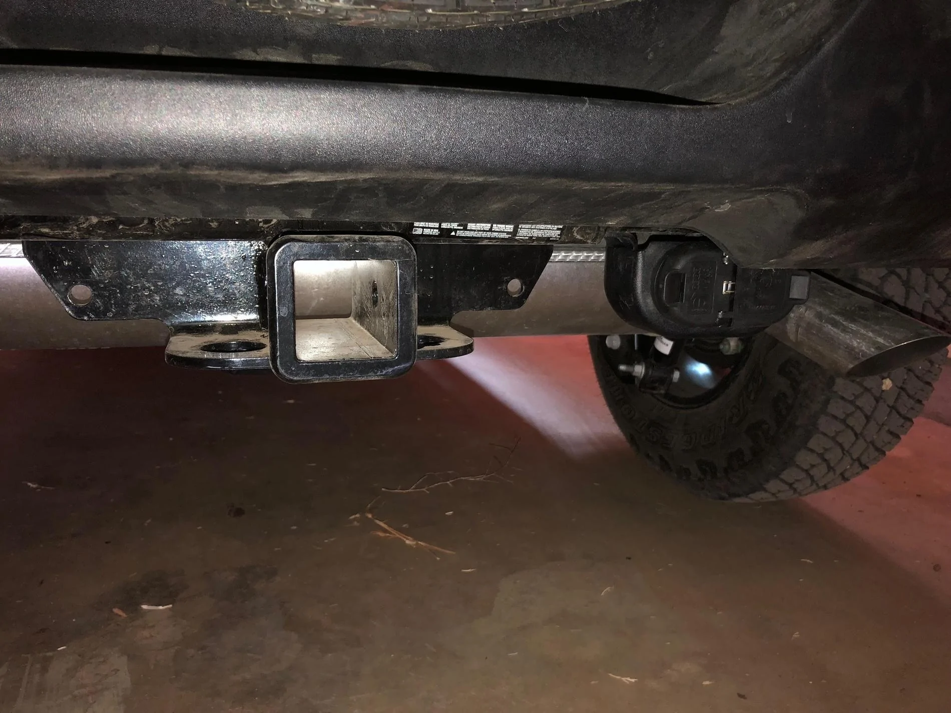

Done with the install. I took me over 8 hours, but I am sure a auto mechanic that had the proper tools could do it in half the time.
The factory mopar hitch must have a built in mounting hole for the 7way/4 way trailer connector housing. There is only one mounting hole on the rear crossmember when using the curt hitch, as it must cover up the other mounting hole. Therefore, I had to get creative and use drill/tap/fasten bolts and make my own holes on the crossmember.
I managed not to break any clips off of any trim, and I took the Jeep over to my boat trailer and verified everything worked properly. One thing I did notice is that when you have to take the passenger front inner fender liner halfway off, you have to cut 5 of the plastic pop rivets off. Strangly, Mopar only gives you 4 to replace the 5 I had to take off. Guess I will have to go to the dealer for the other one.
I am not in any hurry to do this project again. I am interested to see if CraigB used the factory Mopar hitch, or he ordered another brand, and if so where he found to mount his 7 way connector.
Here is where mine ended up: It has a hair clearance for the 7 way hinged cover to be able to open. The hinged cover brushes the bumper when you are opening and closing the 7 way cover. The 4 pin cover is all clear.

It's on the left side, hitch level.
Jeep Wrangler JL Hitch {filename}
Here is a picture of the stock mopar hitch found previously in this thread. Notice how the mopar hitch curves inward so that you can mount your 7 way connector using the holes already in the crossmember. The Curt hitch does not curve inward. FYI to anyone who undertakes this project in the future.
i wonder if the factory mopar hitch only uses the inner two of the four bolts that the Curt hitch used? Almost looks like it.
