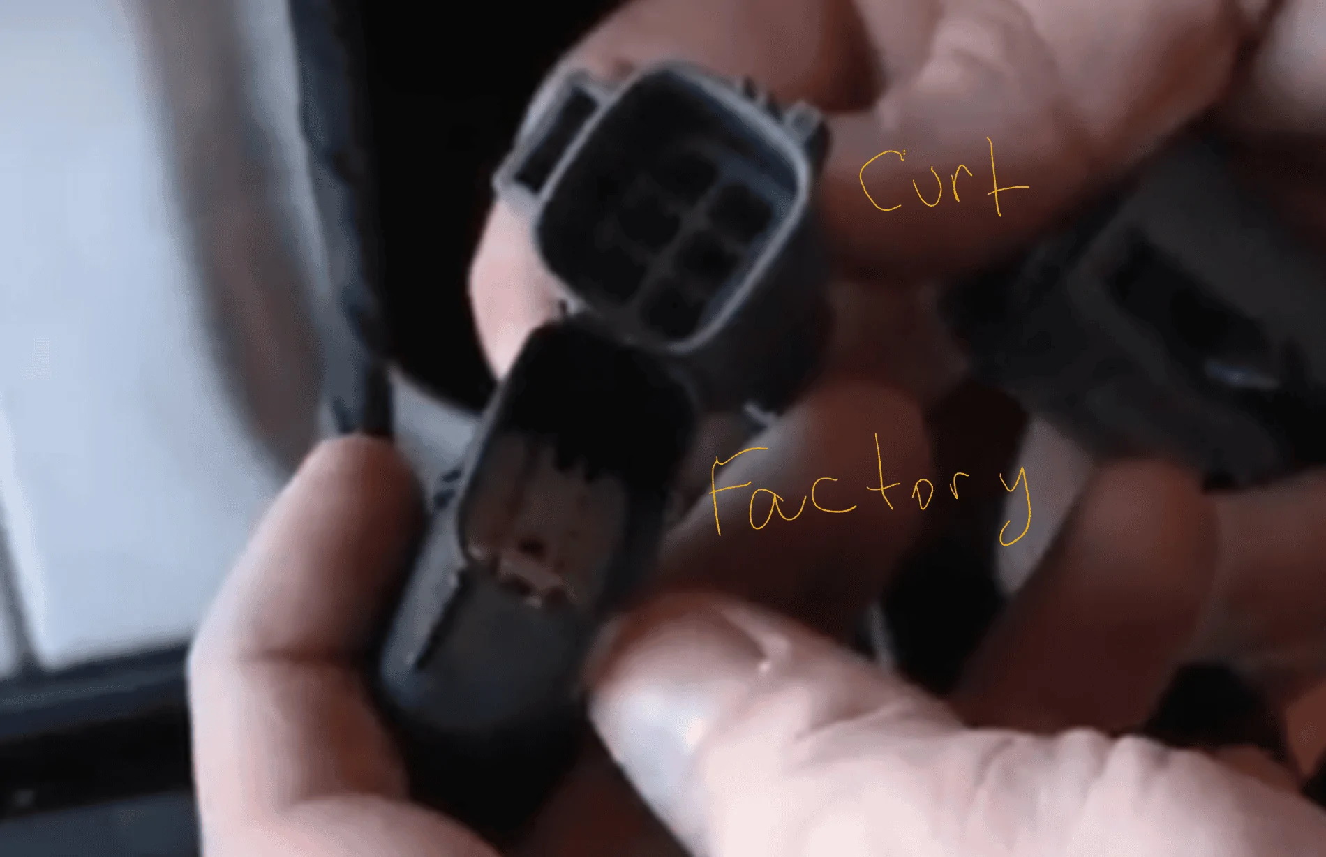

Curt trailer wiring harness plug vs factory plug on the Sahara JL. All I wanted was 4 pin, there is absolutely nothing on the aftermarket currently that fits. I am against splicing into a new vehicle electrical system. I did put on the Class III Curt hitch, works fine. We had a welding burr to grind off, otherwise did not remove bumper and installed in-place.
The factory offers a complete wiring harness, but it is pricey and it takes effort and knowledge to install. It does come with the 7 .prong along with the 4 prong. It fits the JL perfectly.
