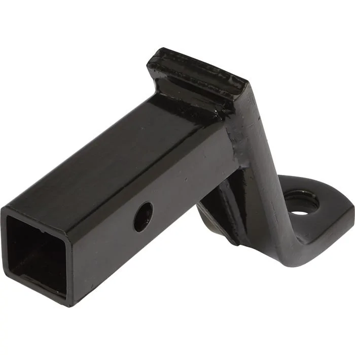

Would I need a drop hitch for towing a car trailer? Or would a standard hitch work?
You would install a regular trailer hitch for the JL/JLU.
Depending on the trailer you may need to use say a 4" or 6" "Drop Hitch Receiver".
Jeep Wrangler JL Hitch dh
You make up for the height difference between your JLU and the trailer with Drop Hitch, receiver/adapter.
Depends on the stance of the particular trailer and the height of the tow hitch off the ground. I use a 6" drop with mine. You park on flat level ground and the end result is you want a level trailer tongue. So, you measure and decide 4" drop, 6" drop or no drop hitch receiver. Drop hitch receivers are not expensive. You can get at Harbor Freight, Walmart. Buy, go home and try and return for credit and get different one if necessary.
Hint: ALWAYS lubricate your hitch ball with marine lubricating grease. Never trailer with a dry, non-lubricated ball.

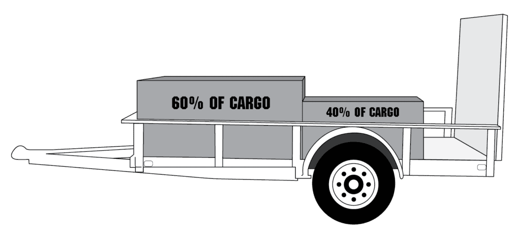

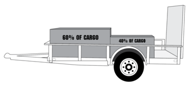

Forgot to mention. You are wise to have say 100 lbs. or so in the cargo area of the vehicle when you go to figure out what drop hitch to go with. Remember, weight in the back of the vehicle makes the back of the vehicle sit lower. Again, very very important to keep the trailer tongue as level as possible. Trailer needs to be loaded 60/40. Should be 60/40 when you go to figure out what "drop hitch" to use.
