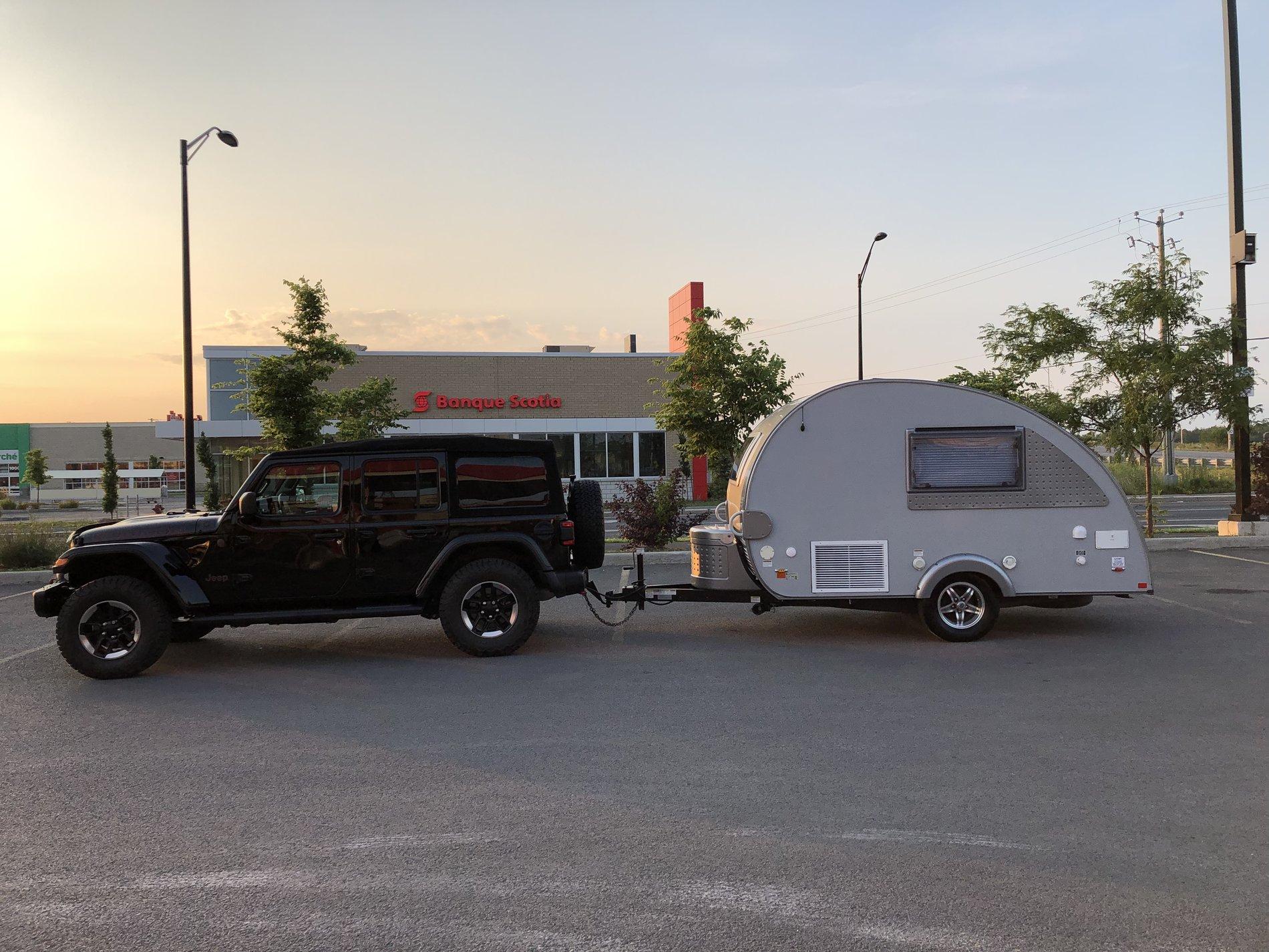

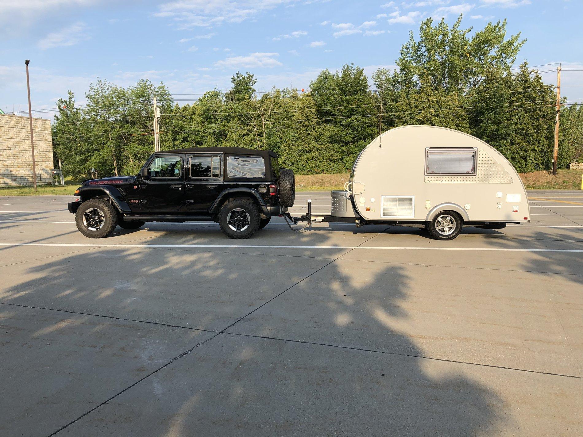

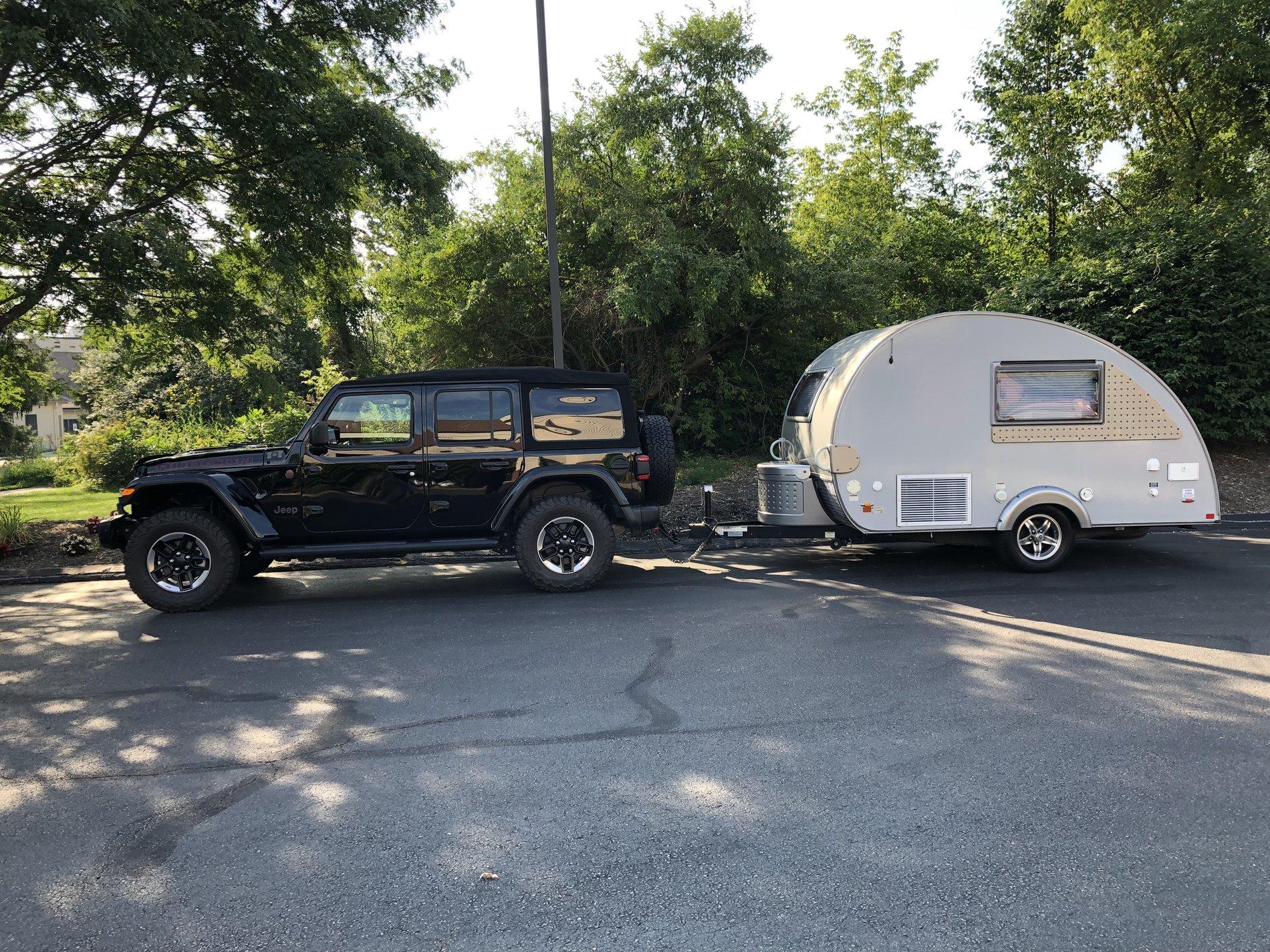

Here it is with an 8 inch drop
Jeep Wrangler JL Hitch receiver drop / T@B 320 Trailer D43C5E14-0CD7-461A-BD2F-848FECDBF3EC
Jeep Wrangler JL Hitch receiver drop / T@B 320 Trailer F6AA1973-16CF-4CCF-8B76-1765B97E070C
Jeep Wrangler JL Hitch receiver drop / T@B 320 Trailer 6B006A3A-5D25-4463-AEC1-F23CD07433B0
