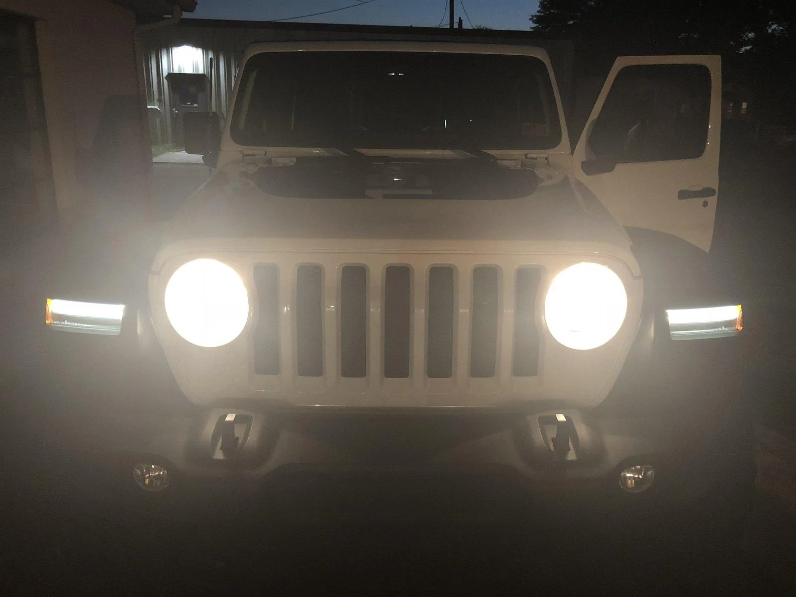

Here just the lights. Once the Tazer gets here, I can then program the DRL function and tell the CANBUS that they are the LEDs.
It’s interesting that the DRL’s turn on with the headlights without the function being programmed, as that is backwards from what should be happening. It’s great that the install was so easy though.

What have you done so far with the tazer in regards to the DRL? you have to set the DRL to on and location to dedicated, then go to your uconnect settings app ->lighting and set DRL to on.
I have it set to
DRL type: USA
DRL location: dedicated
I don’t see an option for DRL in the lighting section of settings.

Try a full reset using the tazer, then check the lighting options again, if you havent.

Hmmm. Best bet may be to talk to joe over at zautomotive then, it should work!
