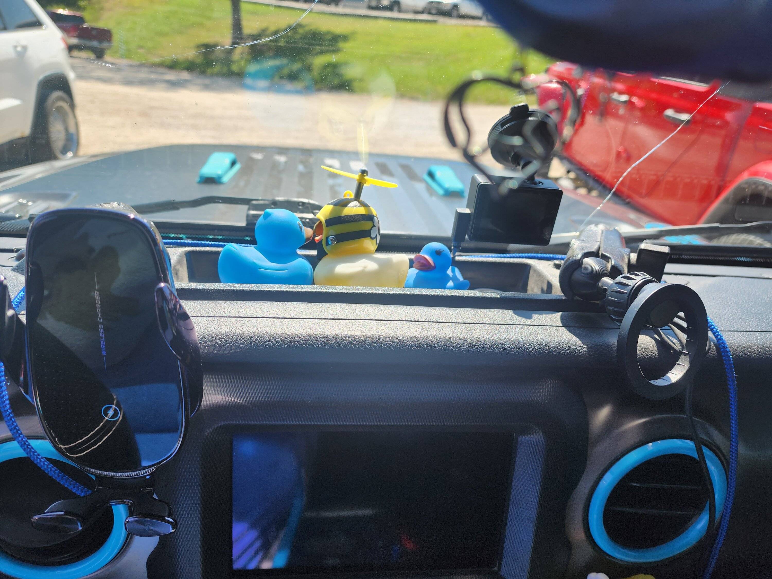

Installed one on each side for USB power to electronics on the dash. Pulled the radio out, dropped the windshield, drilled two holes, wired to Aux switch 4.

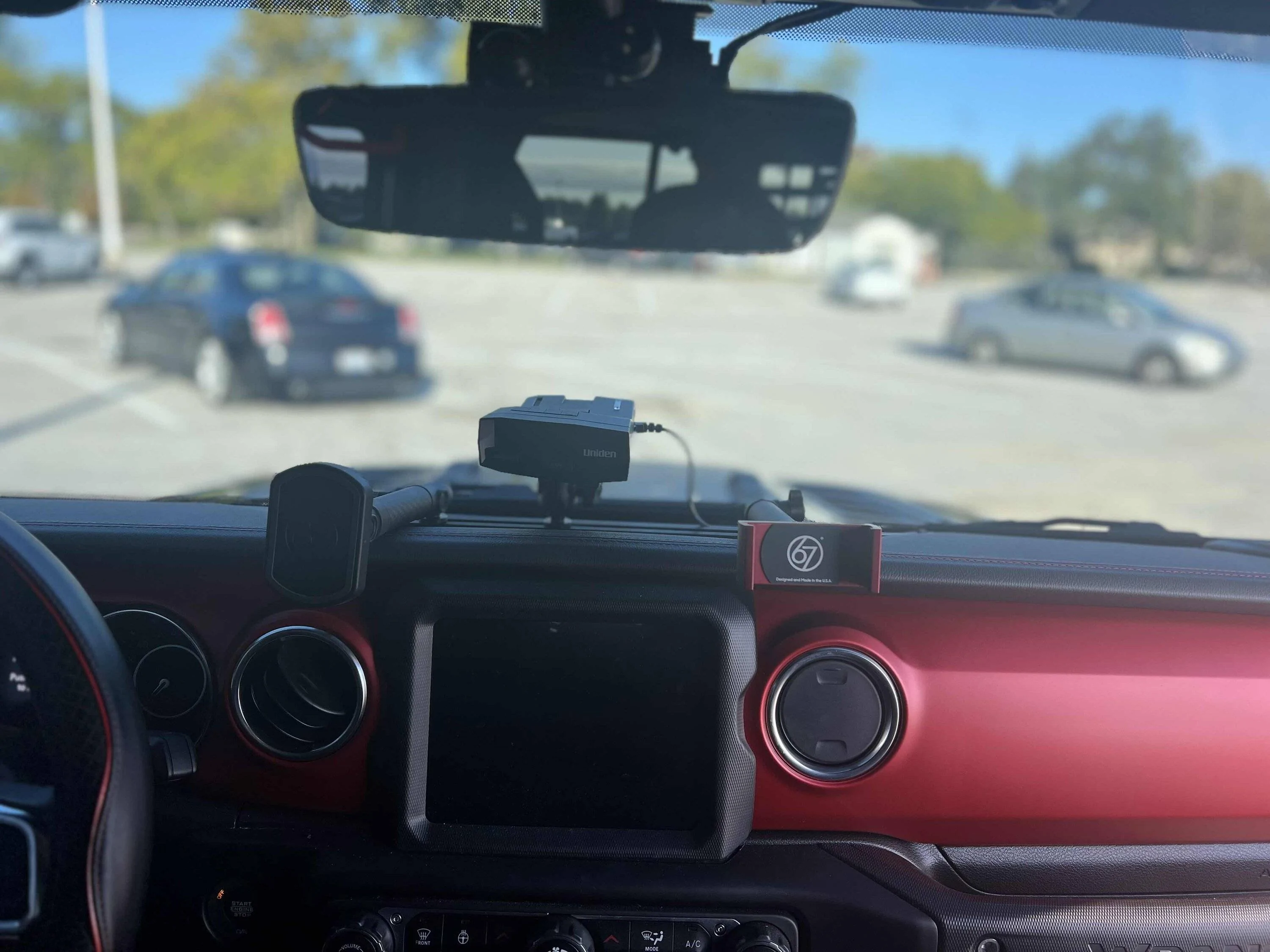

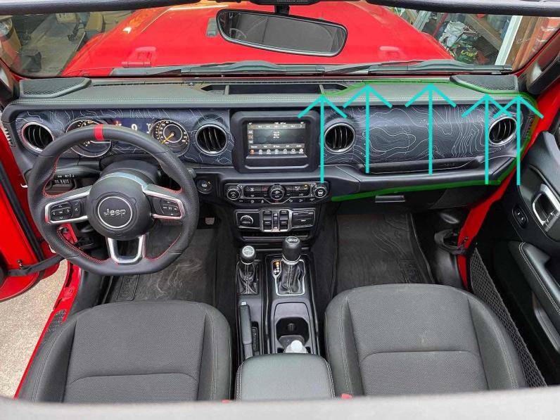

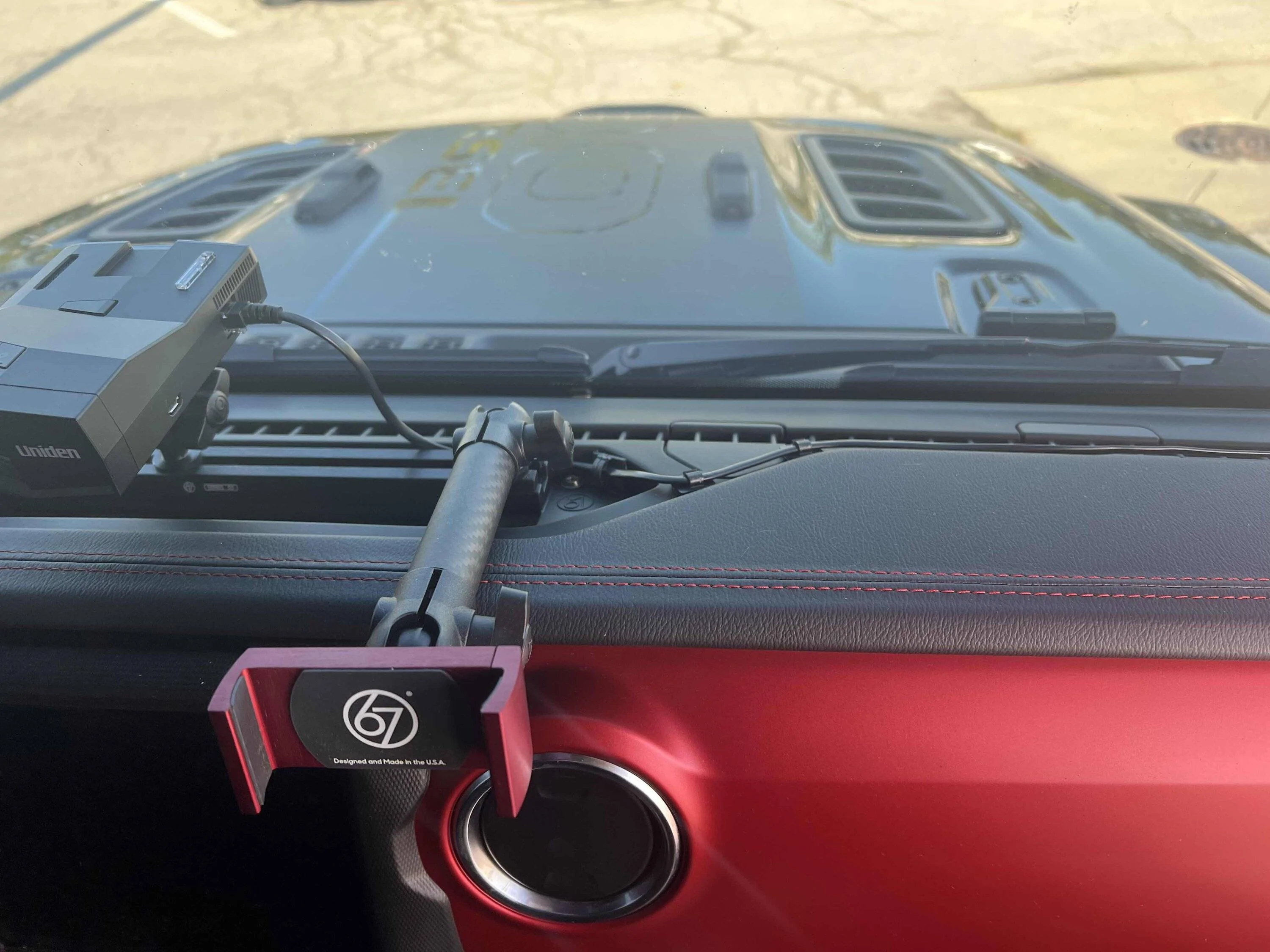

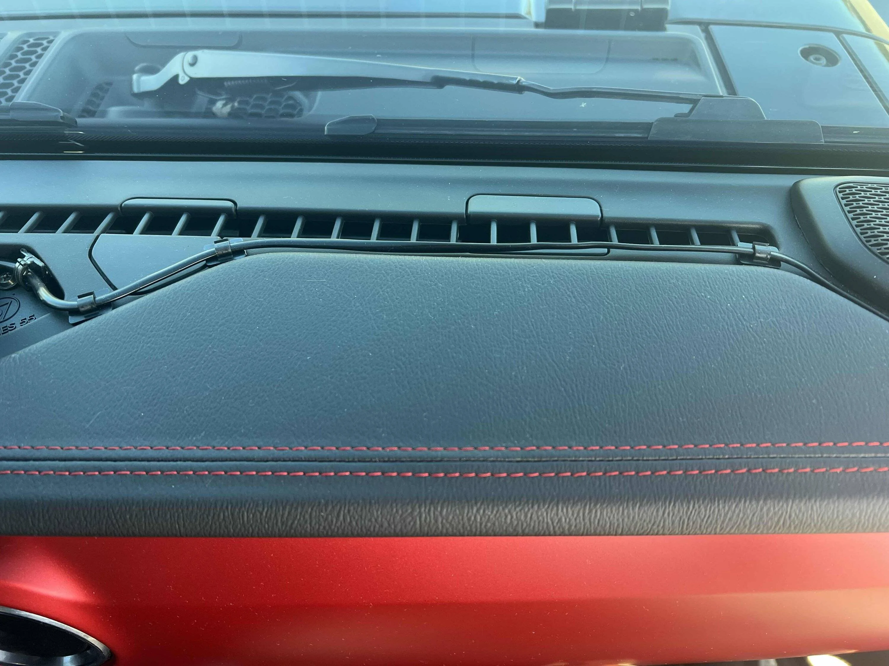

Pulling out the dash, dropping windshield, etc. is much too finical for my liking.
With my radar detector (which sits center dash), I opted to run the cable hidden along the top of the dash.
The leather part of the dash sits about a quarter-inch or so higher than the plastic. Which makes the leather edge perfect for hiding cables.
  • Route cable against leather edge, securing with 3M cable clips where needed.
  • Tuck cable between leather edge and speaker cover
  • Once you get to the A-pillar, tuck cable behind trim pieces / glovebox
  • Then over to your aux cable

That's exactly what I was picturing. It's much easier than trying to take half the dash apart and put back together.
