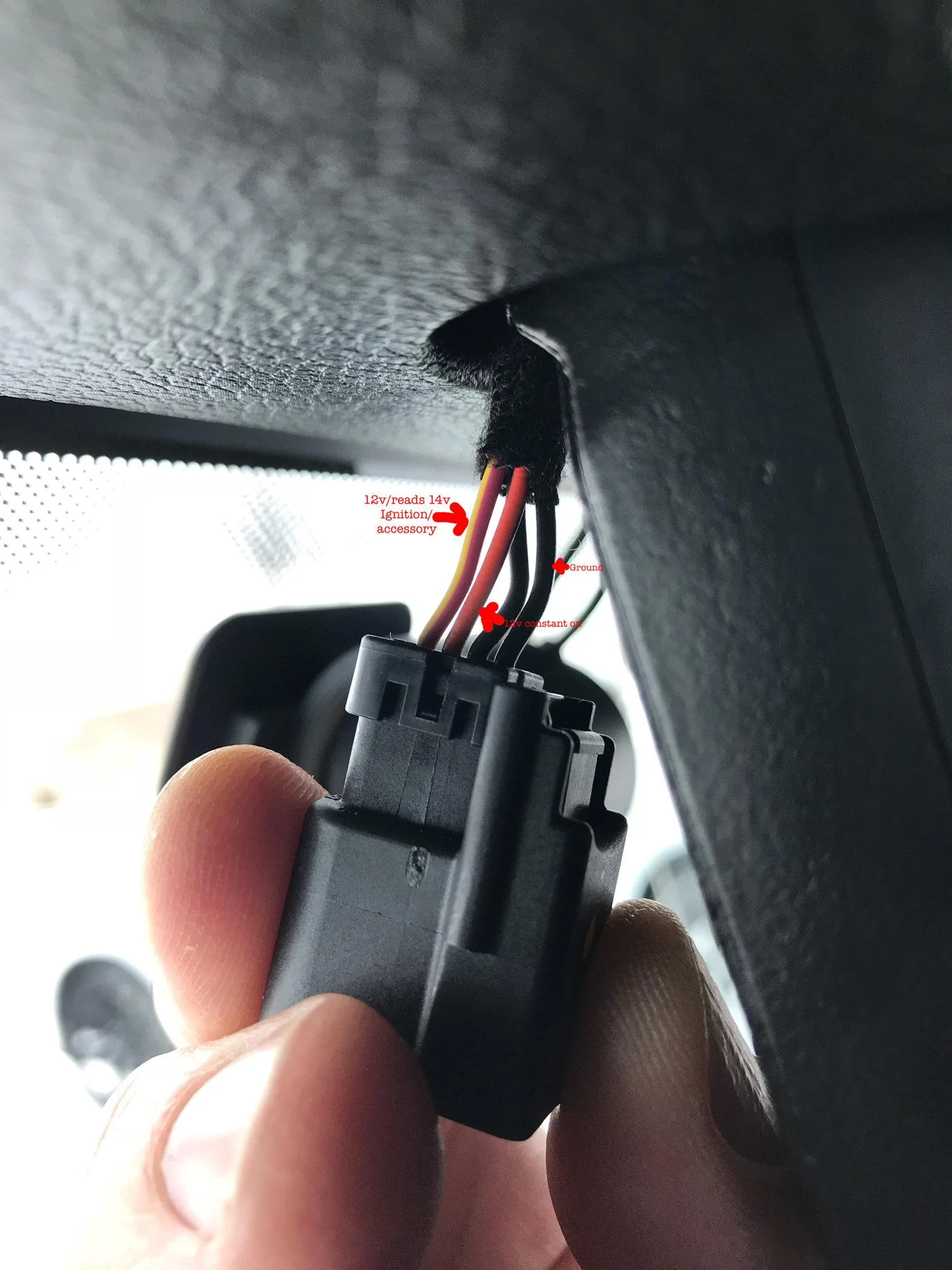

Anyone know which wire is hot and ground in the mirror?

Here is the wire configuration for the mirror.
Warning: if you put to much pressure on the mirror it will pop right off!!!!!! In the dealer waiting to see if they can get it back on!!!

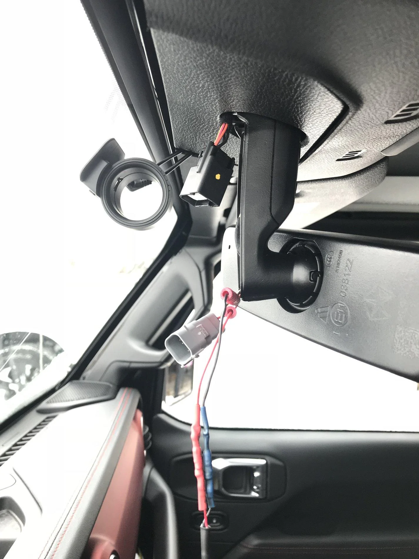

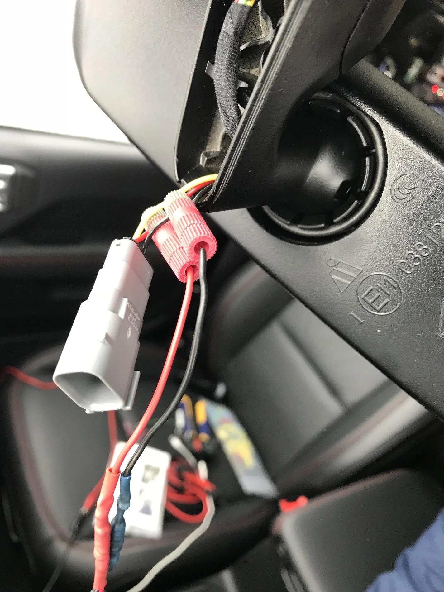

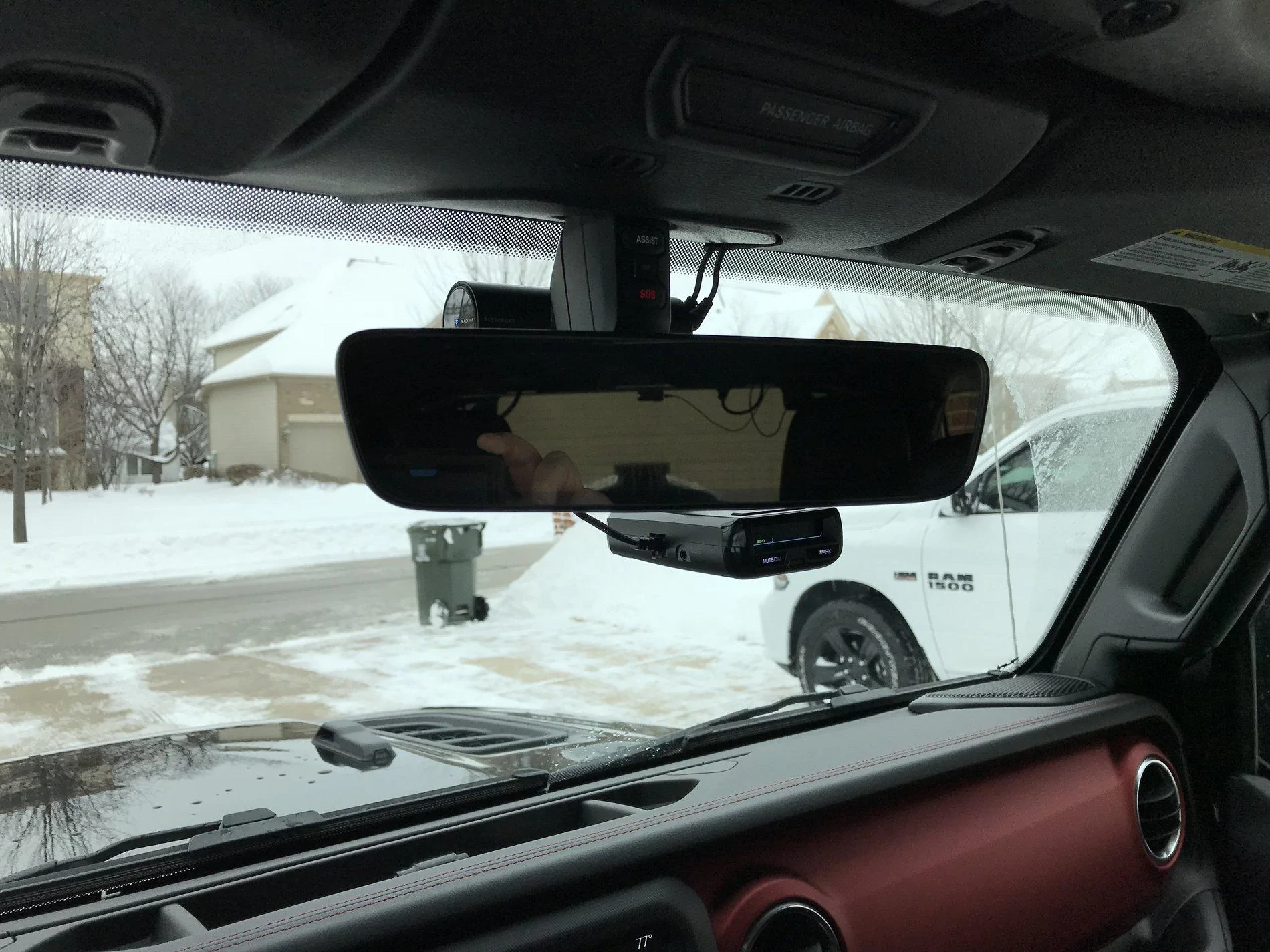

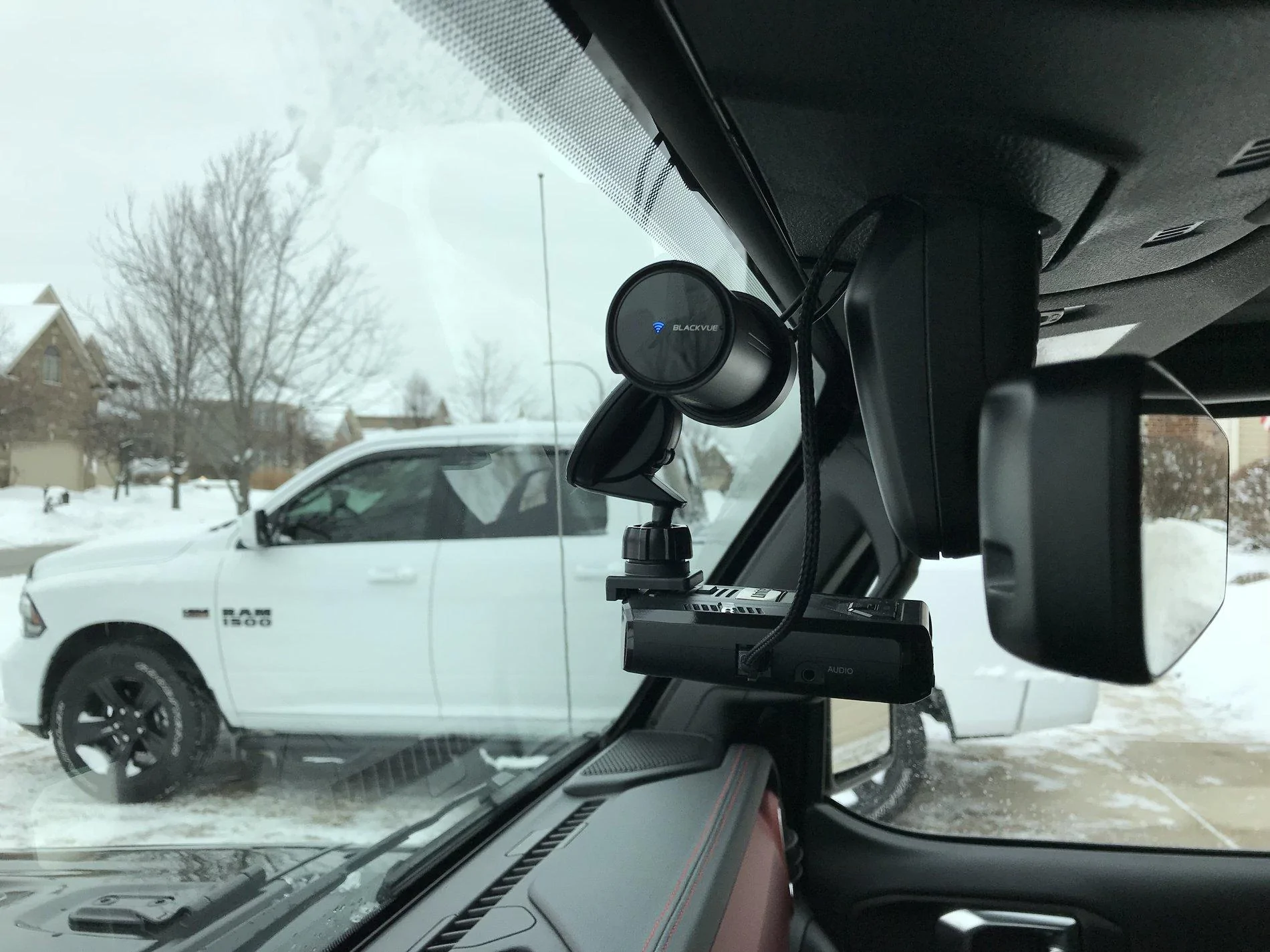

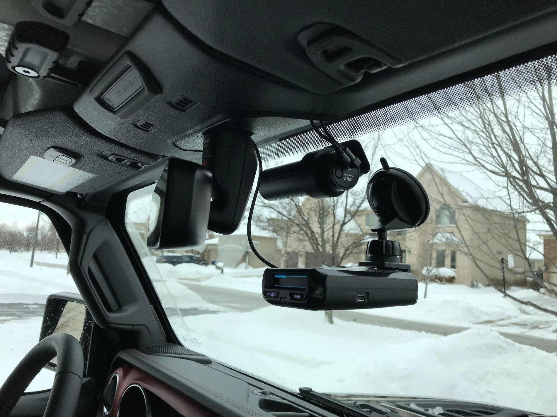

Dealer got the mirror back on. You need a special tool and the mirror needs to be put on sideways and then twisted. James at Zeigler Dodge in Downers Grove is the man!!!! So is their service manager Erick!!!
Got the Radar detector installed. I tapped into the ground and Ignition hot wires but did it from the bottom harness that connects into the harness I have pictures up a few posts that has the wires labeled. You just have to line it up and you will know what wires are what on the bottom harness.
Everything is working great! I used the wires under the glovebox for the dash cam, you can read about that in another thread.
If anyone has any questions fire away! Just be careful with the mirror when putting the cover back on and you will be good to go! If you do take the mirror off, the dealer can fix it easily.
