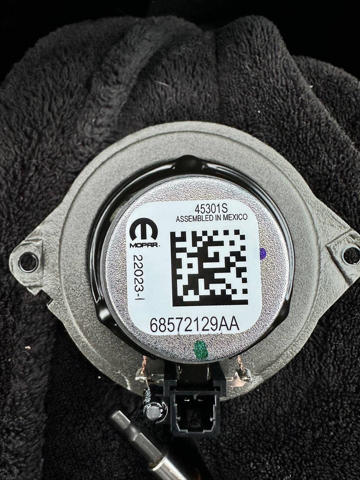

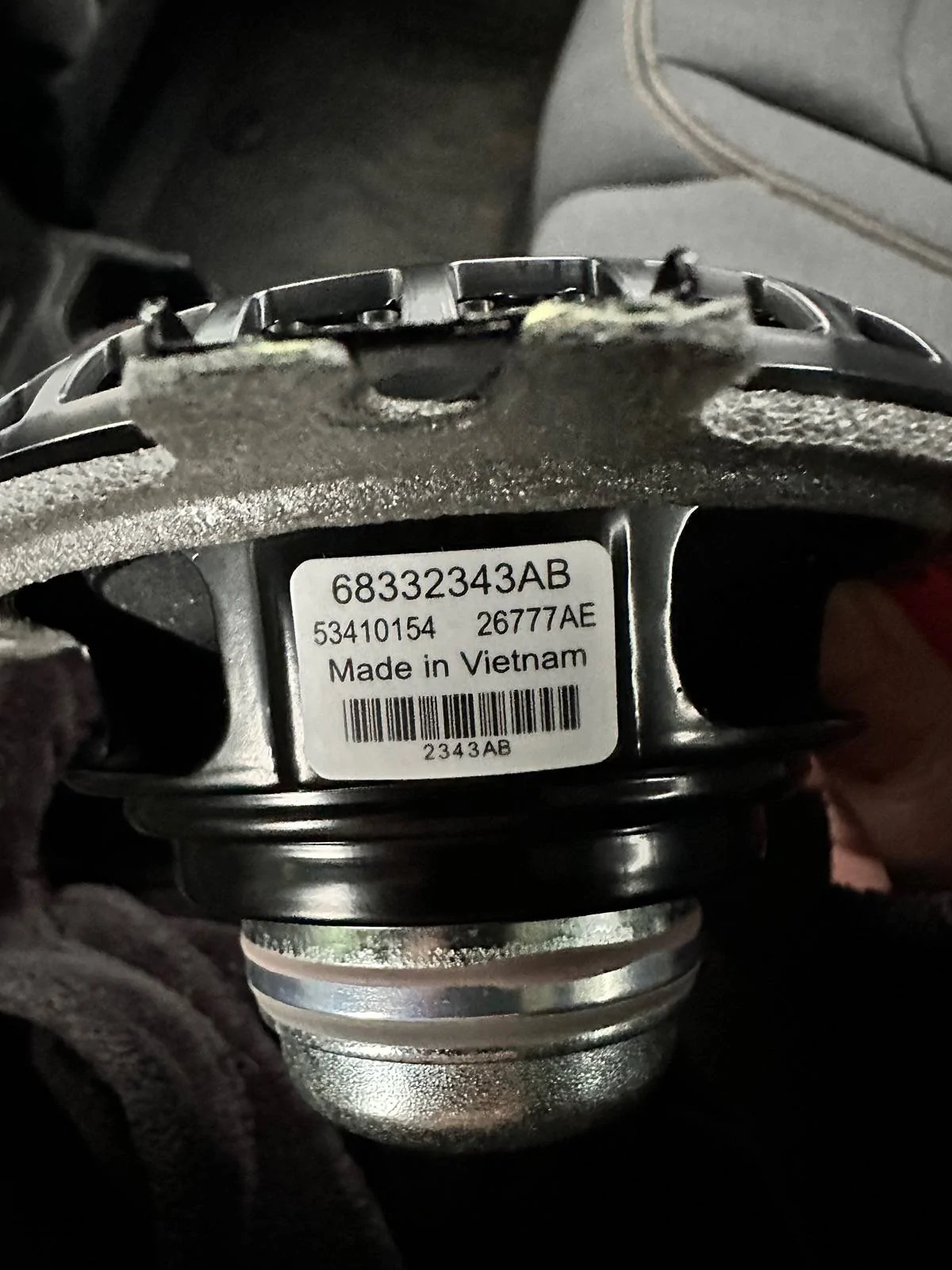

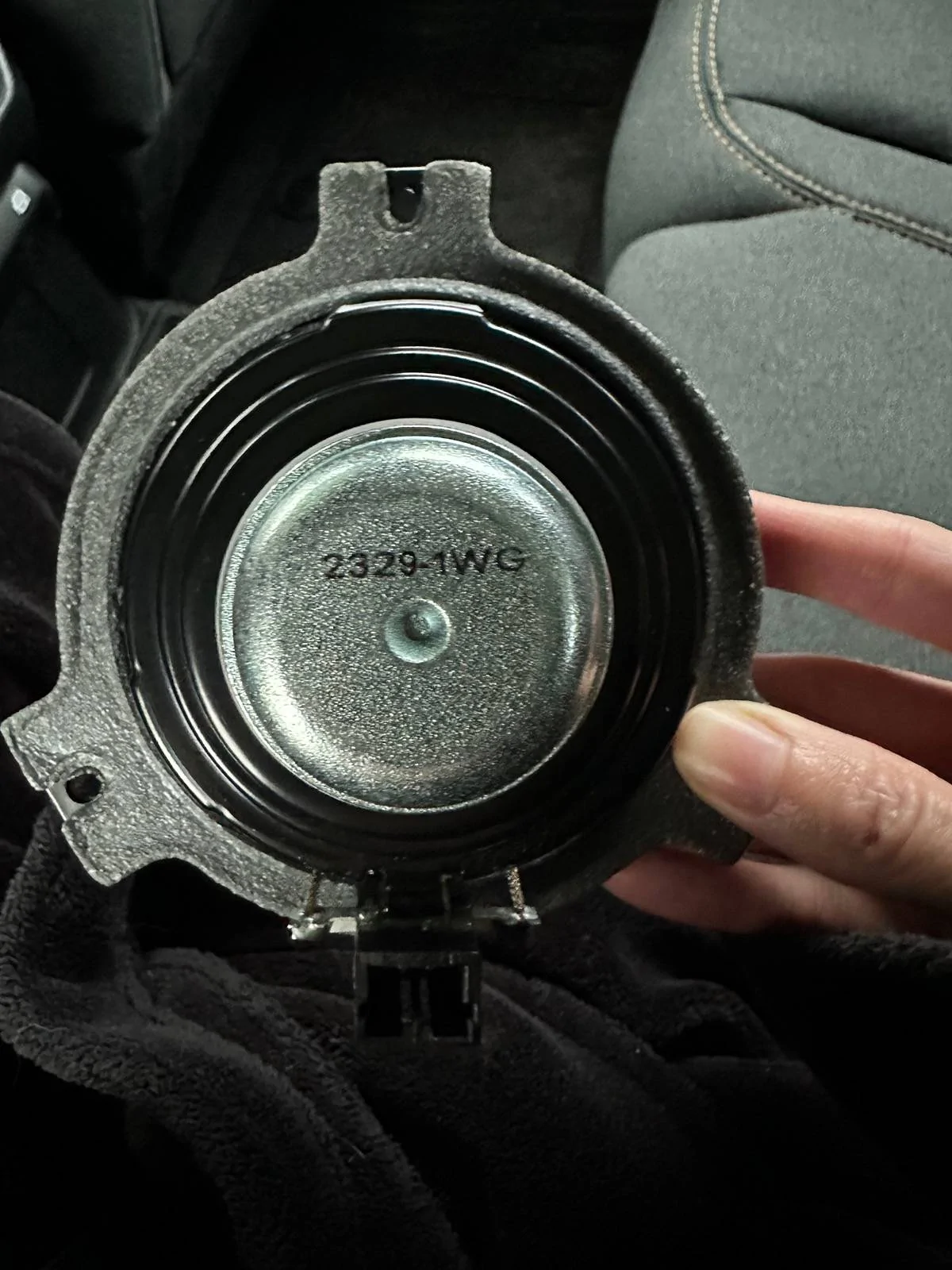

@R3TRO I couldn’t agree with you more and in fact had the front speakers installed with some Kickers - huge difference. The problem is that only one set of speakers (roll bar tweeters) has ohm listed at all and @ 8 ohm. The other two sets I pulled out don’t. With my lacking knowledge it just seemed very dodgy to take the chance without asking others who have experience so thats why I’m here. My husband (who knows a heck of a lot more than me but still not super confident in car audio!) suggested I remove them until we figure it out so I’ve done so.
I cannot find any information online for the impedance rating in the 24 wrangler. I even went as far as to contact Mopar directly and was given a dead end there too.
@lashlee appreciate your response. As I mentioned above, two of the speakers I pulled don’t even have the ohm listed so I’m not sure what to do besides assume they are all 8 ohm. I have to agree with what you’re saying, I feel rather bewildered by the whole thing, but seeing as I already am having a ton of issues with my uconnect system I’d hate to screw anything up and have the dealership refuse to fix it (it’s faulty as heck and needs to be replaced - 6 weeks of hell so far trying to get them to help out there).

@Luna B There is a lot of information available on the forums, most of it will be great!! Some of it on the other hand needs to be avoided. I also understand your husband's hesitation, and as long as he has a digital multimeter he can figure out what impedance any speaker is (in your case they all should be 8 ohm). If he has one he can set the meter to read Ohm's and touch the probes to each terminal on the speaker (it doesn't matter which one, just as long as you touch both).
As for the difference, think of it this way: 8 ohm speakers are like a 33" tire. 4 ohm speakers are like a 35" tire. The 35" tire is a little bigger so you will sacrifice a slight amount of MPG's but you get a slightly taller ride height and the motor may need some additional effort to make them move. Both tires move the Jeep, it's mainly a matter of opinion of what is better. Jeep feels you need 33's, most people go bigger!
Most aftermarket speakers will be 4 ohm. They absolutely will work with your OEM system and shouldn't cause any problems when you change to them. The upside of 4 ohm speakers is that they will play a little louder than what is in there from the factory. Like I mentioned earlier, when you only replace one pair of speakers, the replaced set will play slightly louder than the originals that weren't swapped.
As to why Jeep chose to use 8 ohm speakers is a bigger mystery. Typically most OEM's farm out the stereo setup to audio companies (like Alpine, or JBL (Harman International), Panasonic, Pioneer, etc...) will choose components as an entire system and sell it to Jeep for one price. Typically the OEM will have no idea about why they chose those individual pieces, you would have to talk to the audio engineer that designed it. Typically the OEM's will choose based on cost (considering they are typically buying a huge amount to outfit all of their cars), and what you have in your hand is the cheapest thing Jeep could put in there. When the engineer is tuning the system, he might use some filters (crossovers) to protect the speakers or use other audio tricks to make it sound "good" (like an EQ or swapping the nominal polarity of a pair of speakers).
Hopefully this isn't too much information, but maybe give you information for when you continue your journey for a better sound. I have designed and installed systems for decades in various cars and there are many aspects that go into each and every one of them.
