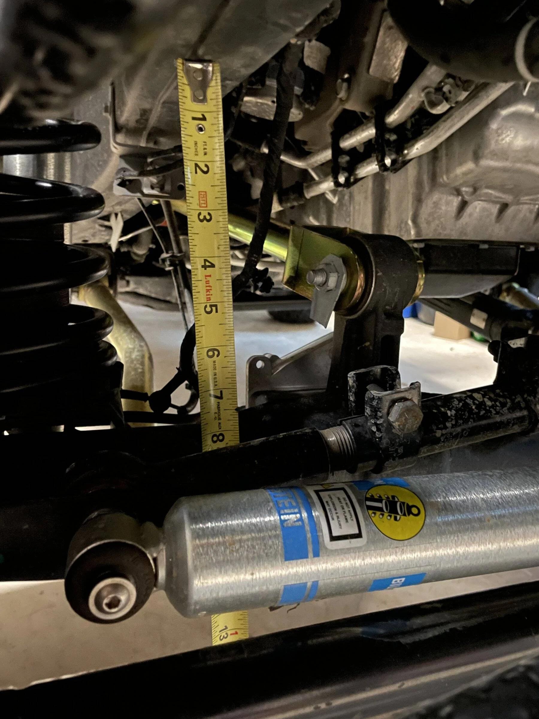

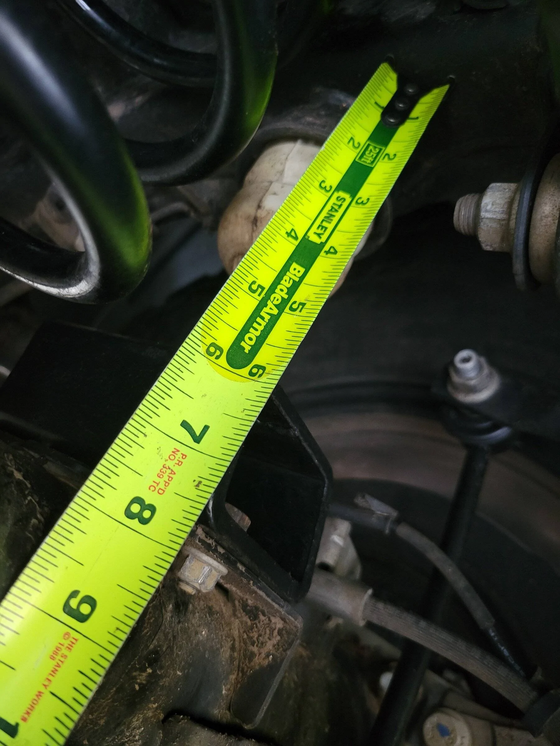

i know you measured wheel to fender distance but can you also measure the shaft of the rear shocks at ride height so we can see how much down travel you have based on your shocks? Or are you unable to measure the length of the shaft because the mopar shocks have roost shields that cover the entire shaft?
Couldn't measure rear shock shaft. Measured top of axle to bottom of frame front and back. I'll try to find a stock 4XE Rubi to compare
measure shock length at their mounting locations. (bolt to bolt). front and rear. That's gonna tell you where you are at compared to regular rubis with the mopar lift, and if adding spacers or longer coils could be detrimental to ride quality.
Look at your lift as a whole system instead of "how tall my Jeep is". Because that's what matters, really.

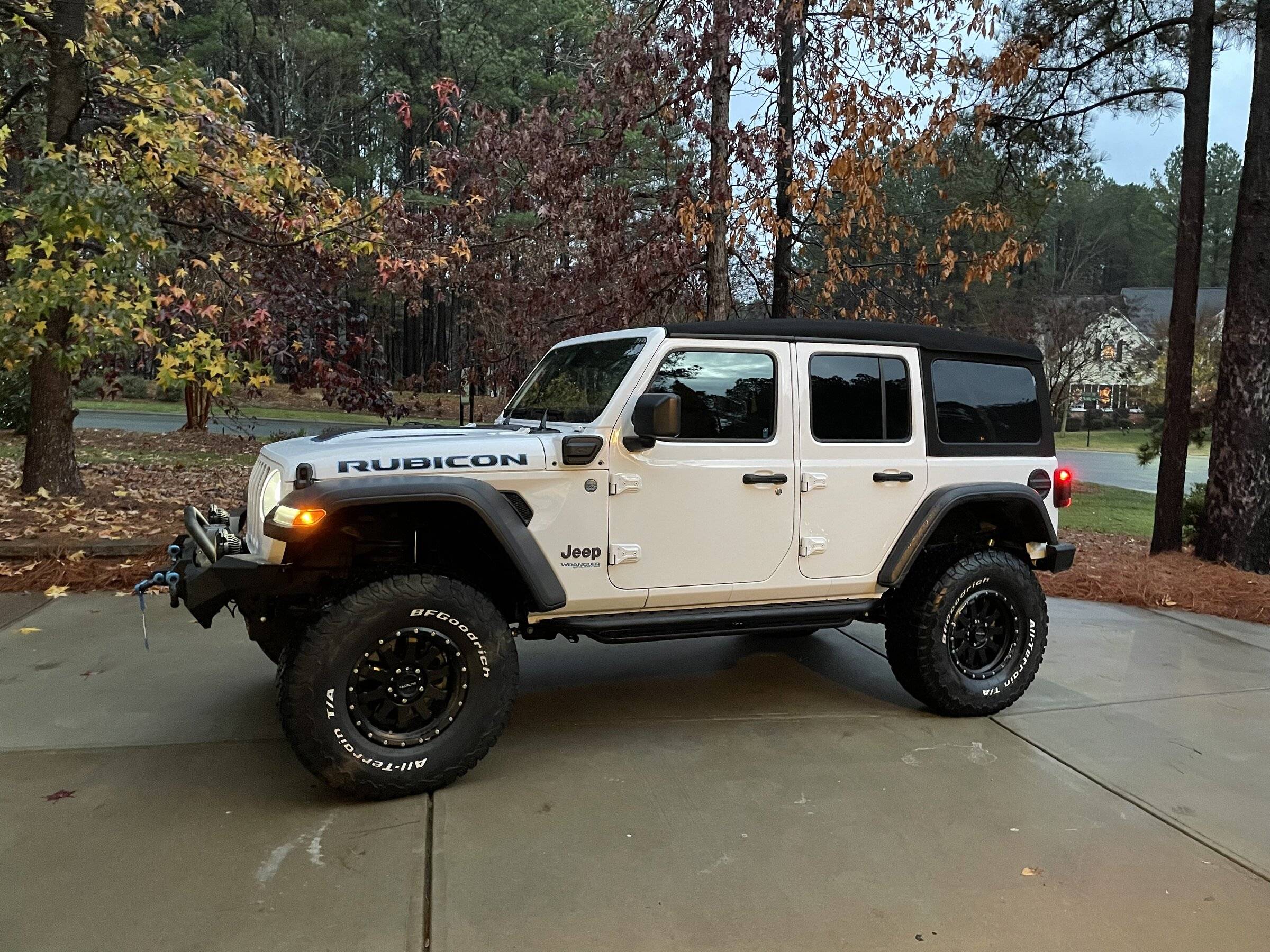

We’ll, I guess some math would be in order, but this is the front with my lift, my shock eye to eye is 24.25”.
If it’s 2” more than yours, (8 vs 6) puts yours just over 22” shock length. Which is where I was with 2” spacers after 4 months of settlement.

OK, is that center of the bolt in the eye or full length, top edge to bottom edge? My center of eye bolt top to bottom is 21" in front. I don't have that measurement from the first lift.

Center to center
