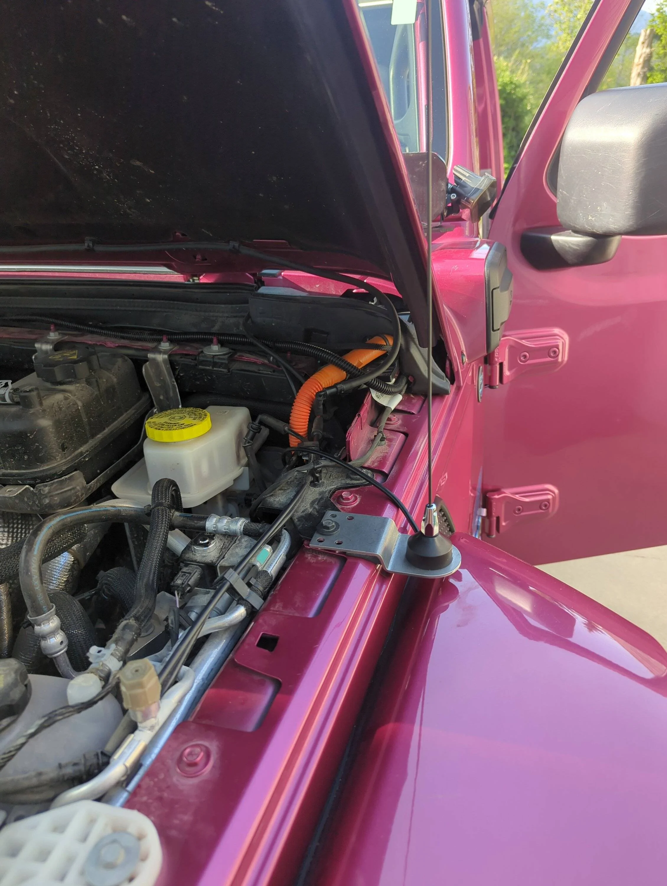

I have already purchased my antenna and coax cable.
I purchased the antenna, Super Elastic Signal Stick from Signal Stuff and the Topsy NMO mount (bundle). (I cannot really install a tall antenna due to the clearance issue with my garage).
I am installing the antenna on the driver's front of my jeep and wire the coax cable through the hole on the firewall.. (see photo)
Honestly, because I have a 4xe, and my Jeep already has too many extra wires that a regular ICE doesn't have. I am a bit worried if there would be interference. I rarely see any post with 4xe owners installing a ham here.

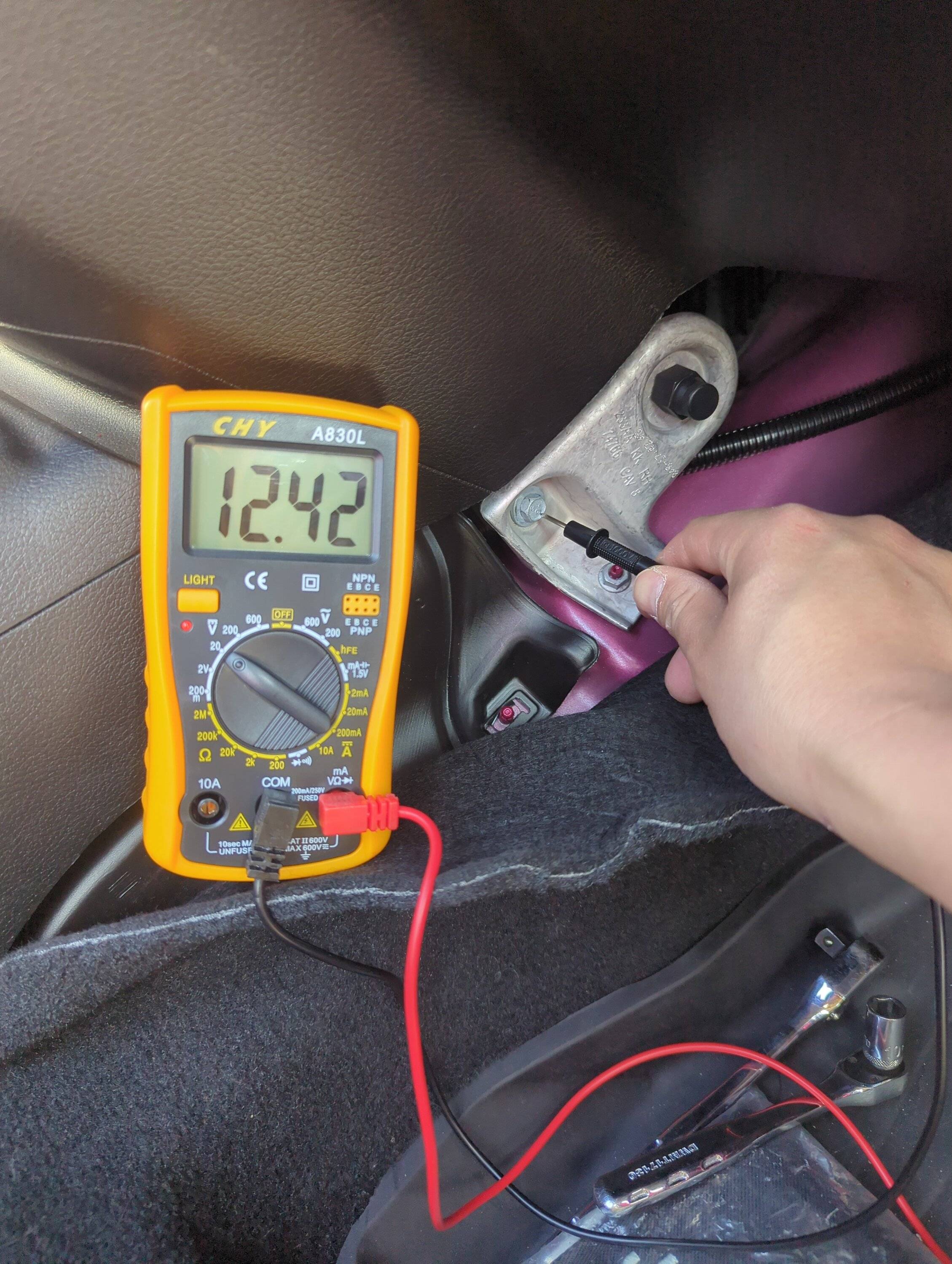

Anyway, I am installing my radio under the driver's seat, (I already have an ARB compressor under the passenger side).. wire the positive and negative leads to the footwell of the passenger and connect to Aux 2, with the original 15A fuse and the negative to the sidewall bolt near the door (at the footwell) without the fuse.
I have also tested with a multimeter and found that I could actually this bolt (under the carpet and the center control..) well at least there is a 12V current.. but unsure whether it is safe. (See photo pls).
Regardless, I will test this setup first and see how it goes, especially that I am a new ham, I am not worried about screwing up (as long as my jeep doesn't burn).. I need to learn knowledge through all kinds of experiences.
I mean, because I have already hardwired my winch, dometic fridge and powersteps to my 12V battery, I am thinking perhaps it would be better to either install a dual battery system under the hood, or a redarc type of system in the rear and power my radio from the back.
I mean I feel like I am stressing my 12V battery.. btw it is not stock, I have already upgraded to an odyssey.

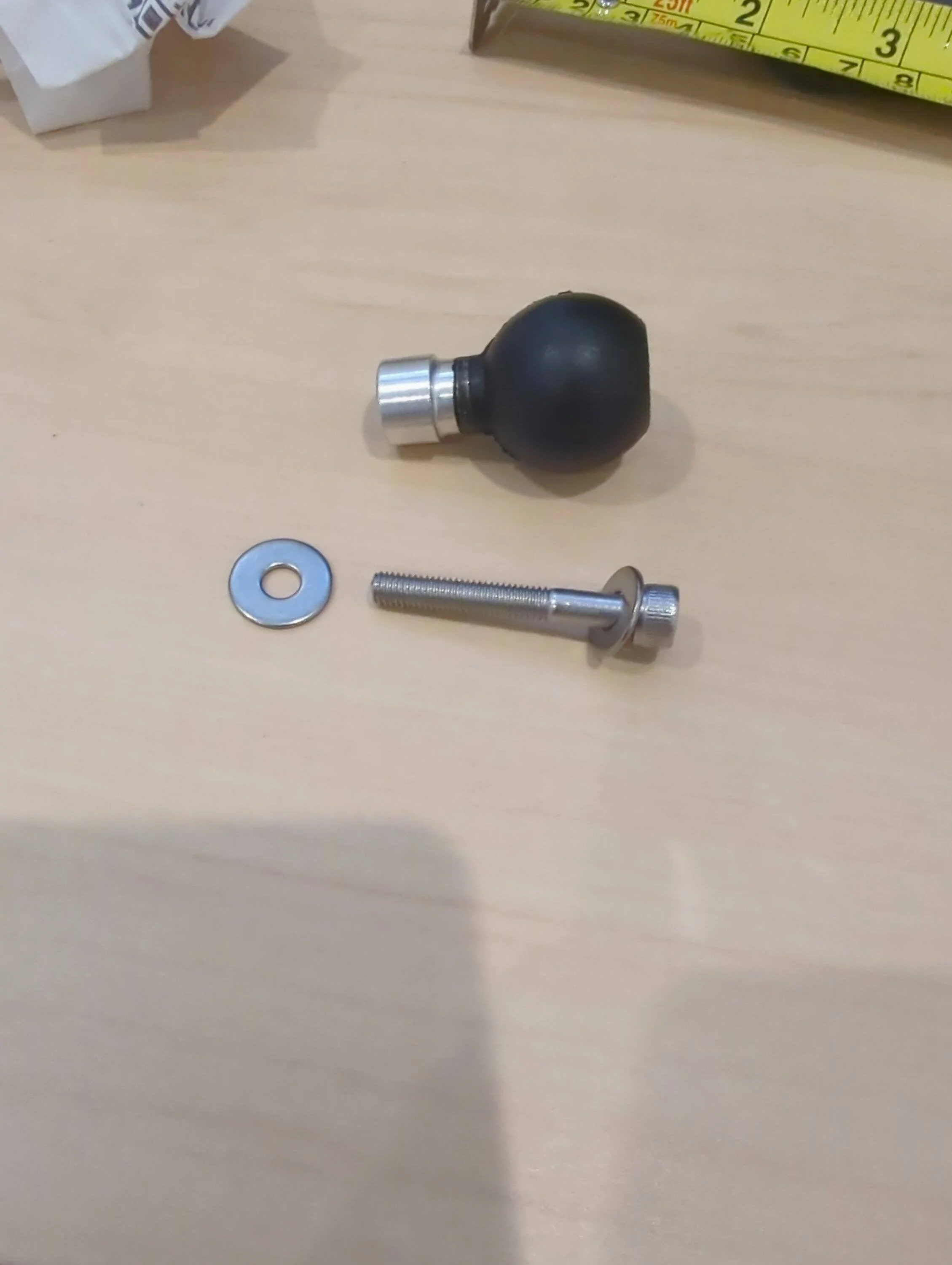

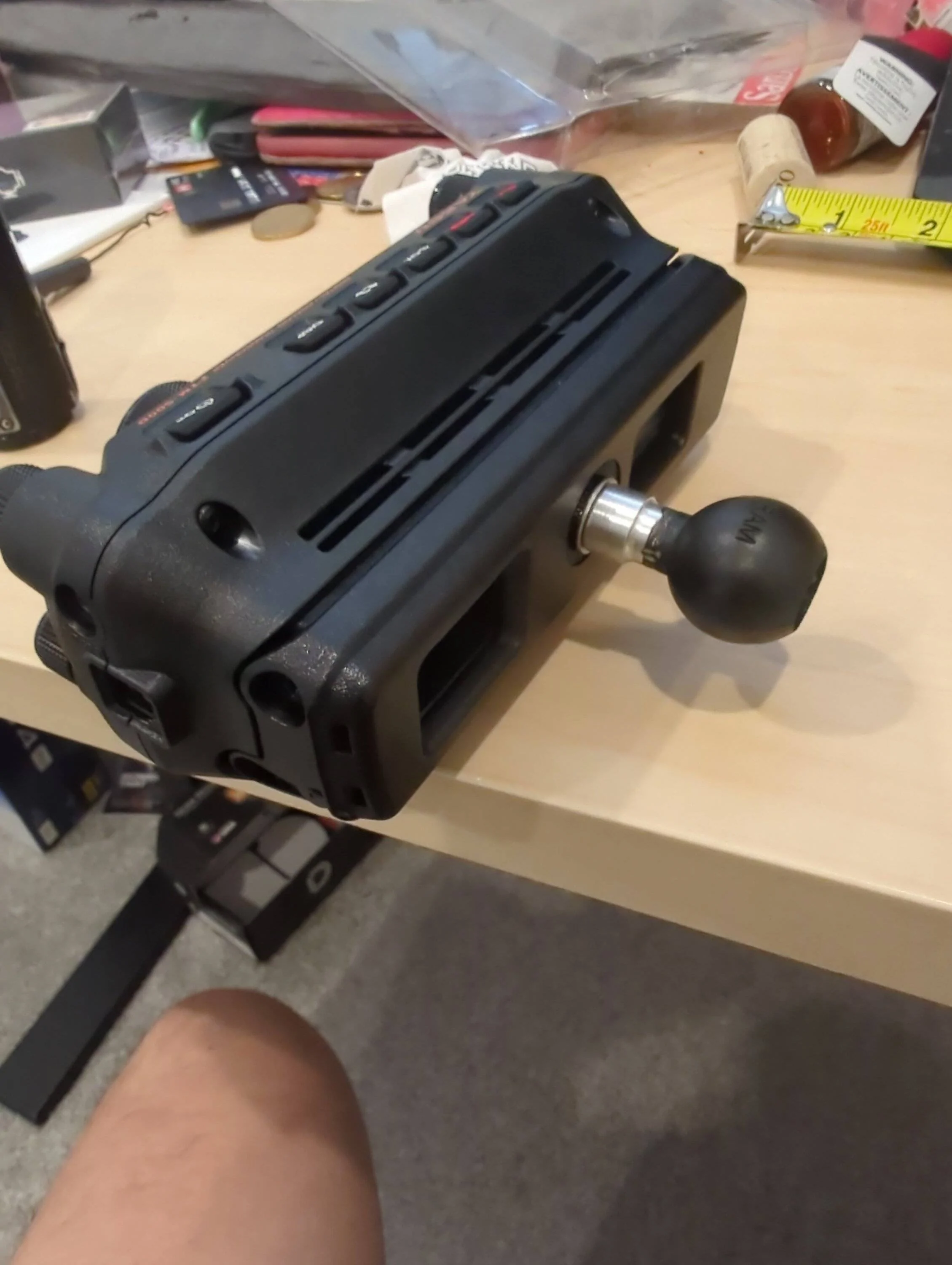

Tks, now everything is installed, I am just waiting for the 10ft control head extension cable that I didn't know I needed.
I got this 1" ram ball, and a m5 x 35 screw bolt and some washers (I learned from another site).. see photos.. and is connected to the back of my radio.
See photos..
Let's see how this works.. I am a bit worried still because the face (head) of this radio is huge.
