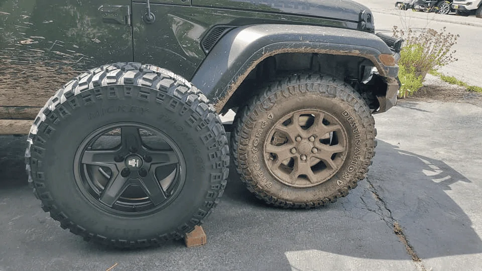

Now that the tires are in, I finally know what size I actually purchased. The site made this somewhat ambiguous. I ended up with the 315/70R17s. Adjusting my calculator accordingly, and looking at the ratios, it turns out this is going to be an interesting experiment.
New shoes:

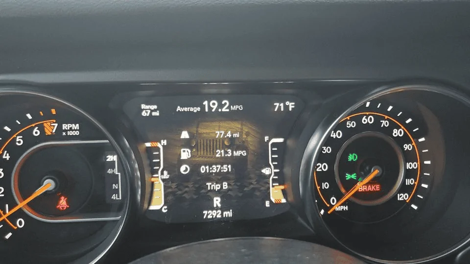

First of all, I continued my 4th gear experiment tonight. Today wasn't even an ideal fuel economy day, and I drove pretty aggressively. I never shifted beyond 4th gear, and I got 21.3 mpg for the loop. That's crazy! That's a lot better gas mileage than I was getting using 5th and 6th.

So what makes all of this really interesting is the overdrive effect. Right now on my 32s with my 3.45s, if I'm in one of the overdrive gears, the engine is trying to push a lot of gear with very little torque. I feel the good fuel economy in 4th is due to this being the direct gear, AND due to more torque due to higher RPMs.
If I regear to 4.56, I move the RPMs at 70 to a different gear ratio, an overdrive gear. Overdrive gears are taller, and harder to turn, so my current experiments running in 4th are not that great of a predictor of what I should expect after regearing.
Now the fascinating thing here happens after I update the gear calculator to the final tire size, and try that with the 3.45 gears I currently have.
3.45 gears, new tires, 4th gear at 70 mph: 2359
4.56 gears, new tires, 6th gear at 70 mph: 2245
Given that overdrive gears are taller, and harder to push, and given that higher RPMs deliver more torque, an overdriven 2245 might be harder on the engine than a direct 2359. I might actually get better fuel economy if I continue to accept that 5th and 6th gears are just useless in the Blue Ridge mountains, and don't regear at all.
Of course, this ignores the issues I will have at the other end of the spectrum. If I don't regear, I will be crawling a lot faster down on the low range. An extra 40 feet per minute faster. That's pretty significant.
In any case, putting on the big tires and leaving the stock gears will probably have worse impacts in my off-road experience than on my commuting gas mileage, as long as I continue to drive it like a 4-speed. I should have the option of running on 3.45 gears indefinitely. As far as getting to work and getting the bills paid, it shouldn't massively impact my weekly gasoline budget.
