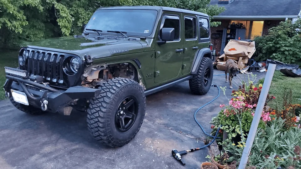

That feeling when you turn on your monitor, see a picture of a cool Jeep, and realize it's YOUR Jeep. Mickey Thompson Baja MTZ P3s. These were not even on my list of tires I had under consideration, but they most likely will be next time I'm on the market for tires. They seem pretty damn good so far.
I programmed the new tire size, and now all I have to do is figure out the spare tire deal, and change out my turn signals to something that actually fits my new fender flares. Hopefully I can get a little cash toward the regear when I sell the OEM wheels and tires.
So, I know my commentary is going way off the topic of my thread, but to those who have followed me this far, I wonder how many think I should get the tires flipped to put the white letters out.
I'm going with high clearance totally OEM-looking flares, and the aesthetic of this build is kind of low key instead of blingie, but I think the white letters might be just the right amount of bling to offset all the matte black stuff.

Meh, my sidewalls take a lot of abuse. I vote leave them facing in. White seems like it wouldn’t go with green and black anyway.
That's a fair point. White letter tires basically have a white core with a thin layer of black rubber on the outside, and that layer can peel off pretty easily.
I kind of liked the white letters on the factory tires, but then I kind of liked the factory wheels and tires until I laid my eyes on these things. The wheels are pretty common and cheap, but I really like how they look. Especially on this Jeep. Low key. Not too flashy. Easy to hose off. No fake beadlock simulators. Just a good looking wheel that's cheap enough I can thrash it and not worry about rock rash, because they're going to get rock rash.

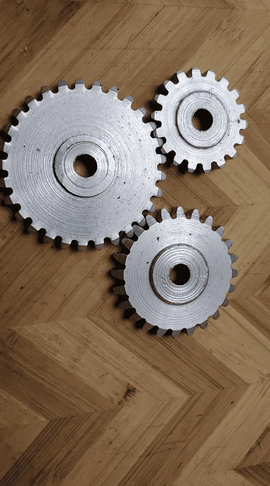

For whatever it's worth as a data point, the most precise and complicated thing I've ever done in a shop is make some test gears.
