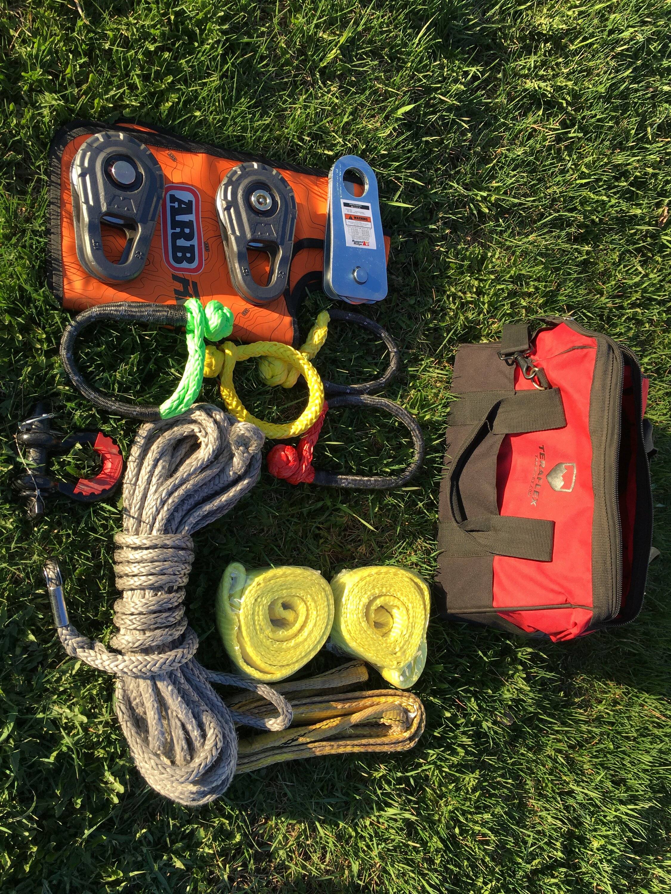

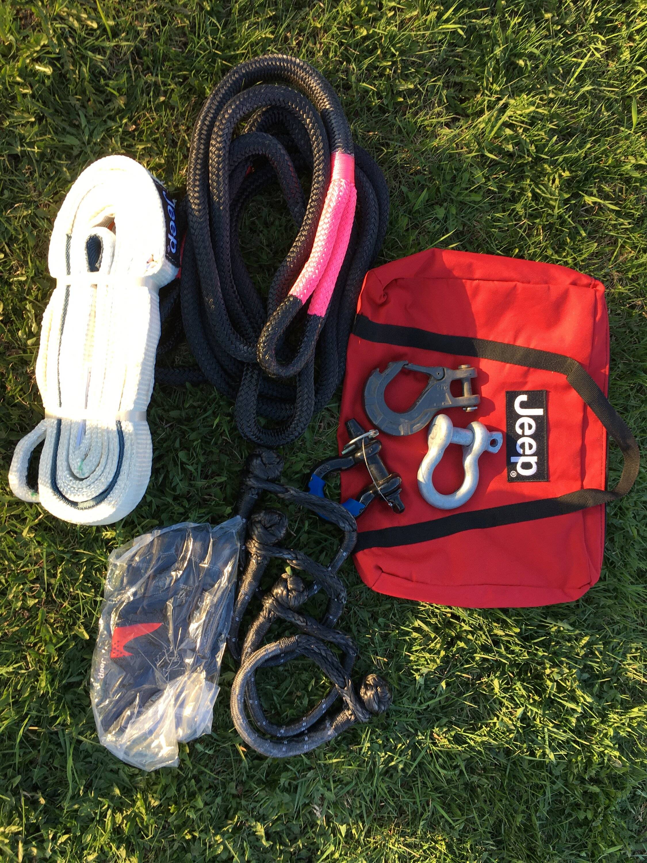

I don’t have time to go through all the posts to see if anything may have been missed so I will give you 2 lists that I pass on to all new Jeepers in our club.
Winchless recovery kit:
Tugging (non winch) gear bag includes:
1 - 3/4” x20’ Kinetic rope
1 - 2.5”x 20’ recovery strap
3 - soft shackles or D ring shackles
Winching gear bag.
Suggested recovery gear bag contents:
Winch gear bag includes:
3 - snatch blocks or snatch rings for synthetic
50’ - Winch line extension
4 - D rings or soft shackles
3 - Tree savers.
1 - weighted winch line safety mat.
This will get you out of most anything.
Winching gear bag.
3 - Tree savers.
Good kits. I need to get another tree strap and a winch extension. But, my tow strap and kinectic rope can do double duty as an extension for now.
I ended up getting rid of my steel snatchblocks and chains in favor of soft shackles and aluminum winch rings. I'm trying to minimize the steel in my systems and lighten the gear I carry.
