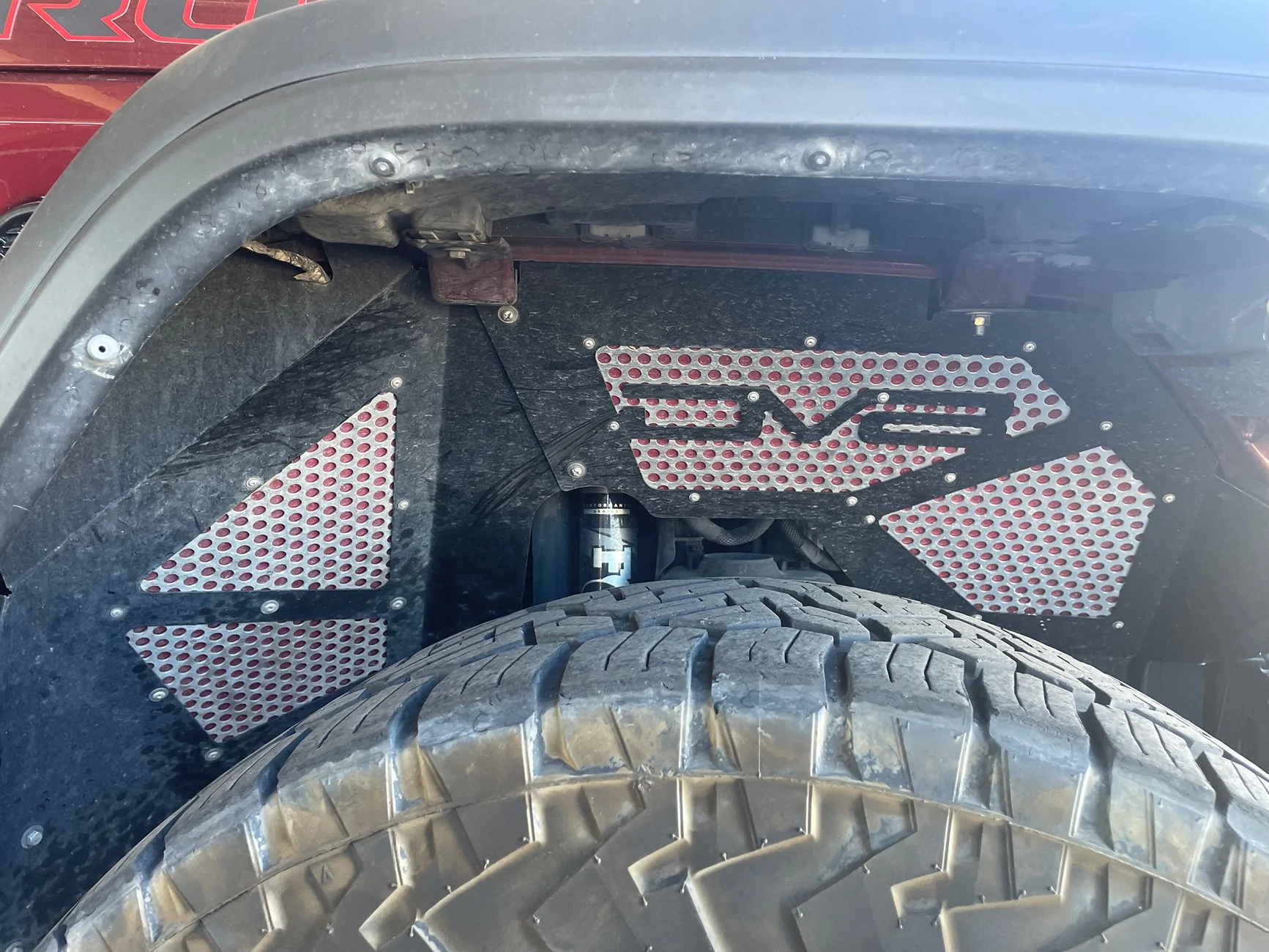

Could go aftermarket like DV8 company.

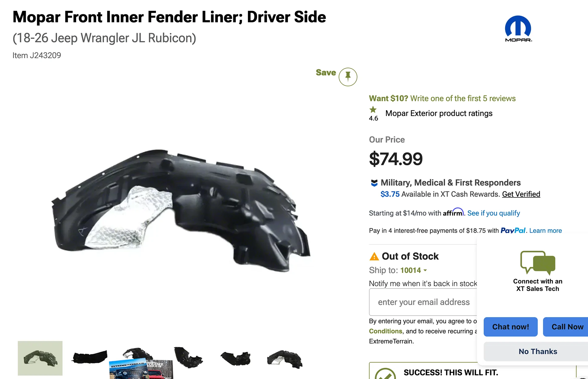

Inner fender liners like the ones pictured below, right? I had to change one recently. Got an open box on Extreme Terrain for ~$60., Item J243209.
You need both sides. so yeah, like Megawatt is saying, I like the idea of aluminum as well.

Go Aftermarket: DV8, Cavfab, Motobuilt, etc.

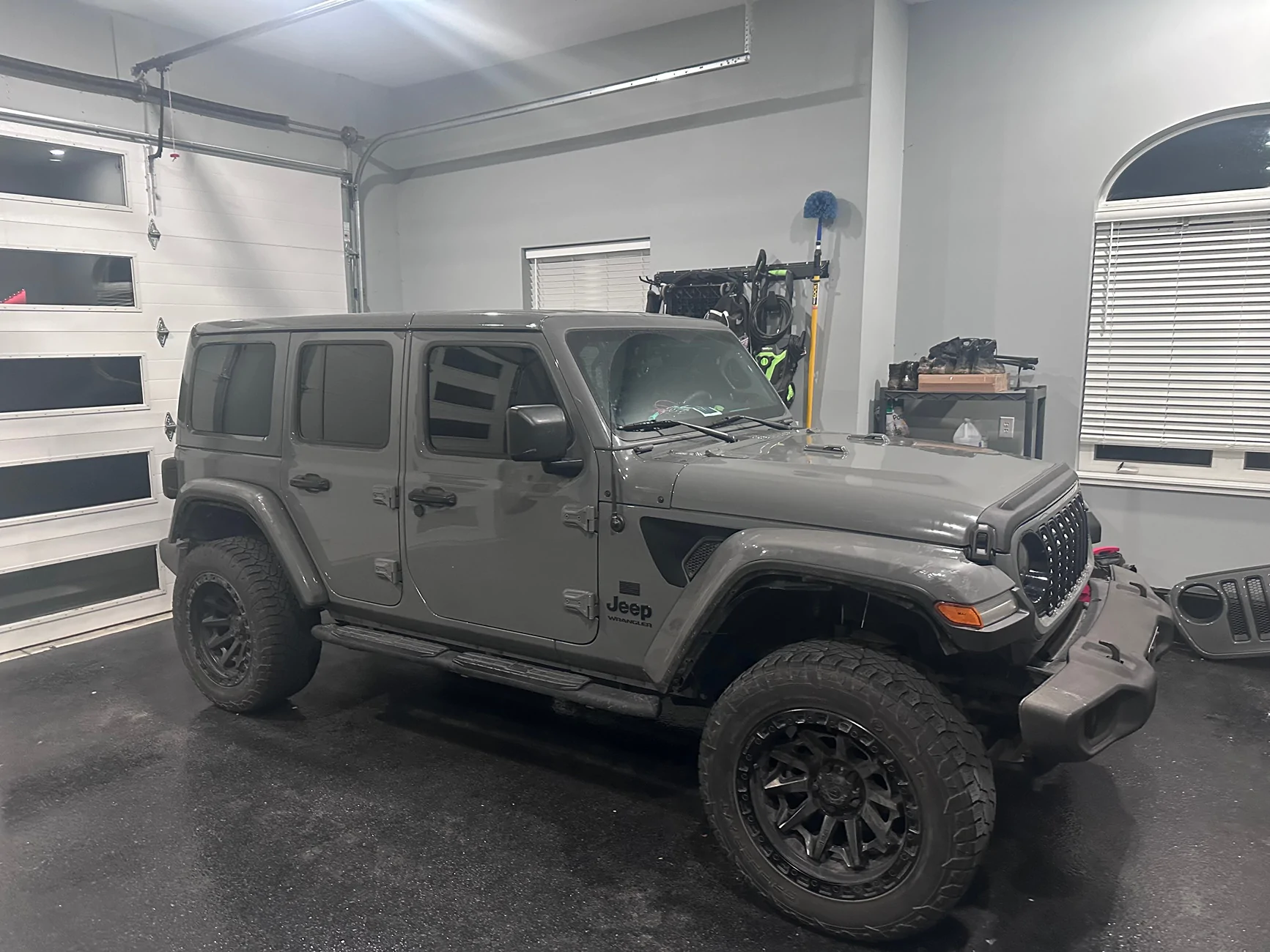

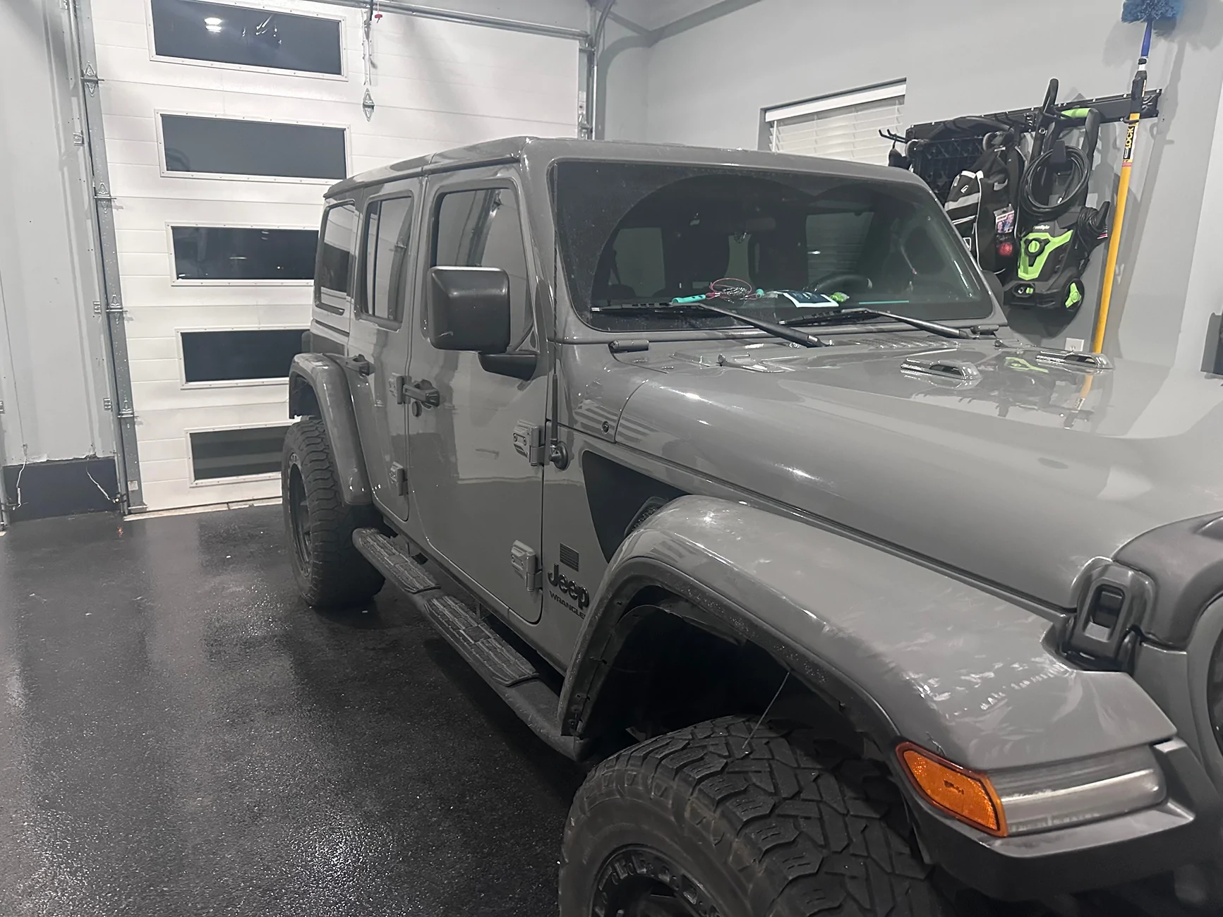

Thanks everyone!!! Okay, sooooooo update: I happen to find someone selling high rise stock liners on fb market place.. so I got those. I have not put them on yet.. bc well, mom duties come first LOL, but here are some progress pics. I color matched the cowl and some windshield spray bumpers. they are like.... 99% matching. Also cut the middle plastic area between the bumper and fender flares. I also got a OEM 2025 (or 26) grill off fb market place for $100 that i got color matched when I got the hard top done.
I REALLY need advice on how to get rid of PPF residue and the last piece of PPF. I used a heat gun when removing and I clearly didnt do it right. I've tried automotive goo off, alcohol, wd40, heat gun, soap, coconut oil LOL.. idk more things but I can't even remember.

Your Jeep looks great, but I’m most jealous of your clean garage.

Thanks! My husband will get mad at me if I don't clean up after myself. So there's that ahahahah :CWL:

Good looking Jeep! Also envious of the garage. Every time I deploy somewhere, the stuff in the garage multiplies. :facepalm:
