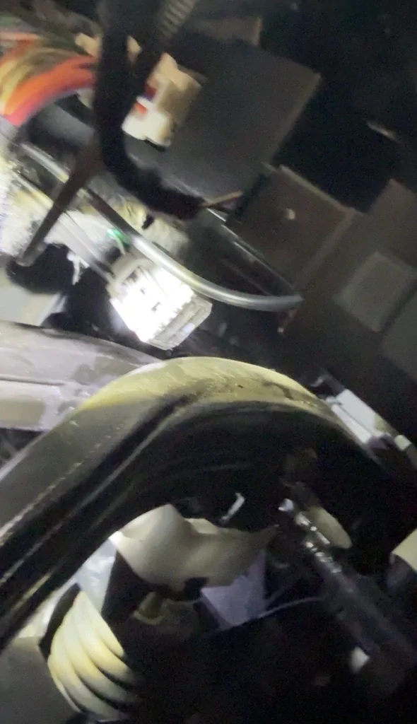

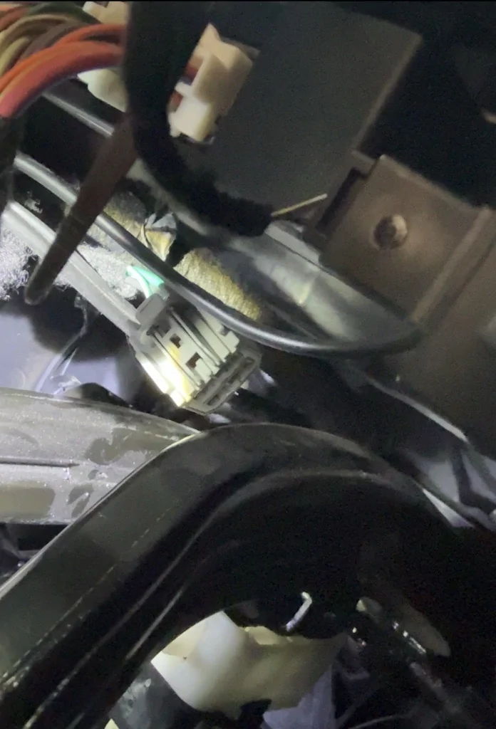

Hey all, need some help here. I have a manual transmission JL. This gray connector up under the drivers side footwell, to the left of the clutch pedal is unplugged. This is the only photos i have. Not exactly sure how many wires, how many pins on the connector, or what module it is suppose to go to. Hopefully you can help. Is tyis typically unplugged on MTs?

That is the plug for the Mopar brake controller. I have one installed on my manual transmission JLU.
