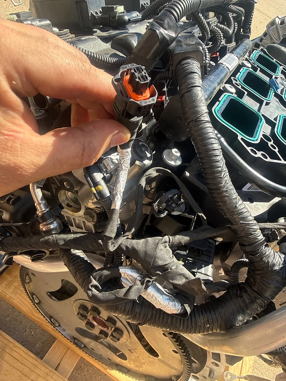

In the middle of replacing my motor. Had to swap the old engine harness to the new one got everything connected except for this one F****** connector. Back side of the motor on the harness. Connector pa66-gf30

should be knock sensor 1 and 2 and oil presser to the rear of the motor
chrome-extension://efaidnbmnnnibpcajpcglclefindmkaj/https://www.jlwranglerforums.com/JL-Wiring-Diagrams/ENTIRE-VEHICLE-CONNECTOR-MAP.pdf
