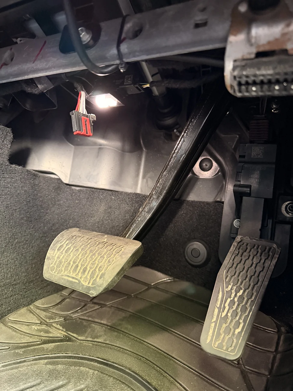

New to the jeep. Just picked up a used 2022 JL Rubicon and loving it.
While cleaning the mats today found this wire hanging loose in the front under the dash- Drivers side. Any help would be appreciated to identify it and put it back in its normal place if needed

Look above that silver metal bar. There is usually a couple of harnesses that click in. Sometimes get used for tuning purposes. Previous owner may have taken it back out and forgot to plug the harness back in.

The red thing on the connector looks like a cap. That would indicate that it is an unused connector.

ditto. it actually looks like an oem connector so maybe something that is not used in India perhaps...my first thought was maybe it was a trailer brake connector but probably not.
