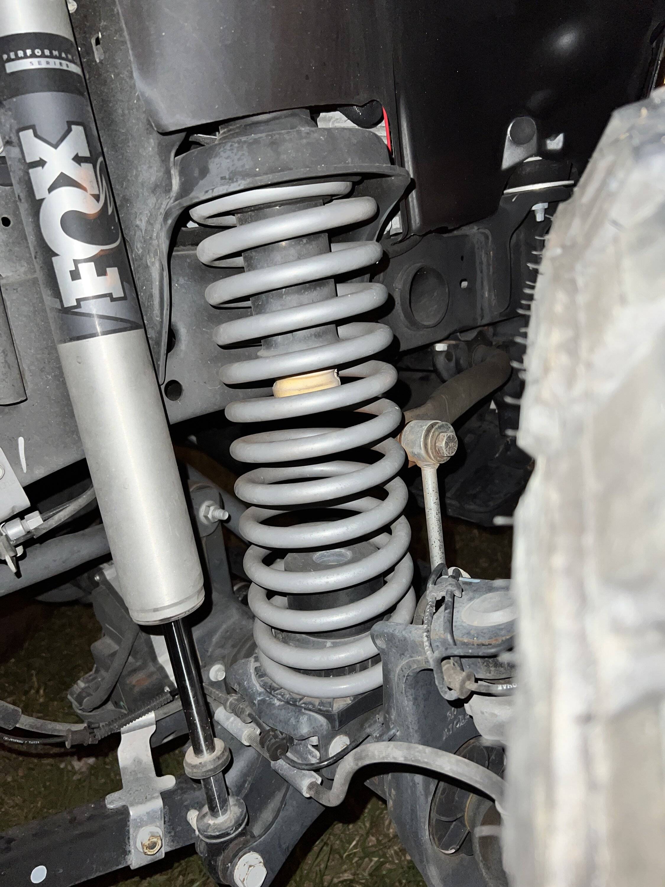

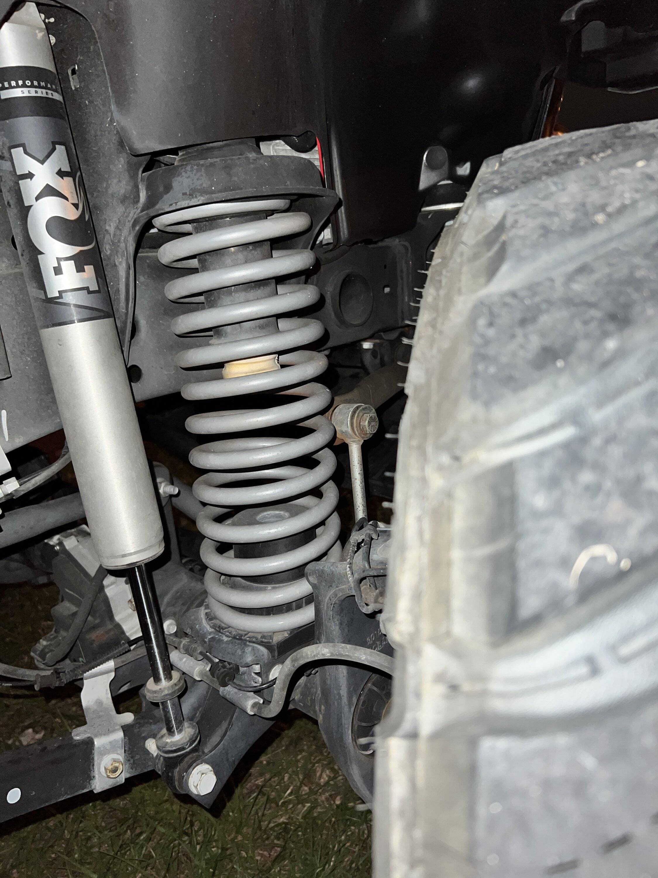

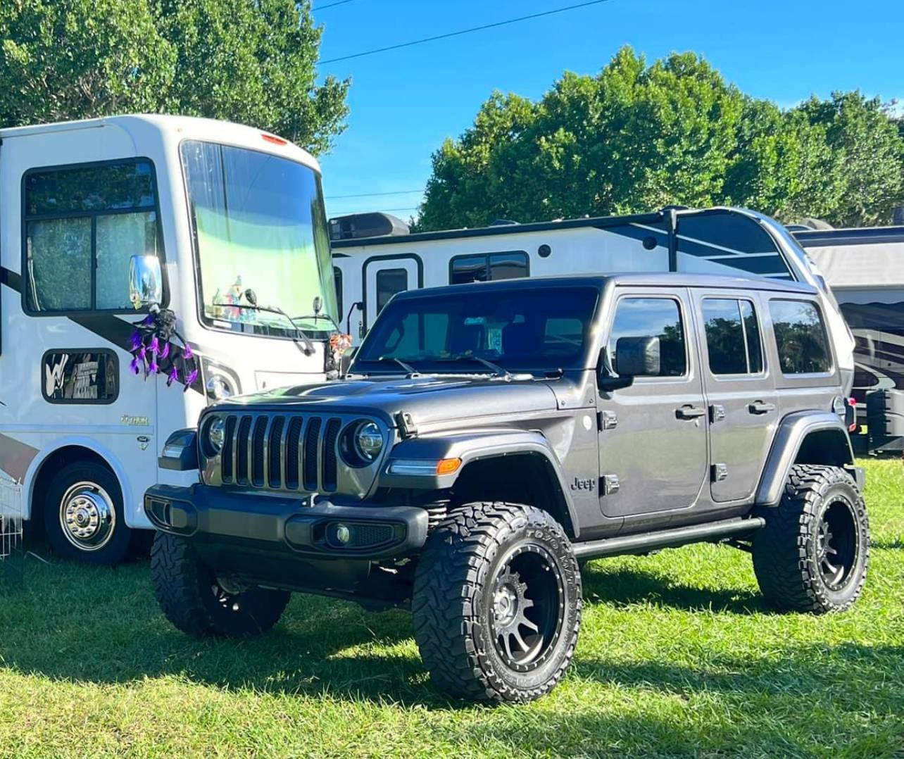

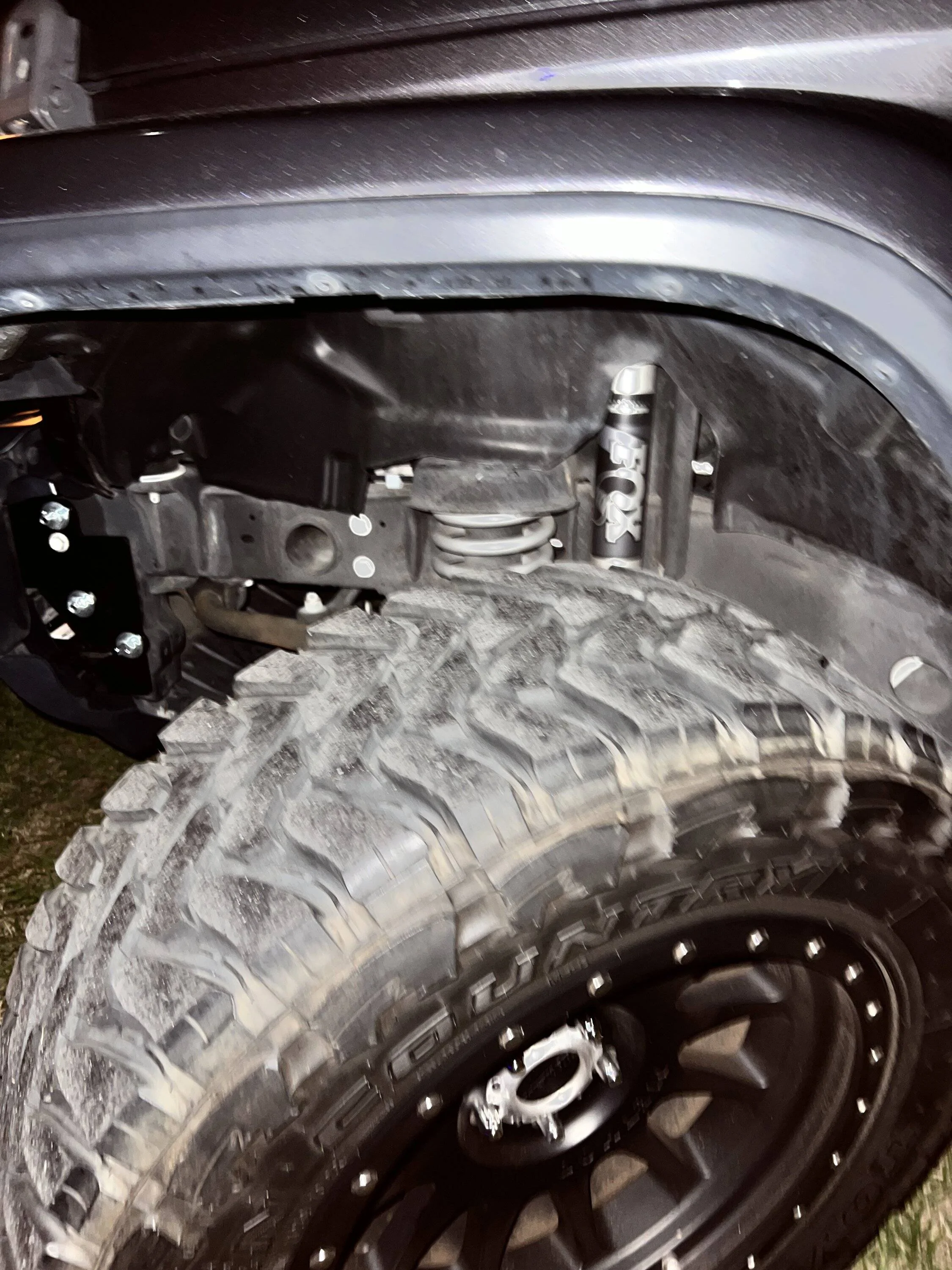

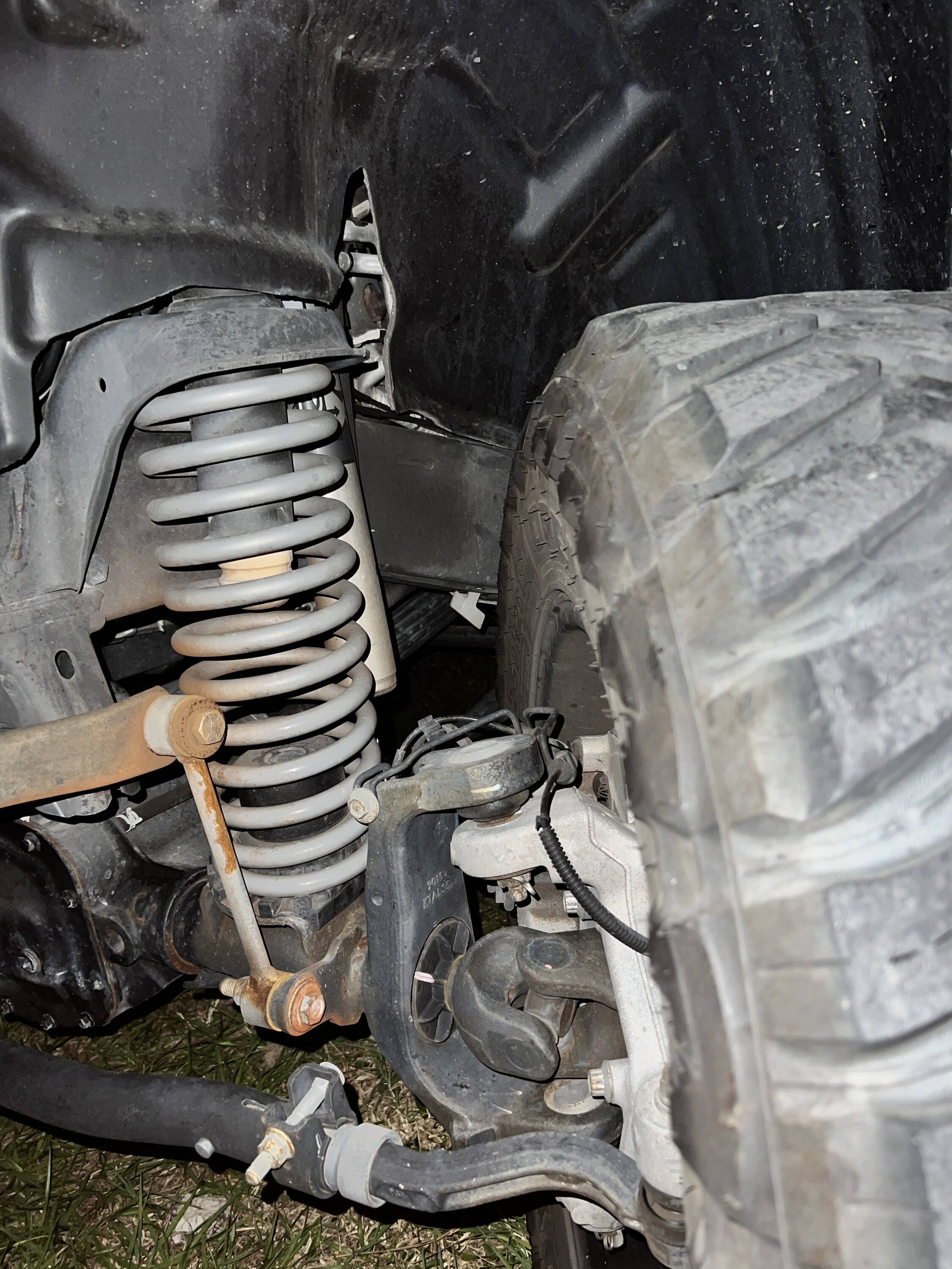

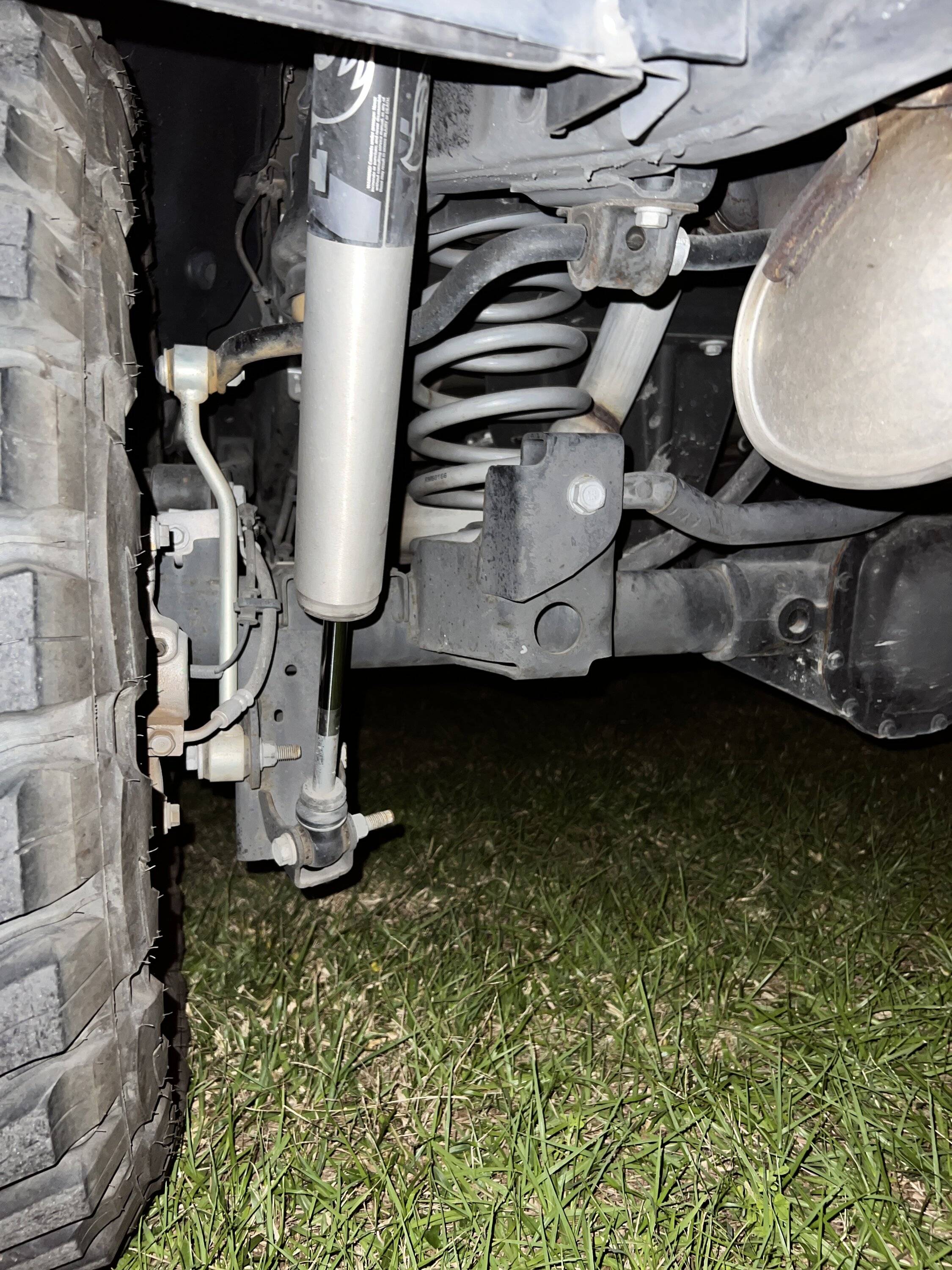

My son says 6” I say 4” maybe 2”
35 x 12.5 on 20’s
Jeep Wrangler JL Help confirming my lift??? IMG_8034
Jeep Wrangler JL Help confirming my lift??? IMG_7973

The 35 x 12.5 tires on 20" wheels are a solid choice and definitely add some height. But as for the lift it's a bit tricky to eye the exact measurement without seeing it in person or knowing the specific modifications done. From the stance and the clearance around the tires I’d lean more towards a 4-inch lift. It's not as towering as a 6-inch would be and certainly more than a 2-inch

I bought it as I enjoyed the ride, look and feel. But have no info on the lift or upgrades outside the Tazer mini and thought about going to the Orlando 4wheel parts and see if they can help.

Post some shots of the suspension. I’d guess 2.5.

Hello. It’s possibly the Mopar 2”.

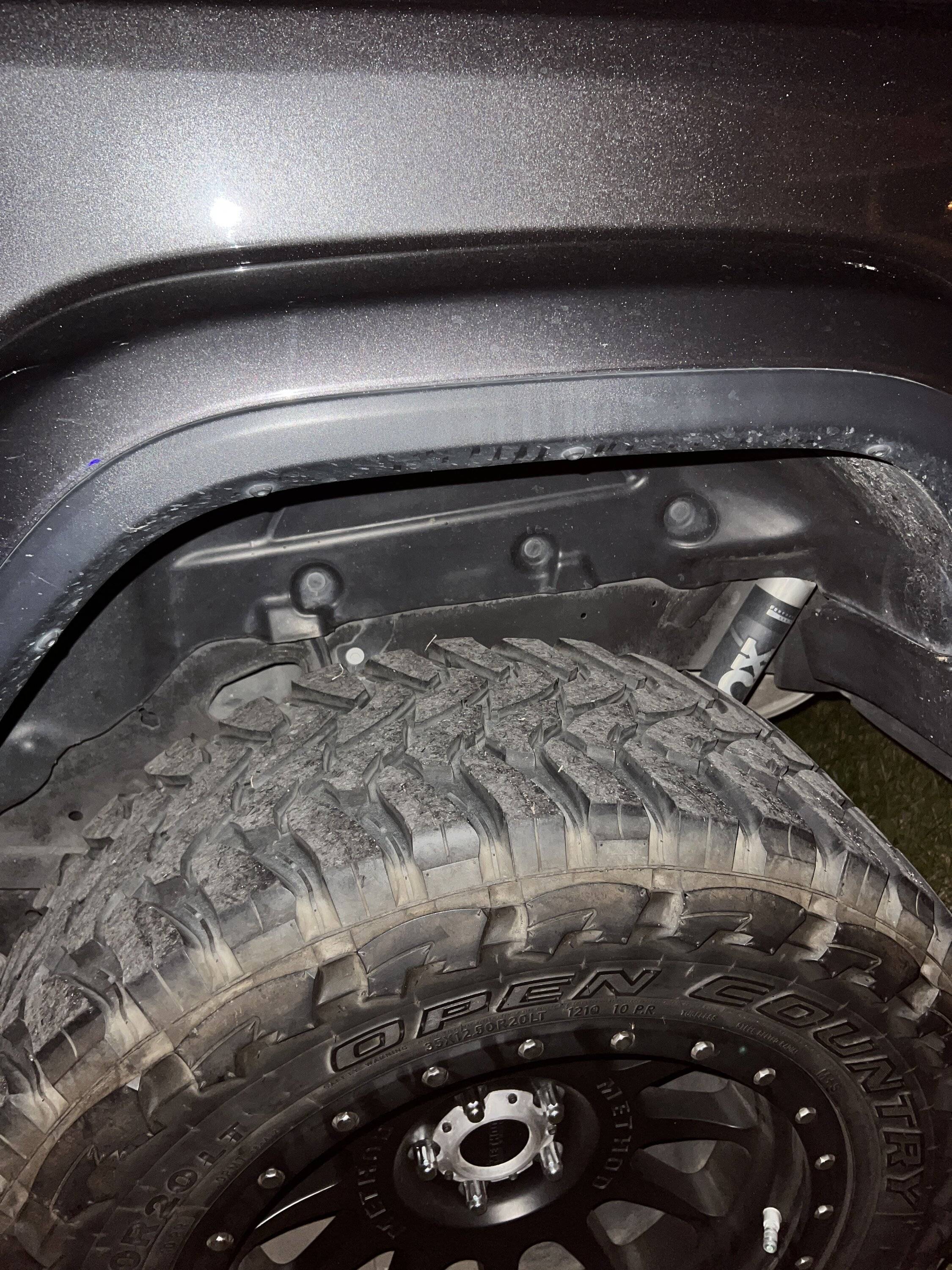

I also have 35 Toyo Open Country as you. The stance looks very similar. I have the mopar 2” lift on my ‘20 Sahara
Jeep Wrangler JL Help confirming my lift??? 37596604-D54B-4CD5-B049-16E39D6CD0C1

He has Fox 2.0s not the 2.5s from the Mopar kit. Several other differences as well, but likely similar net height.

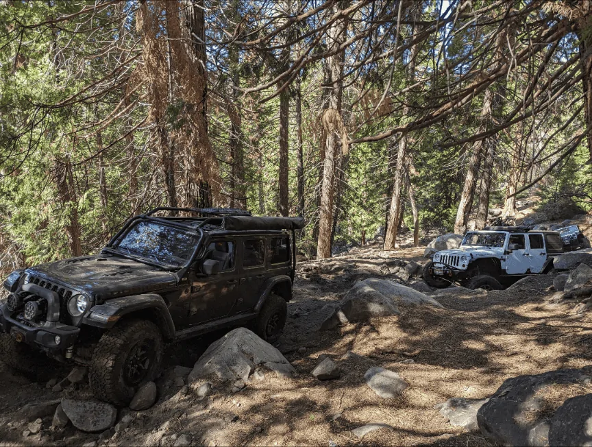

I'd guess the lift is 2.5 - 3.5, but with no extra weight it netted more. Also you need to consider most advertised lift heights are based on Rubicon height so a 3.5 inch lift on a Sport or Sahara is really much closer to 5.
I just had a MC 3.5 GC installed. I have custom bumpers, but they're aluminum so my weight is pretty close to stock. Right now I'm netting 5.4" from my 3.5.
I also have 35" tires right now. I have more clearance the under the fenders than you, but my fenders are also higher being a Rubi. If you had Rubi fenders I bet it would look very similar to mine.

It definitely sits taller than my Mopar lift which nets 2.5-3". Fox 2.0 vs Mopar's Fox 2.5. Gray springs has me thinking Rubicon Express. ? 4"+ is my guess.

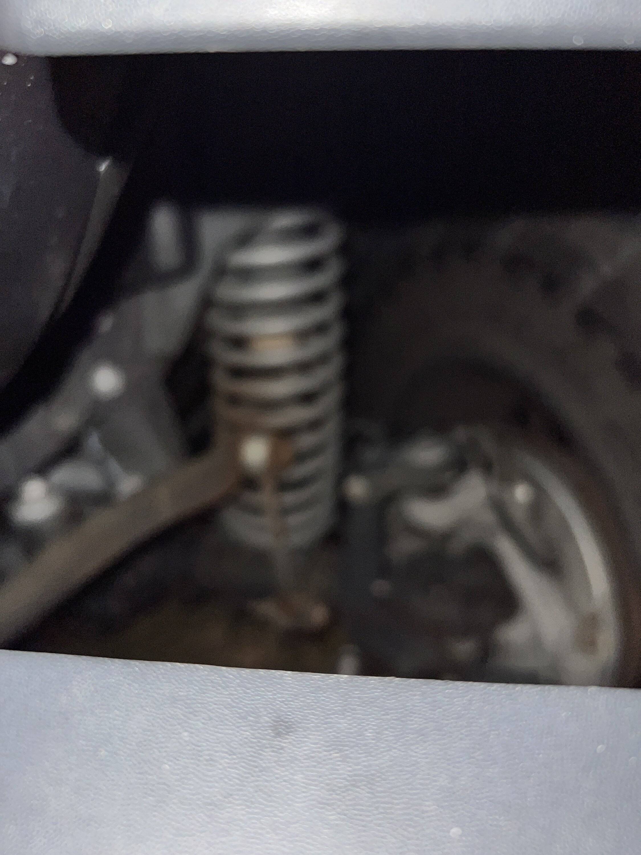

The Rubicon Express basic 3.5 had a rear track bar bracket, it’s not on his rear axle picture.
