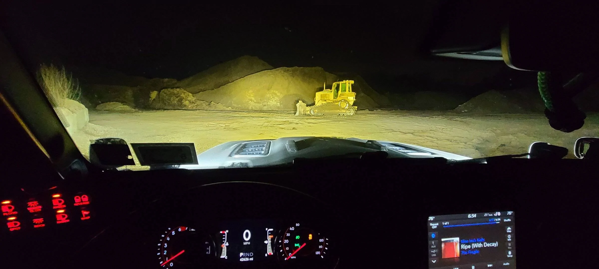

I have to a agree with a flood pattern creating too much glare off the hood. I have 2 pairs of Squadron Pros on my a-pillars. The inner pair is a dedicated spot pattern that I aimed straight ahead. The outer pair are floods and are aimed 45° outward and slightly down, to act as both a ditch and flank lighting. I have each pair on its own independent switch. I also have 2 pairs of amber LP4 Pros with combo lenses on the front bumper. Here's a pic from the drivers seat, which shows the amount of hood glare with the spots. It's not enough to be an issue, but a flood pattern would definitely be self blinding.
Jeep Wrangler JL Help Baja Designs setup 20210131_185424

Hi Mike:
Thank you very much for your inputs and the pic, very nice way to see the effect, I will consider this before make nothing.
Have a great day.
