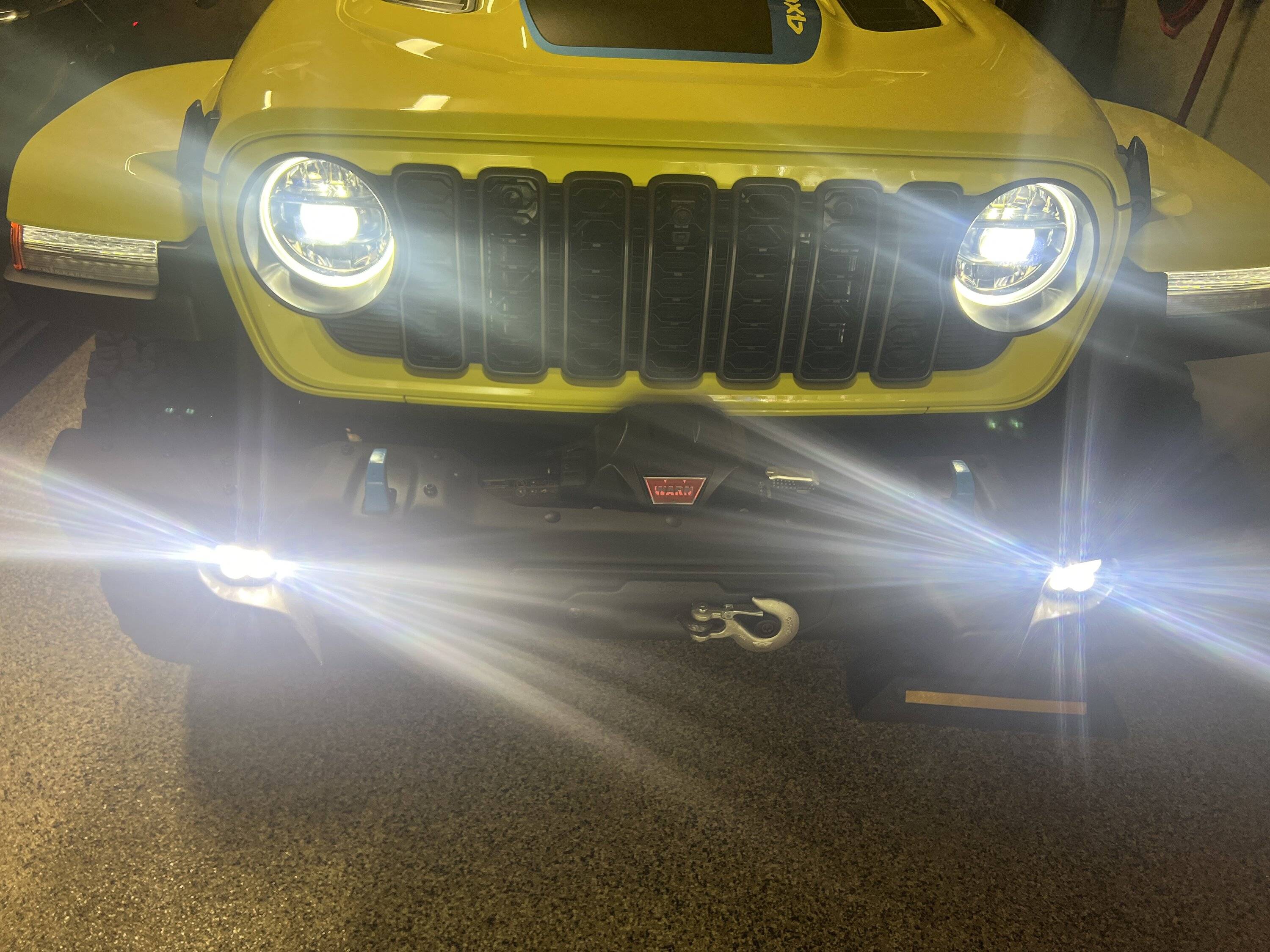

Check out the backup light that fits into the trailer hitch if you have one. 3,000 lumens to brighten up your day. LED for the front bumper will add another 8,000 lumens. You can always get aJ Scan to make your Jeep compatible with the LEDS. All are plug-n-play
