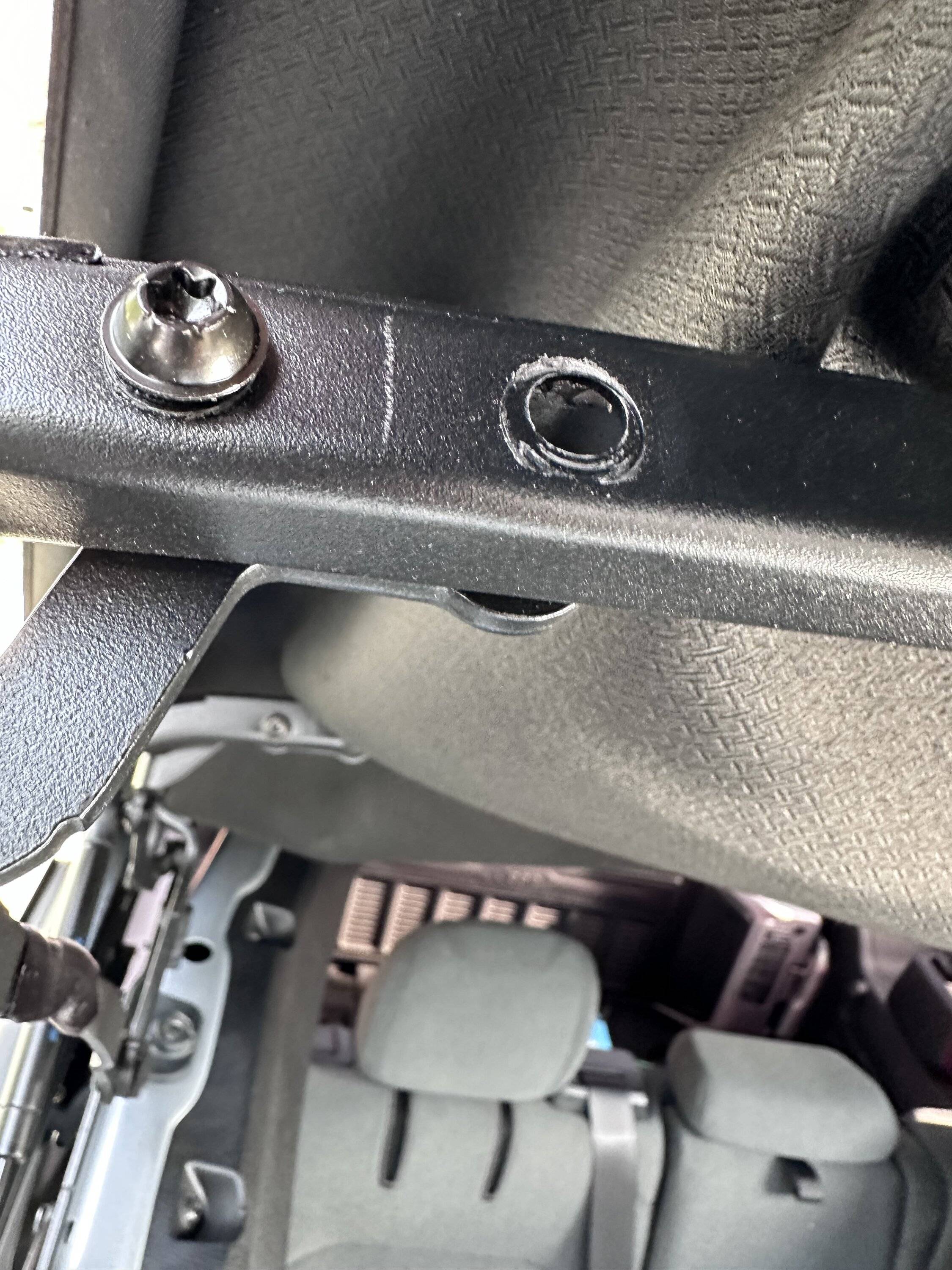

Please help before I lose my mind from the sound of constant rattling. The attached pics are of my 2024 factory soft top. You can see that one side of the bow shaped spine pieces (the thing that runs from drivers to passengers side and gives the canvas top its shape) touches another metal part of the soft top hardware when the top is closed, which rubs and rattles with every bump in the road. Is there a way to adjust the bow shaped spine piece?

Fwiw, on the opposite side of the car, that same bow shaped spine piece has an inch or so of clearance. So, I’m thinking it has too much clearance while the other side has none.

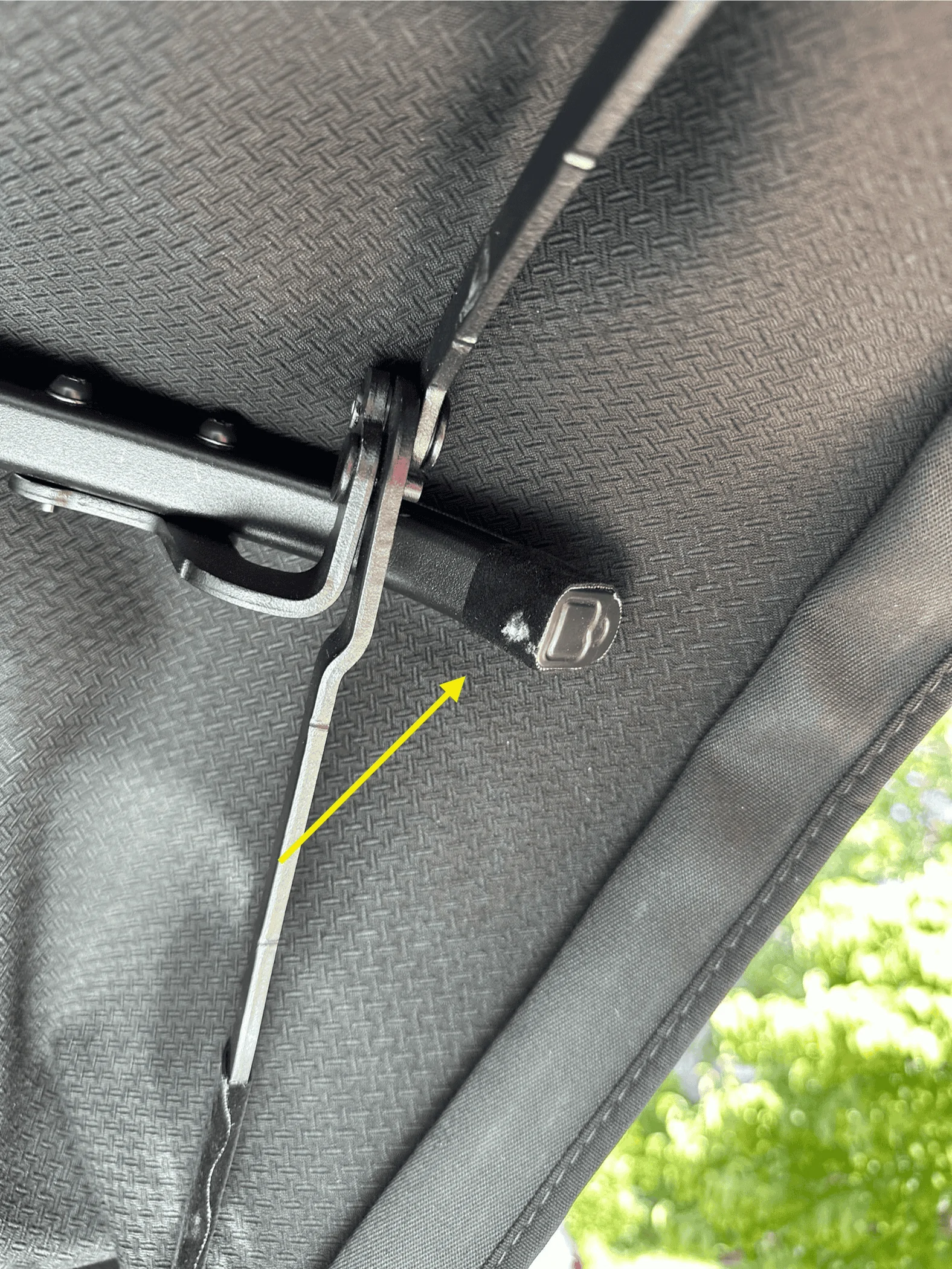

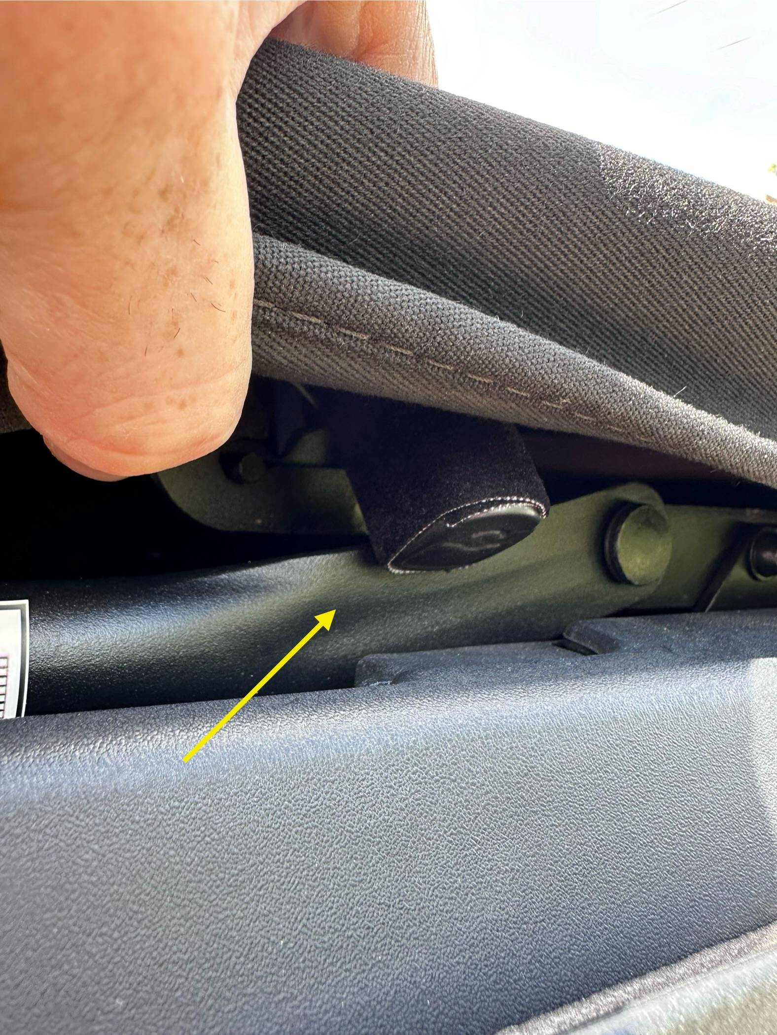

I've used this adhesive fabric, cut to size, to manage the effects of similar concerns with the soft top on my JLU. In my case, a portion of the folding framework was rubbing against the fabric when the top was lowered. It was only a matter of time until a perforation occurred.

Yeah, it flexes back and forth. But its relaxed position is obviously off center. And that’s why it rattles so much when I’m driving. I’m at less than 3k miles, and you can already see a decent amount of wear on the spot where it’s rubbing. No way that’s supposed to happen.

No luck. Tried what you suggested, but the holes aren’t oblong, so there’s no room for adjustment there.

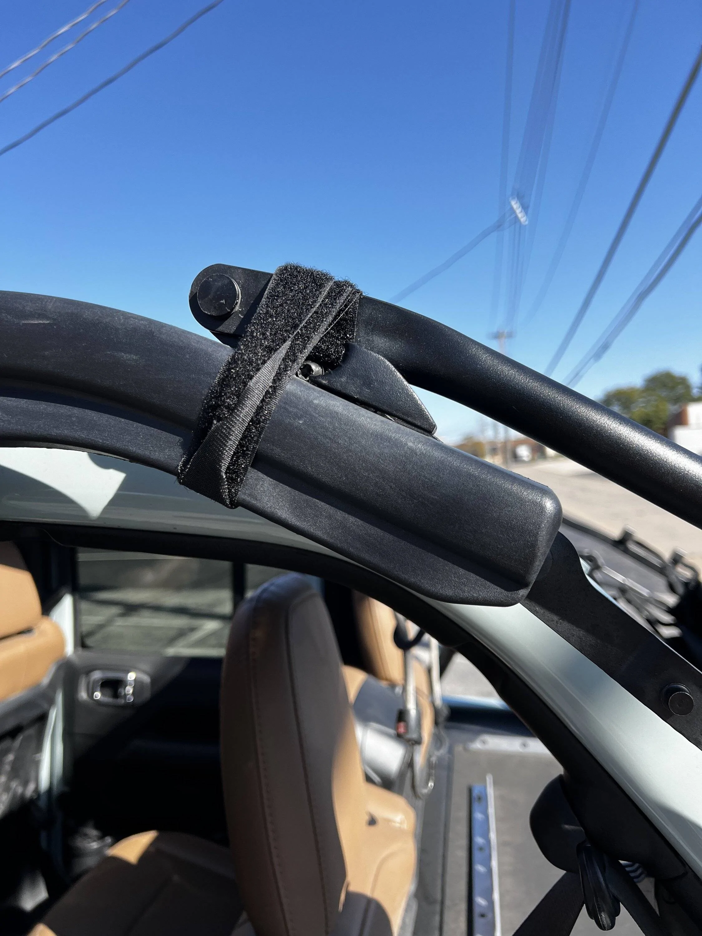

So my soft top was rattle free until I drove info my garage with the front flip back ($300 mistake). Now the one side rattles. This Velcro has stopped it (although I wish I didn’t have to use it). Any ideas why this would now be rattling? Don’t mean to hijack; I know this is different than your issue. Thanks.
