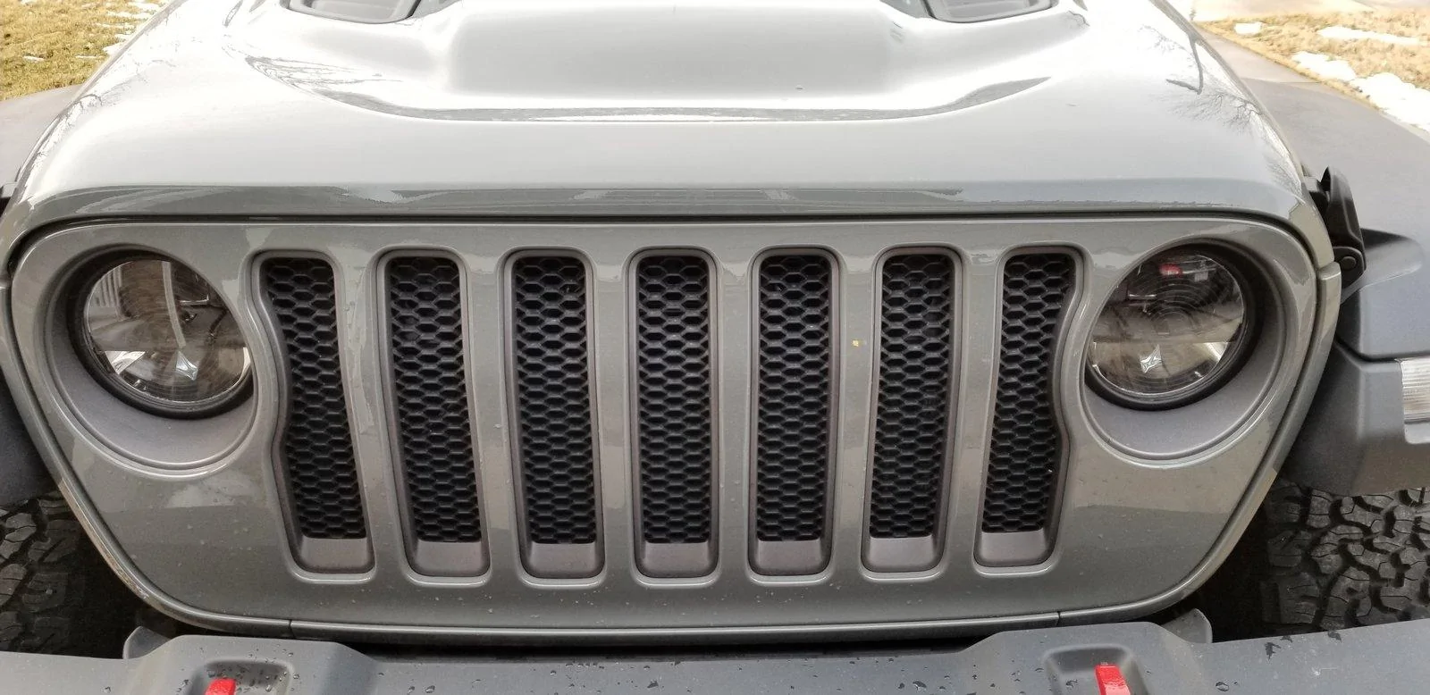

After my first snow storm I have decided that I need heated headlights. the factory mopar LEDs do not put out enough (any?)
heat to melt the snow, and the grill around the headlight just lets it fill up.

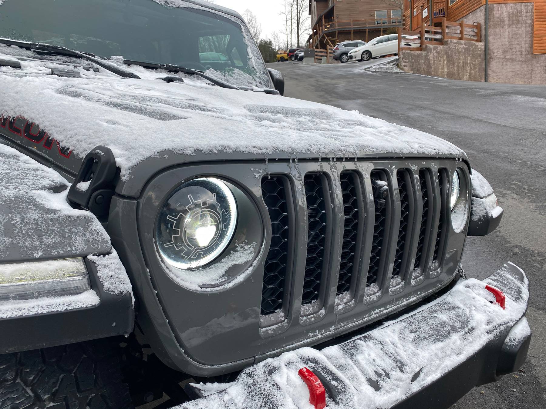

Any updates with this? In a recent snowstorm at night my lights got completely covered, super annoying!
I love my factory LEDs and don't want to swap out for another set of LEDs, does anyone know of anything else we can put on the headlights to heat it up?? I was hoping someone made a cover with wire elements running through them that could be placed over top the existing lights

I have the Quadratec ones (made by JW Speakers). I've only been in one bad snowstorm and they worked great. When I got out, my off road lights had an inch of snow on them and the headlights were clear. Highly recommend them. My Jeep didn't come with LED's and the new lights would flash off for a second when I put my high beams on and off. I had to change it over to LED with my tazer and then it worked great.
