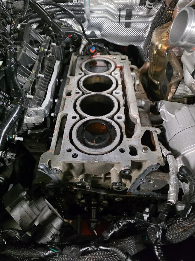

Saw this old thread come up-
Just wanted to comment and say that my 2024 Rubicon 4xe had a leaking head gasket at 14,000 miles.
Oil was streaming down the block. Took 31 days to get the jeep fixed. This is the second attempt to fix the leak, first one was the timing cover which was resealed but the leak continued.
Hope this fixes it... but I do not care that much because I am pursuing potential lemon law.

Oil usually doesn’t leak in the event of a head gasket failure.
Where was it leaking from?
It was streaming out the driver side front of the engine. Previously misdiagnosed as a timing leak.
I'm not so sure about keeping it after all these issues so I might try to trade it out for a 3.6.
