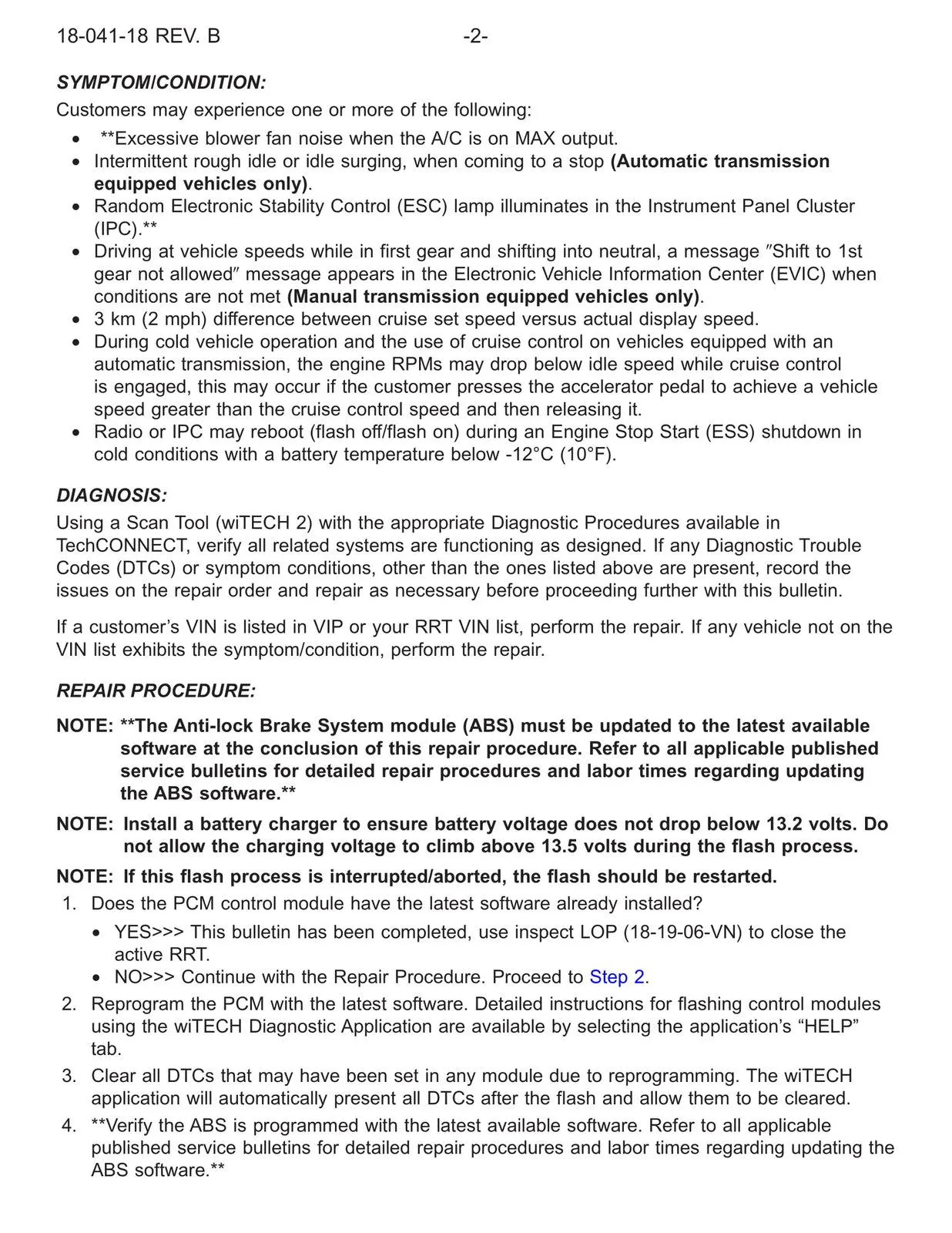

My 2018 JL loses 3 to 5 minutes quickly after any clock reset. Also... my entire radio unit will reset without warning occasionally, making a very loud "POP!" through the speaker system with the radio unit blacking out and then coming back on as if it had never been programmed before with 12:00 as the time. I think this unit in this new JL must be defective or there is some other sort of electrical issue with this new JL. Having it looked at by Jeep Service next week... hopefully I'm not returning there for the same issue after that!
TSB 18 041 18 rev.b may address your problem.Under SYMPTOM/CONDITION radio or IPC may reboot
Jeep Wrangler JL Has anyone had problems with the clock not keeping time ? JL_TSB_18_041_18b-2
