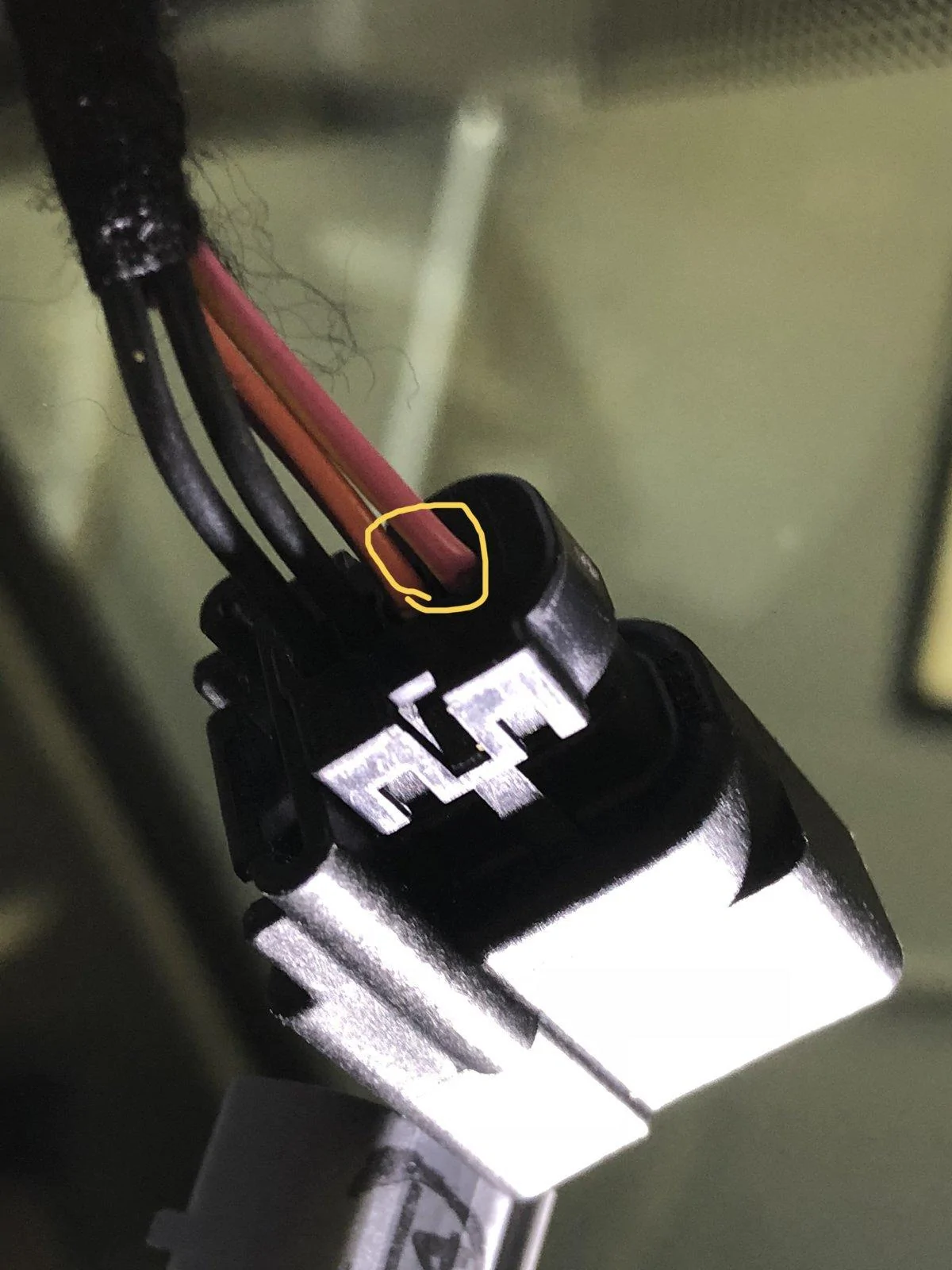

2020 JLUR with same setup as you and I following the below and was able to set mine up.
https://www.jlwranglerforums.com/forum/threads/hard-wire-radar-detector.11899/page-2
As goin2drt said:
You jam in the end of the cord right where I circled. Right up against the pink wire and push down.in. Then do the same with the black.
Jeep Wrangler JL Hardwire radar detector in 2020 d7ab8fb6-72a5-47d1-8767-16c72c7ac3c9-jpeg
I also further confirmed I was using the right wire by confirming with a voltage detector that I had the one showing voltage only while vehicle ignition on doing the same thing show here:
Skip Video to 10:50 mark
