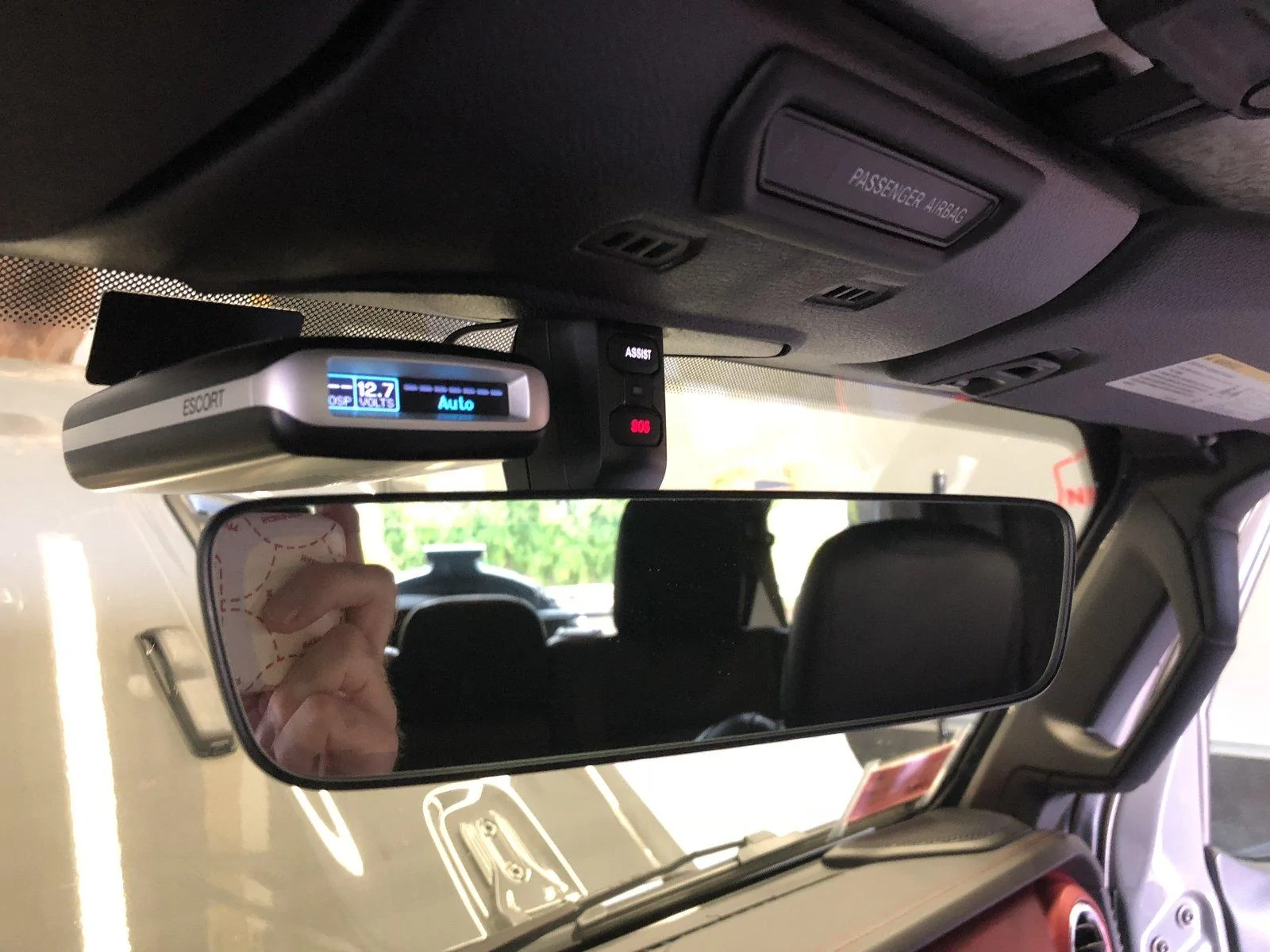

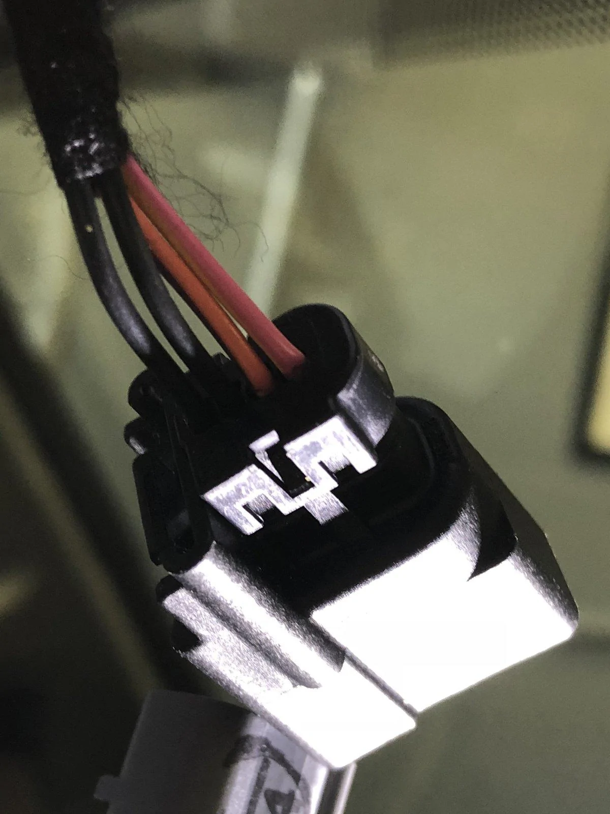

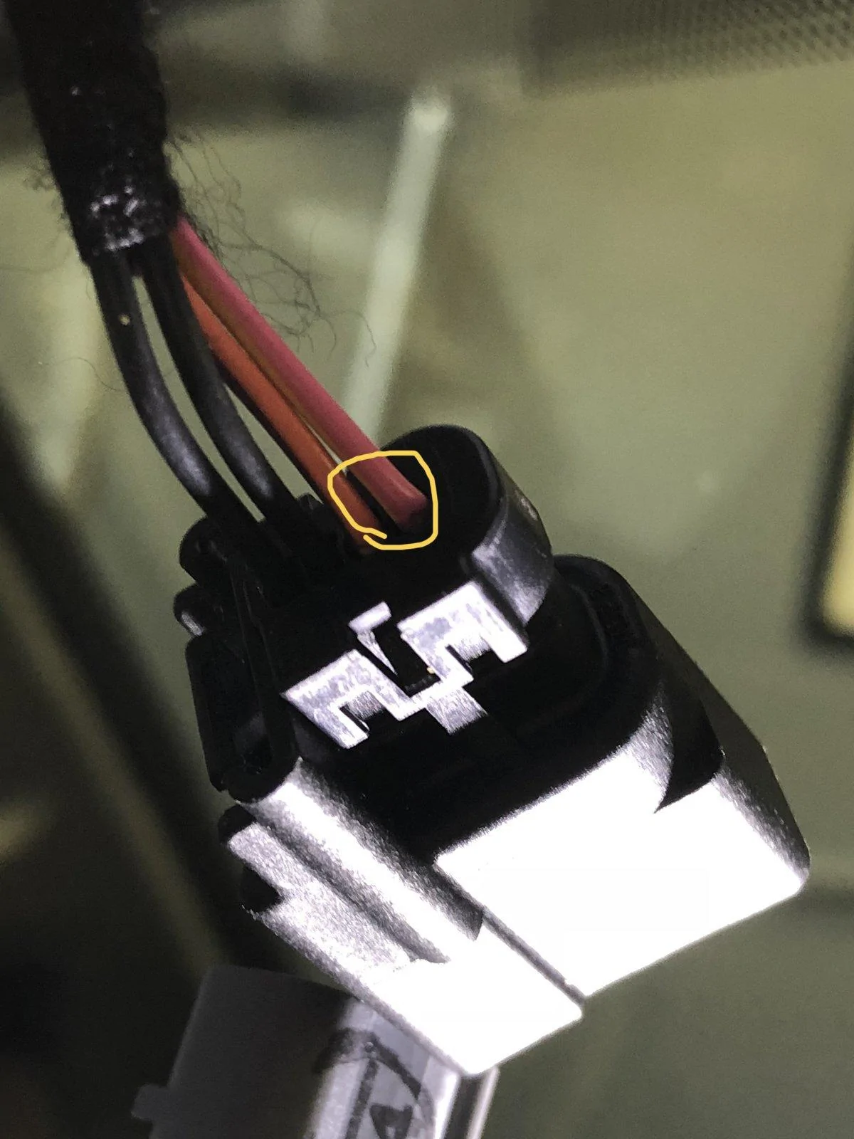

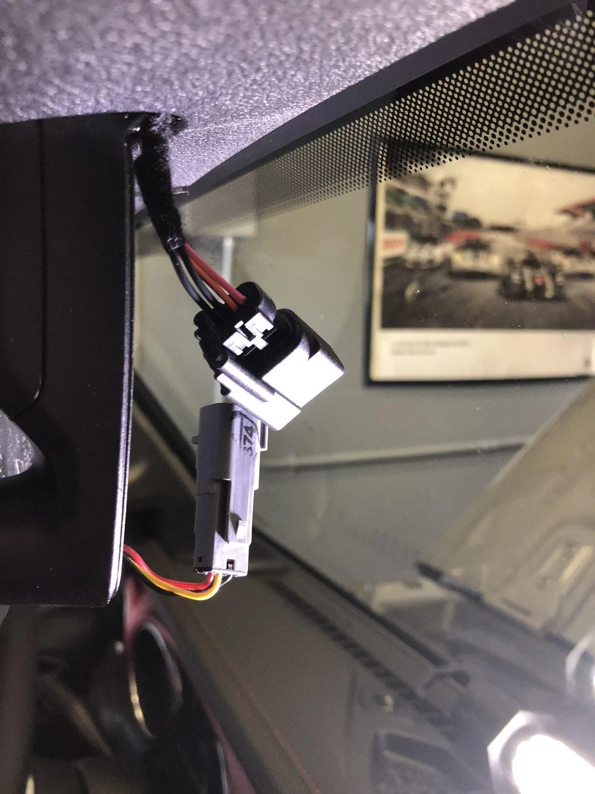

I always hard wire a radar detector in all my cars so the Wrangler was no different. Vehicle is a JLUR in case that matters as I tapped into wires at mirror.
Parts needed
Invisicord - http://www.invisicord.com/order.html
Windshield mount. Make sure you get the one right for your detector - https://www.ebay.com/itm/NEW-Permanent-Windshield-Mount-for-Escort-and-Beltronic-Radar-Detectors-EP-R/123196916615?hash=item1caf1bc387:g:z6cAAOSwyQtVlyeK&_sacat=0&_nkw=escort+windshield+mount&_from=R40&rt=nc&_trksid=m570.l1313
Right underneath the stem of the mirror there is a place to put in a screwdriver and pop the back plastic piece off. Pink wire top plug as seen in pics is the switched hot and black is negative. Plug in the invisicord into the plug. Replace the back plastic piece and run the wire out up the top opening
Done. Easy as that.
How do you like the Escort? And would you recommend it I appreciate your opinion thank you

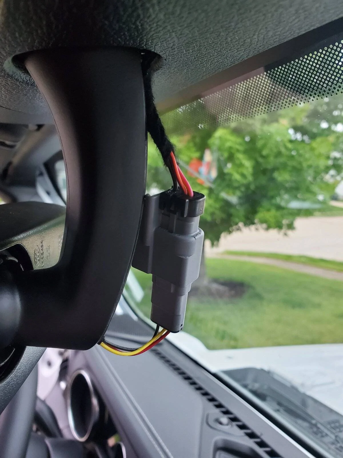

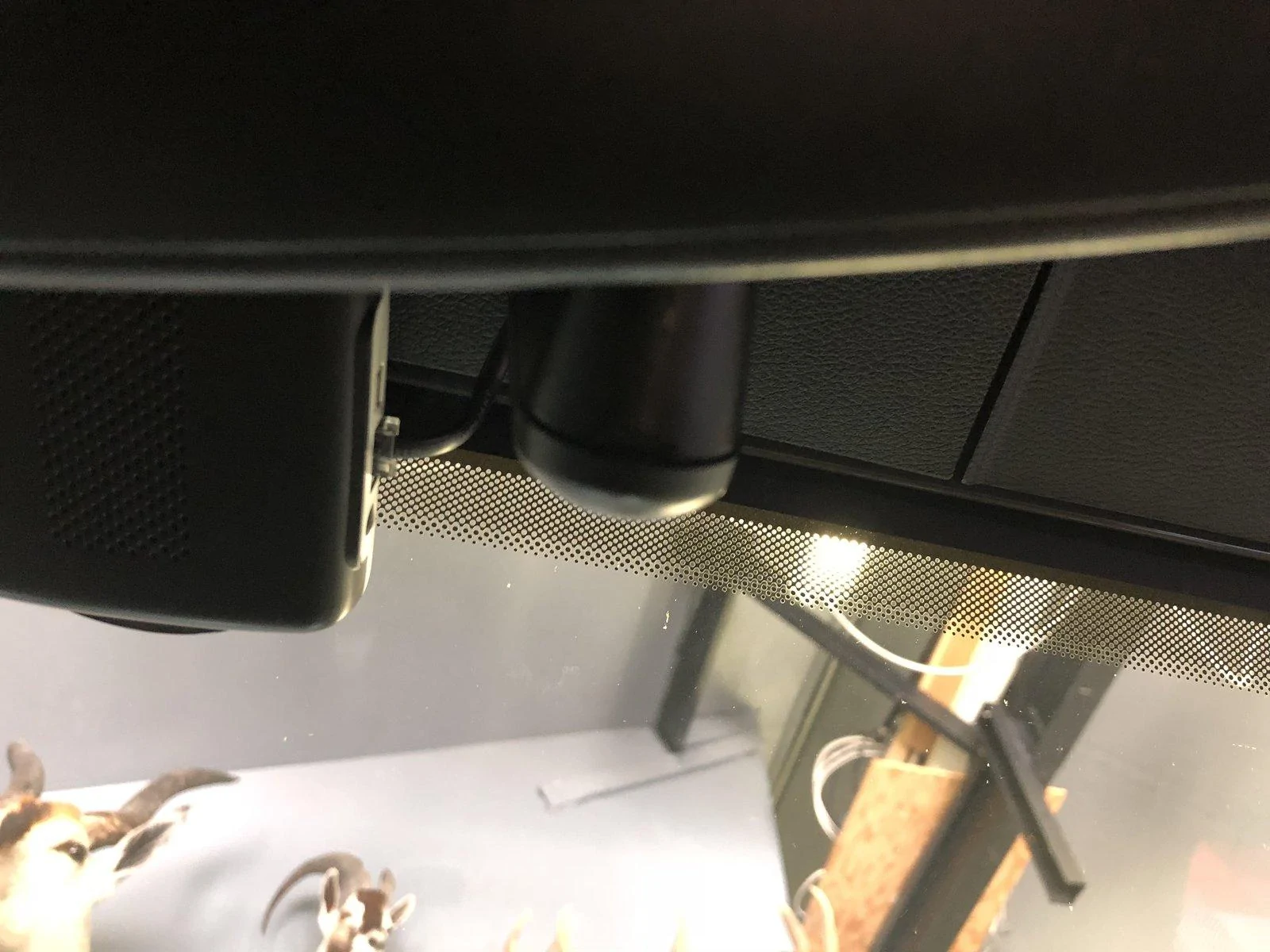

I realize I'm reviving an old post, but couldn't find anything newer. I can't get power to my radar detector and I've tried keeping the ground inserted in the black plug and the red in all the other spots on the top AND bottom of this wiring.
What am I doing wrong? I've used the largest prongs and been able to push them in fully. My wiring does look different than the OP's.

I got it figured out. What worked is using the bottom spots on the adapter and using the taps to connect black to black and red to red and pushing the taps in super hard.
Putting the rearview mirror housing back on is a hassle too.
