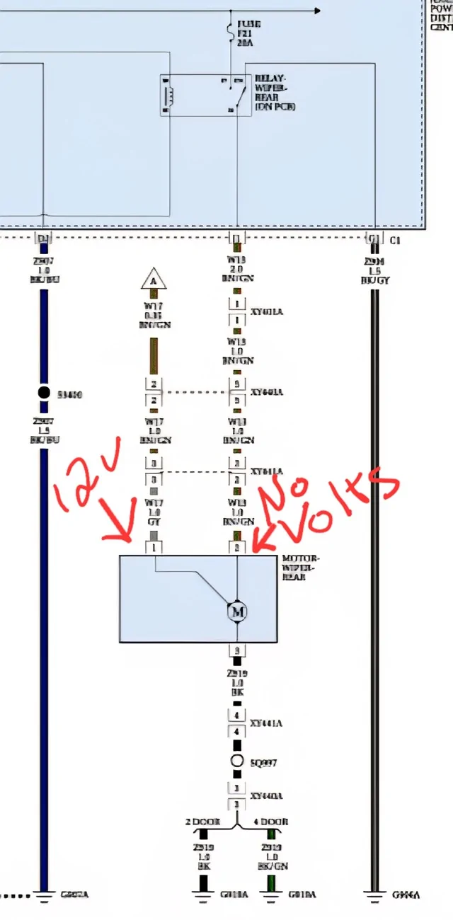

Got a 22 Sport JLU came factory as a soft top. Picked up a hardtop off market place off a 20 JLU. Installed the conversion kit, what a PITA. Had dealer add sales codes. But cannot get the rear wiper to work. The wiper switch is showing commands on my scan tool, so the new steering wheel stock is working. Bench tested the wiper motor and it is working. Double and triple checked all connections even ohms them and all are good. Before I go back to the dealer was wondering if anyone else had this issue and was an easy fix.

Hi, so you also installed a completely new wiring harness from the rear wiper all the way to the front of the washer reservoir, replaced the steering wheel ring and the rear wiper control lever, and it still doesn't work? Have you measured the continuity of the cables from the steering wheel to the rear connector?

Yep everything tested fine. I went through 3 times and checked all the connections and pins in the plugs as I read they might get pushed back. On pin 1 on the motor I'm getting 12v on pin 2 I'm only get about 800mv coming from the fuse box but fuse
Jeep Wrangler JL Hardtop Conversion Issues Screenshot_20251009_114015_Adobe Acrobat
is testing out 12v
